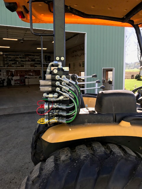

After searching for two days I could not find a kit for the 110 TLB. I am somewhat surprised. I suspect there would be a significant demand for such a kit and there doesn’t seem to be much complexity to create one, or so I think. If anyone knows of a kit available please feel free to tell about it.
What I want to accomplish is adding three remotes to operate a grader box. Two remotes to operate the top and tilt on the three point hitch and one remote to operate the scarifiers on the grader box.

Since the backhoe will be removed it seems logical to use the lines remaining on the tractor to feed the remotes. I think sourcing control valves with the same port size is also a good idea. This way there will be know concern of damage or overheating. Am I on the right track here fellows?
/ 110 TLB Adding Rear Remote Hydraulics #4
Yes,
You can use the "power beyond" that feeds/fed the backhoe to add in a new valve stack. You can configure the stack as you'd like, even adding an electric spool for a front remote if you use ones from Bucher.

Something like this maybe? :unsure:

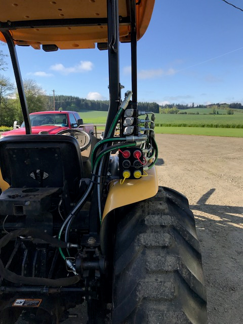

Yes something very much like this! My plan is to make a consolidated unit like the one shown in your picture but with a quick attach feature. This way it won’t be causing interference when the backhoe is used. Taking advantage of the existing quick couplers should make this feasible.
Do I see a set of hoses going to the front on this set-up?
/ 110 TLB Adding Rear Remote Hydraulics #10
It looks like it, but I do not know for sure, it is a customer's tractor from years ago. All I provided was the valve set and the couplers in a coupler mount. The customer did everything else.
