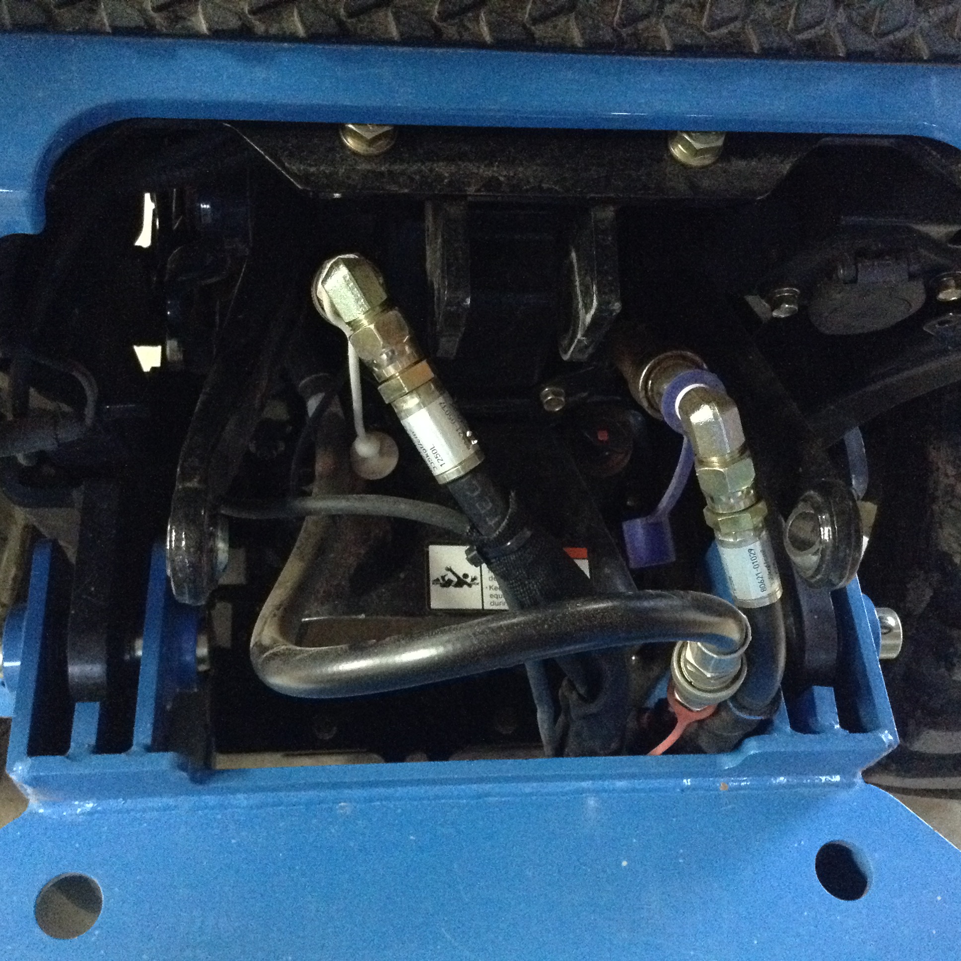

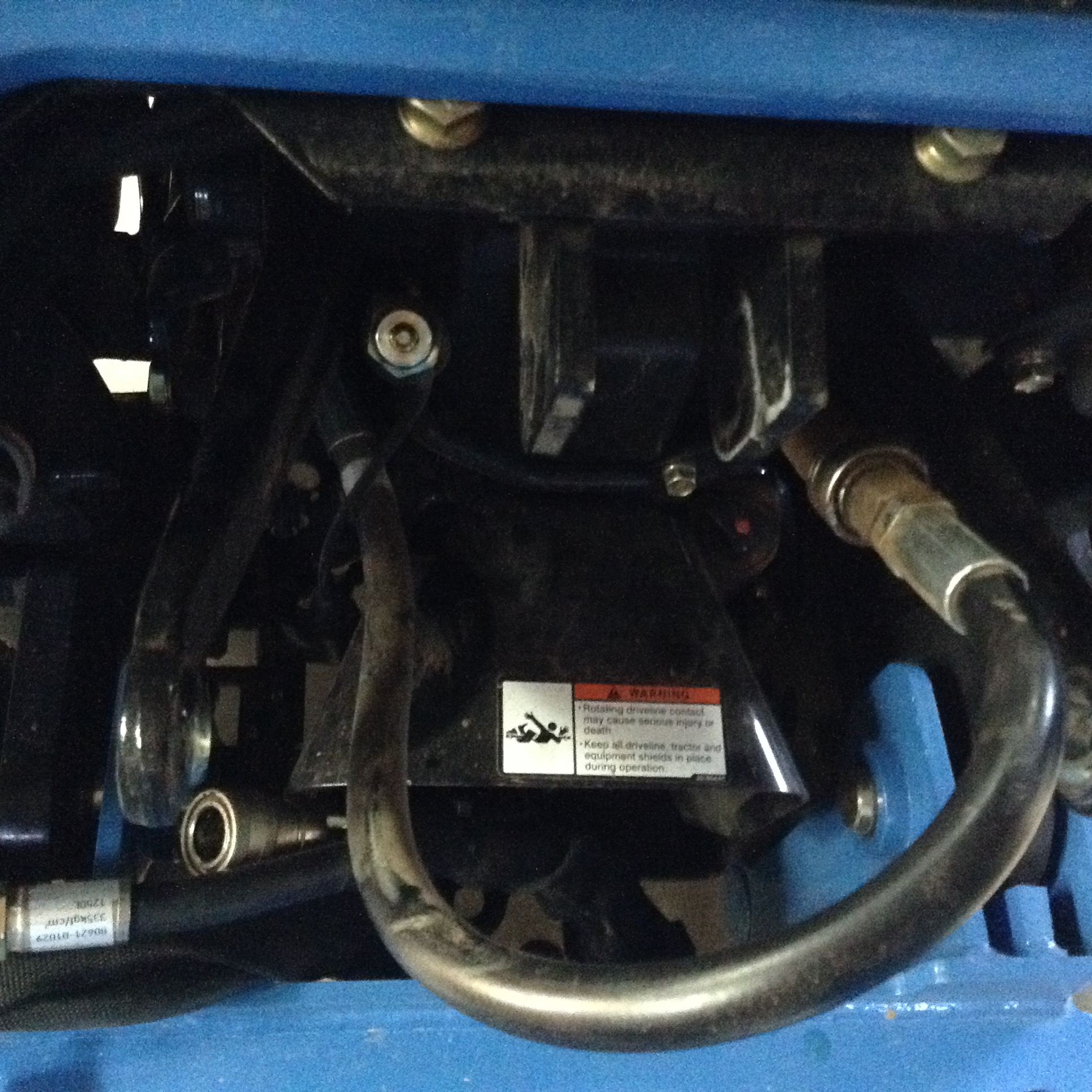

What do you do with the connections when you take the BH off?
The 'from pump' hose plugs back into the 'to hyd. housing' port. The other 'to drain (tank)', remains unattached (just a cap). Here's some pics. The first is with BH attached, the second is normal operation.
   / Top n tilt on existing remotes
#12
Then it's just like mine. So pressure from pump goes to "in" and return goes to "out" on your spool valve. Then the Hyd Housing must be what they call Power Beyond, and that goes in the BYD port. Good luck!
   / Top n tilt on existing remotes #13
And yes, the hose has to be hooked up in order for the 3 point to work, just like your set up.
   / Top n tilt on existing remotes #14
I just noticed you are in Alamogordo....small world... Big state. There's some weather heading your way...just left here, now just high winds.
   / Top n tilt on existing remotes #15
Are you going to use the spool you have or get a different one? Another question: are you going to plumb in fittings to attach the BH or are you just going to disconnect the remote valves when using the BH and hook it up as normal?
#16
Getting a 3 spool. Not going to add any more... just use what's there. Yes...super windy right now.
