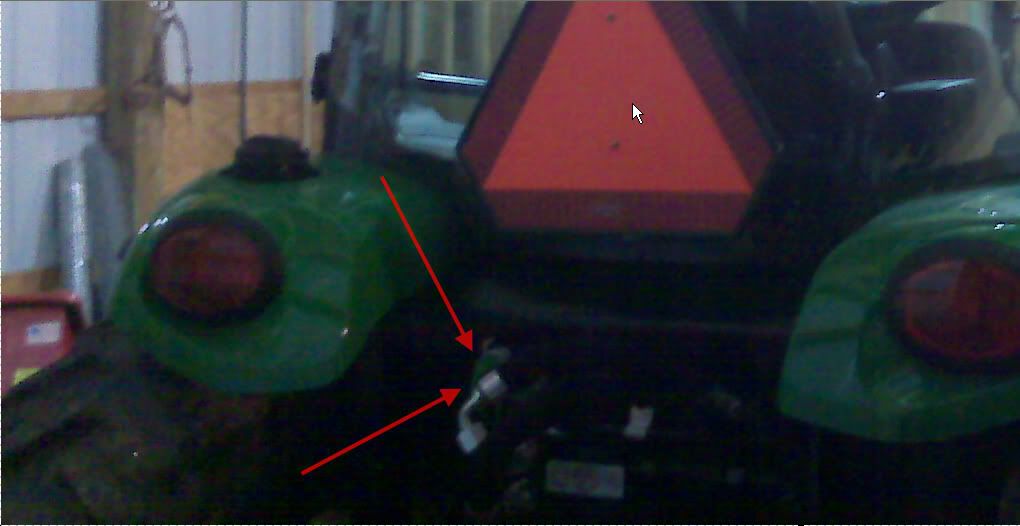

Does anyone know the measurements of the existing top link on a 4720? I am home now 200 miles away from my tractor and never measured! I want to order the CCM toplink so I have it next time I go upstate so my dealer can install it, (said no problem with minimal charge) but dont know which one to order....The website has 2 in question:
Cat 1- 18-26.5" w/ check valve- 2" Cylinder $185
Cat 1- 21-32" w/ check valve- 2" Cylinder $195
And you guys were ALL correct, I have a set of valves already in the rear to take the toplink, and will use the lever in the cab.....
