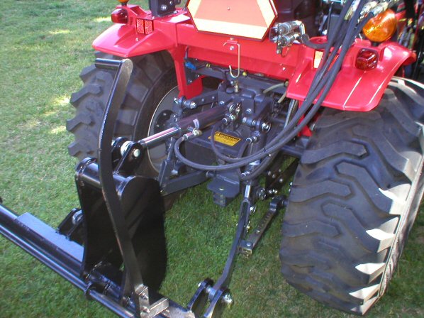

/ Top & Tilt Questions #3

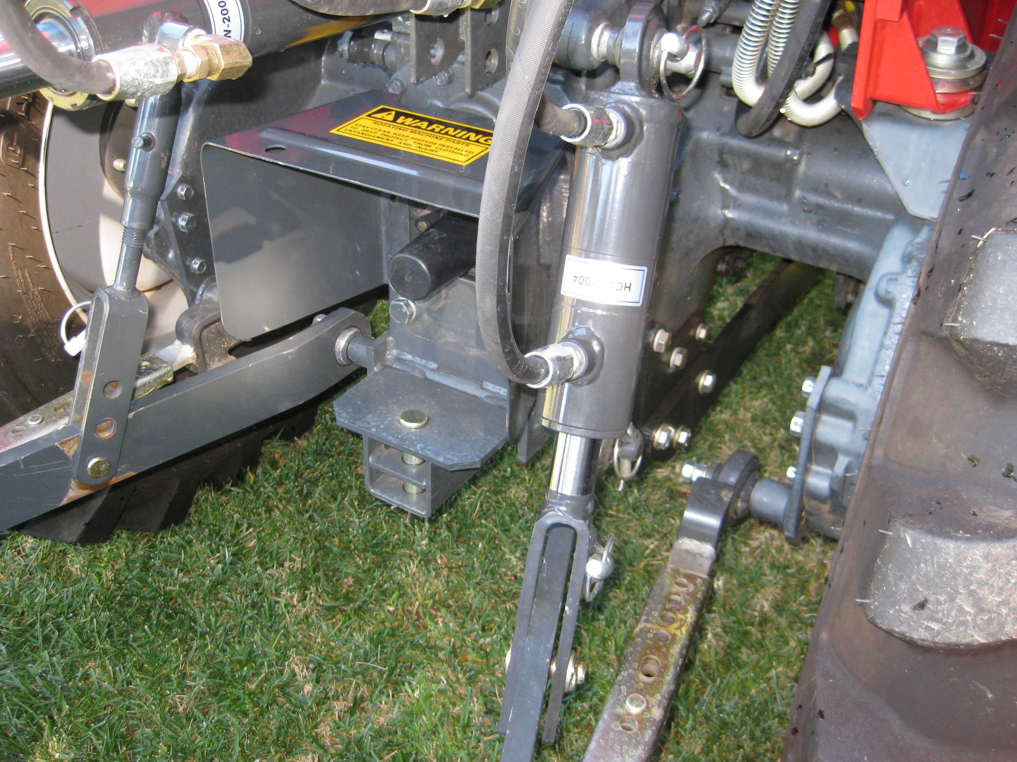

Here are a few pictures of a "TnT" set. Normally the hydraulic side link is installed on the right side of the tractor and a lot of people will install the OEM adjustable link on the left. You would then set the hydraulic to be 1/2 extended and then match that position with the adjustable OEM link. With the lower arms being level you then will have equal ability to tilt both to the right and left sides.

Yes, if you adjust everything so the hydraulic cylinder is halfway extended (or halfway retracted) when the two arms are level. That's what I, and others, have done.

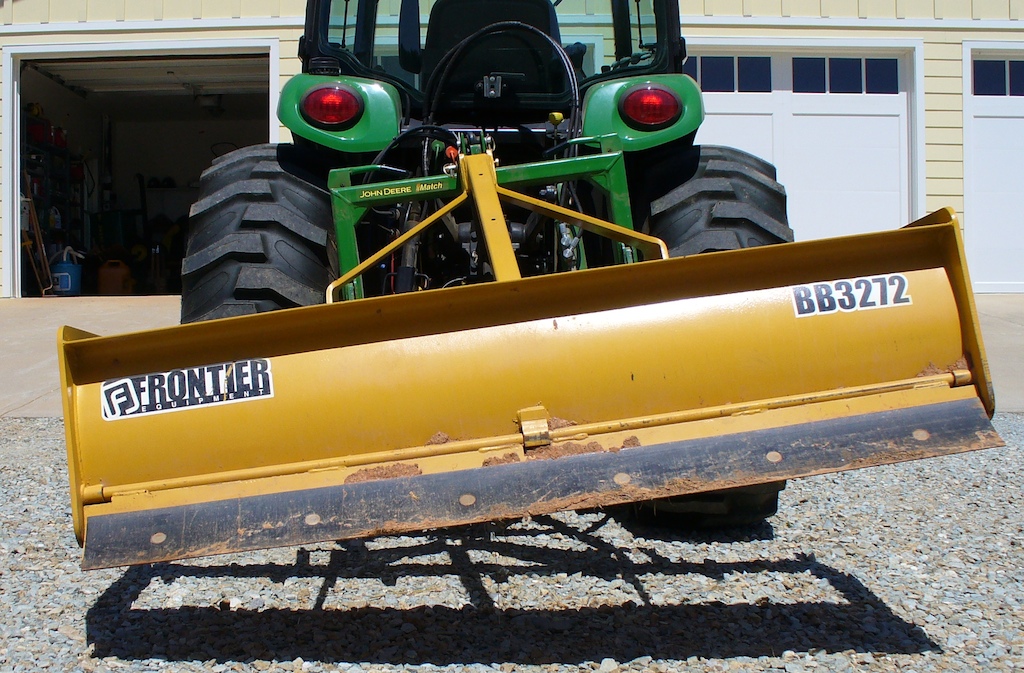

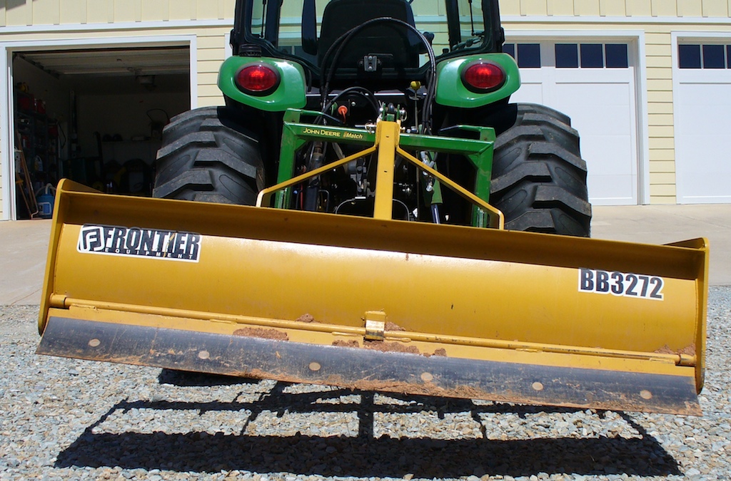

/ Top & Tilt Questions #9
Thanks for the answers. Can you tell me (about) how many degrees of angle I might expect from this setup?
gekog

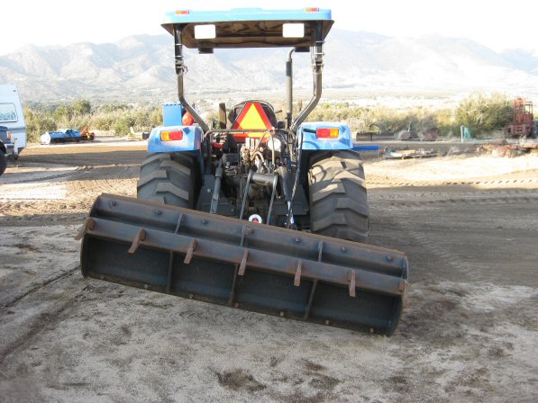

Sorry for the bad pictures, but it is about 11 degrees in each direction. On my bigger tractor it was about 12 1/2 degrees.

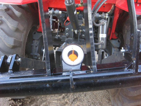

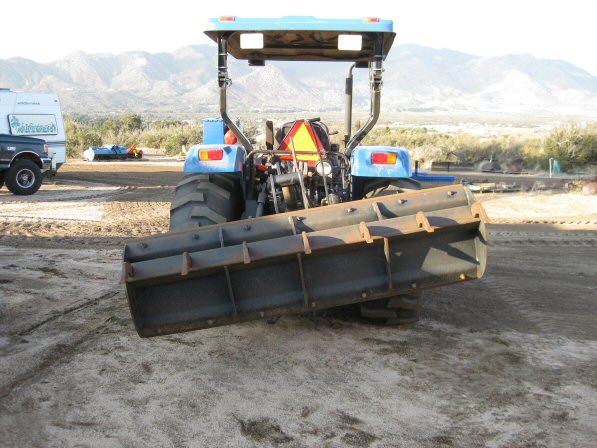

/ Top & Tilt Questions #10

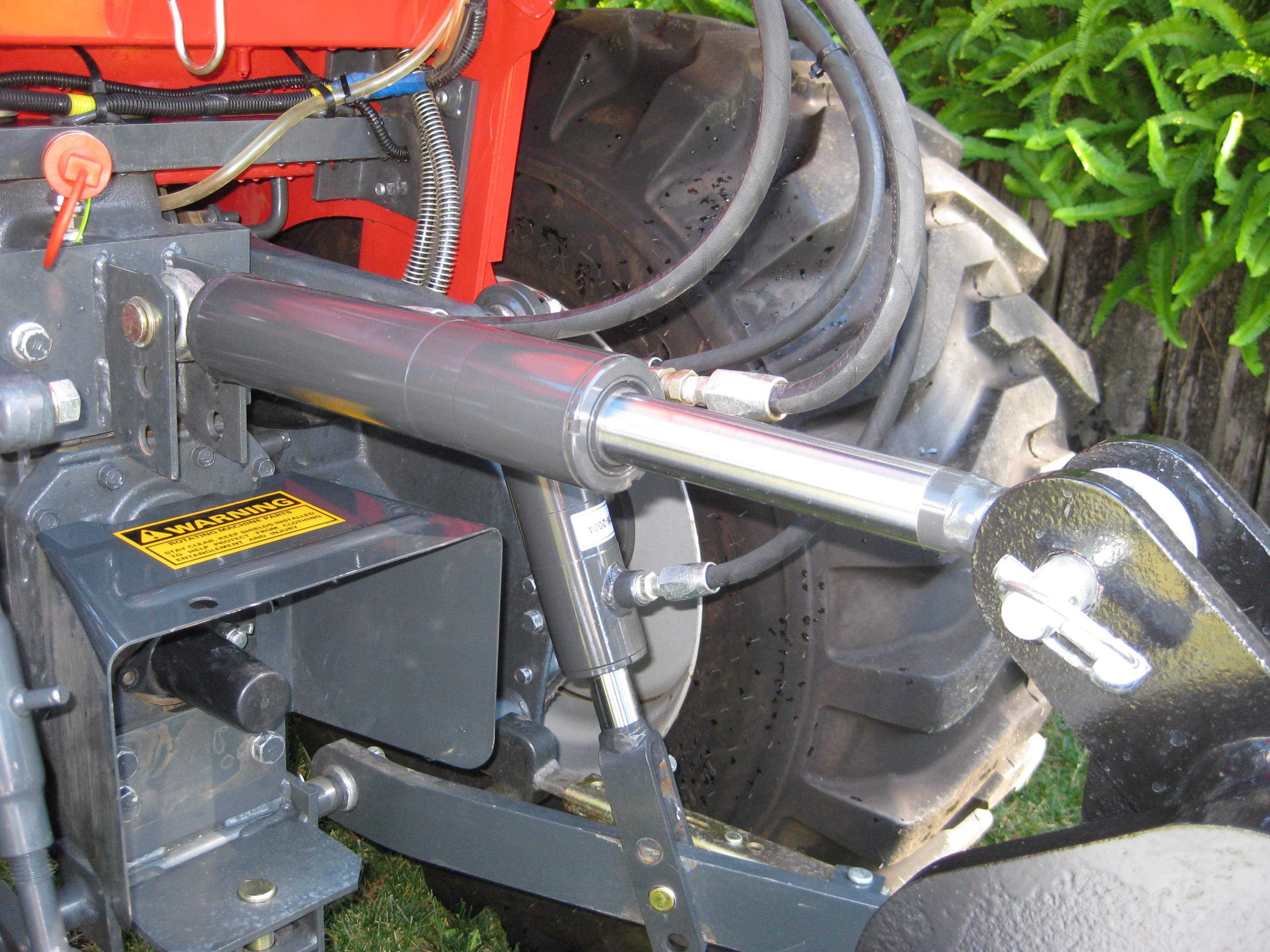

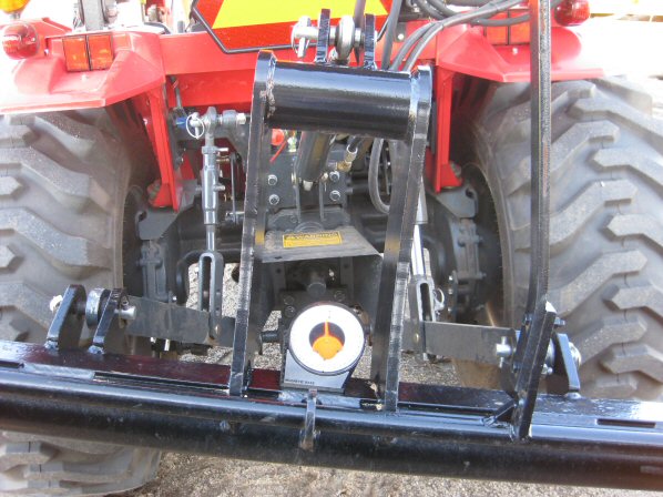

Here's what I got with one CCM 4" cylinder. I could play with the manual adjustment and balance it out a bit, it's good enough for what I do.
And there is shot of the entire 3pt assembly with TnT.
Pete

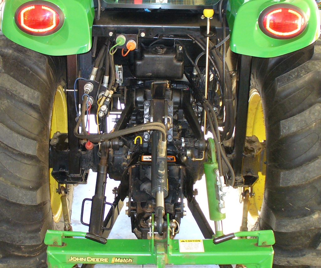

/ Top & Tilt Questions #11

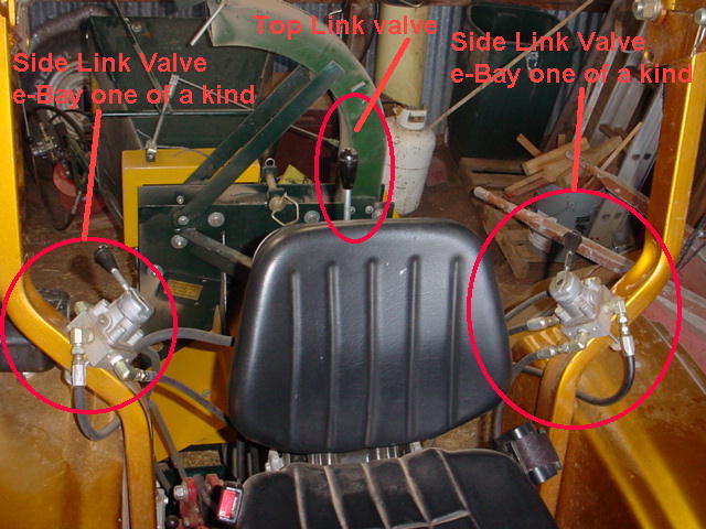

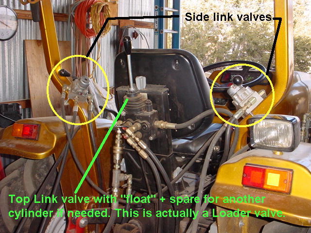

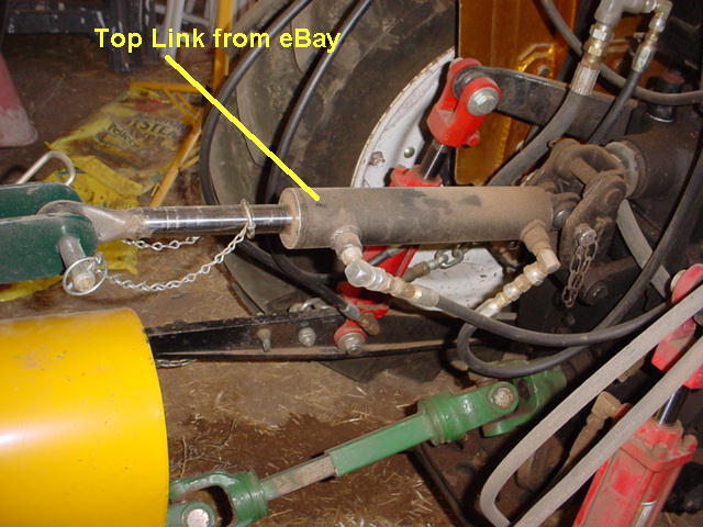

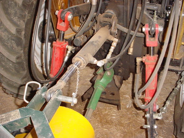

I agree with Brian and Like Rob (3RRL) (and many others) installed cylinders on both sides with no ill effects. IMHO it's a definite advantage having cylinders on both sides, especially when hooking up and disconnecting implements. Another advantage is the ability to equally raise or lower the overall TPH lift arm height, which effectively increases the overall range. The DPOCV comment or "quote?" being "required" on a top link could be technically correct? but never / seldom enforced? I defer judgment on that topic to the more well informed safety police. For the record I prefer not having a DPOCV on the top link mainly because I have a valve with a float position, that feature (for me) comes in real handy for mowing over hills and valleys. Of course others prefer and have the DPOCV for their own personal preference and applications. I prefer the freedom to choose which is best for you and your application. IMHO as long as your putting in the effort into adding hoses, fittings, valves and the like, why not go all the way? Cylinders are cheap.
Anyway here are some pics of my setup.....

/ Top & Tilt Questions #12
Larry, in one of your pictures, you have your 2 side link valves circled and marked one of a kind valves and yet they both look the same. Shouldn't you have said 2 of a kind valves or are they actually different? :rolleyes: :laughing: ;)
/ Top & Tilt Questions #13
Brian,
Okay wise guy - you got me on that one :eek:, actually they were a 4 of a kind deal I could not resist :thumbsup:. I've never seen any valves quite like it, except perhaps maybe on some carnival ride that's about to blow. Speaking of carnival rides, has anyone ever noticed the cylinders used on them? The ones I've seen do not have DPOCV's and they lift PEOPLE :confused:
