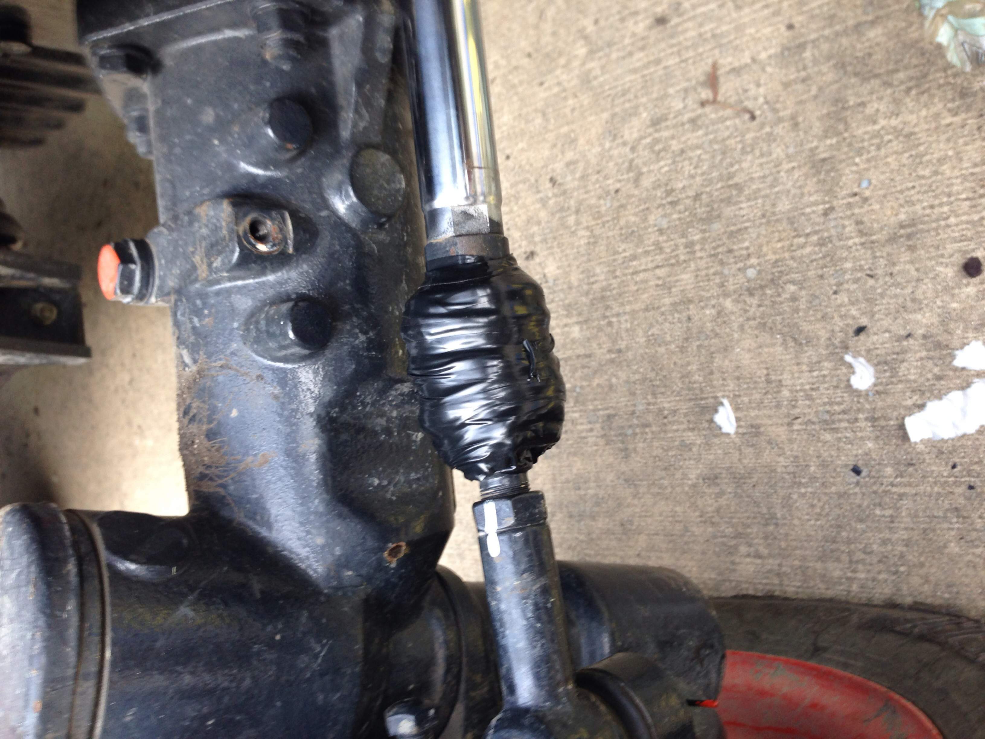

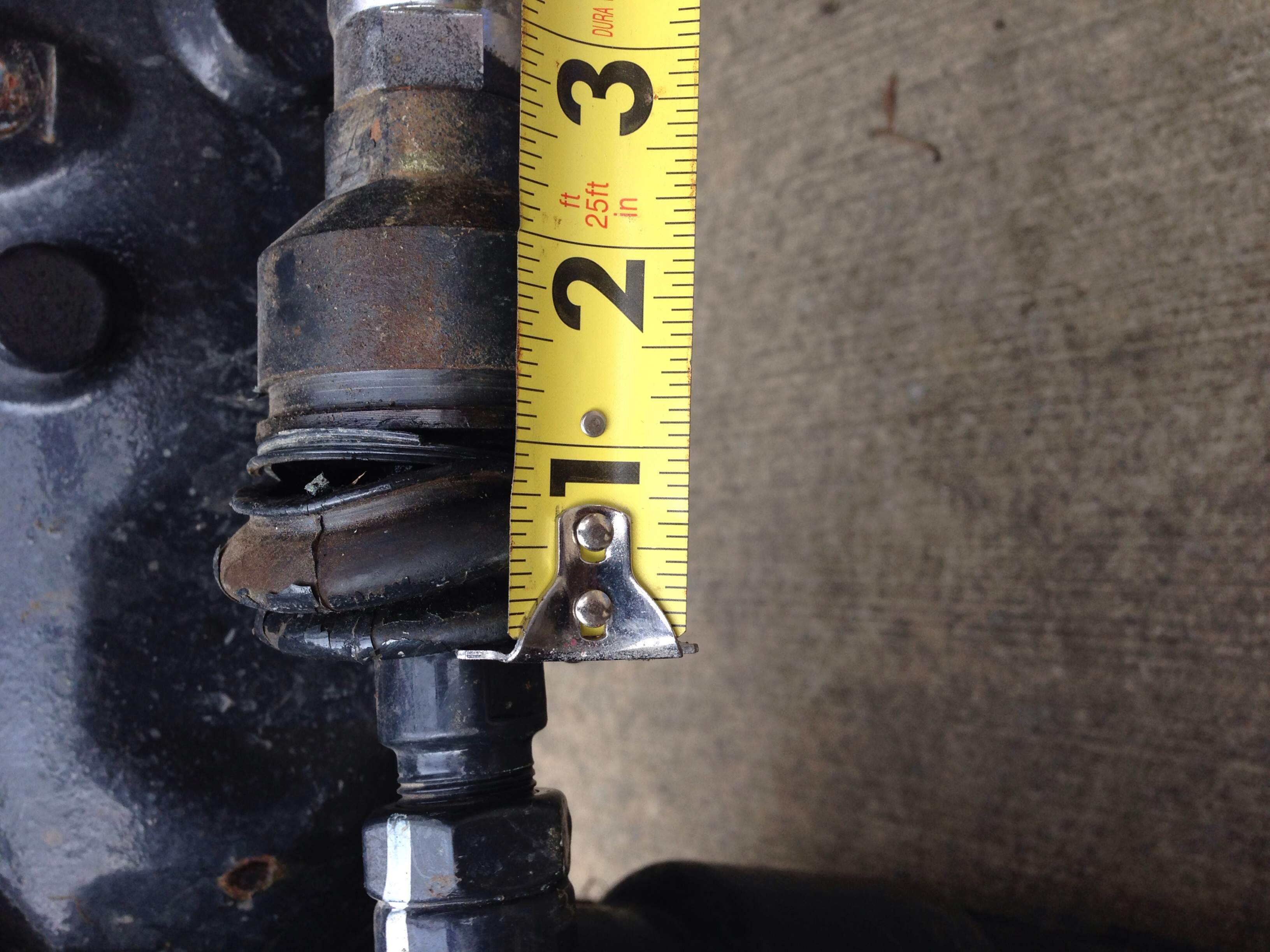

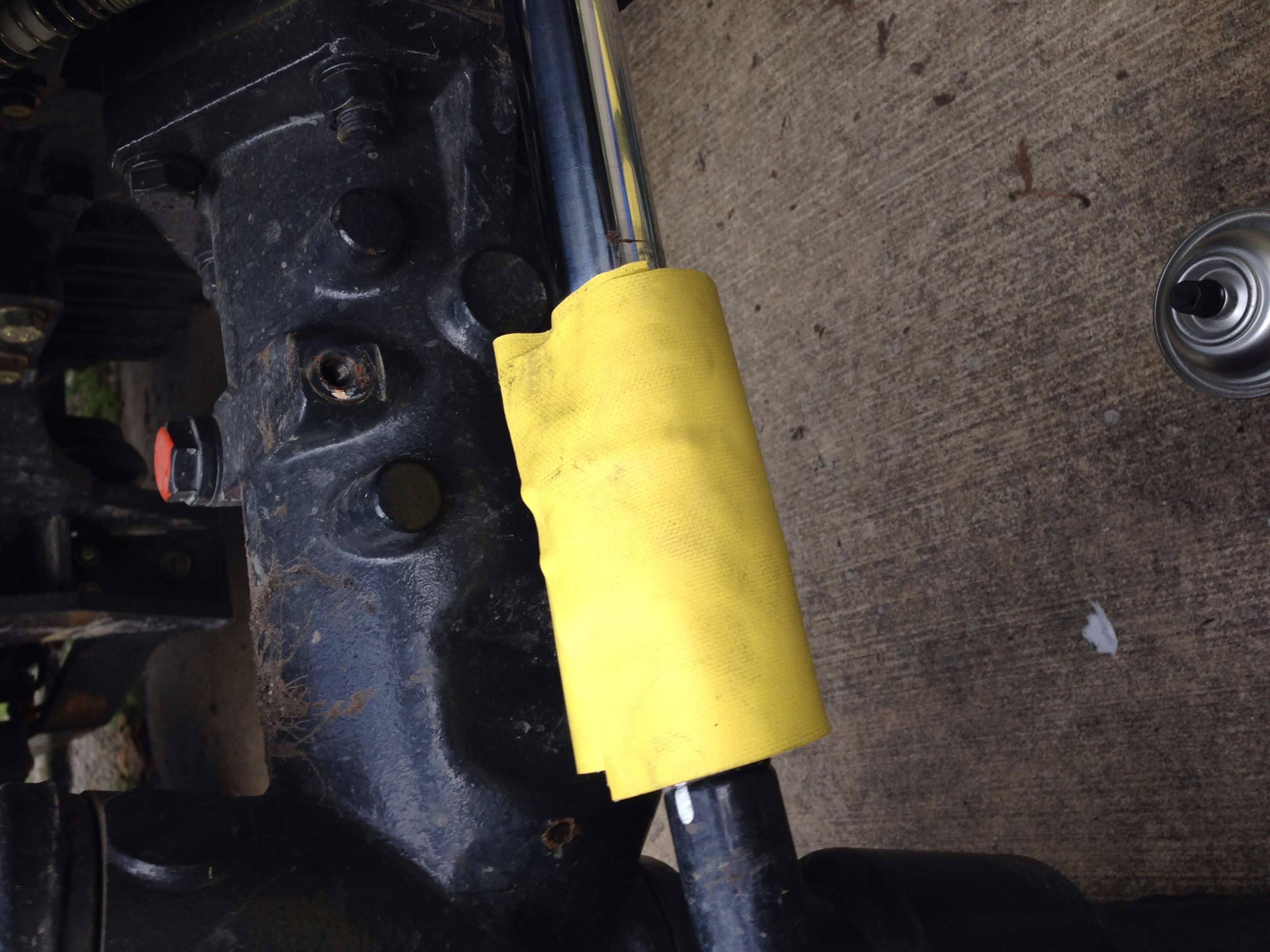

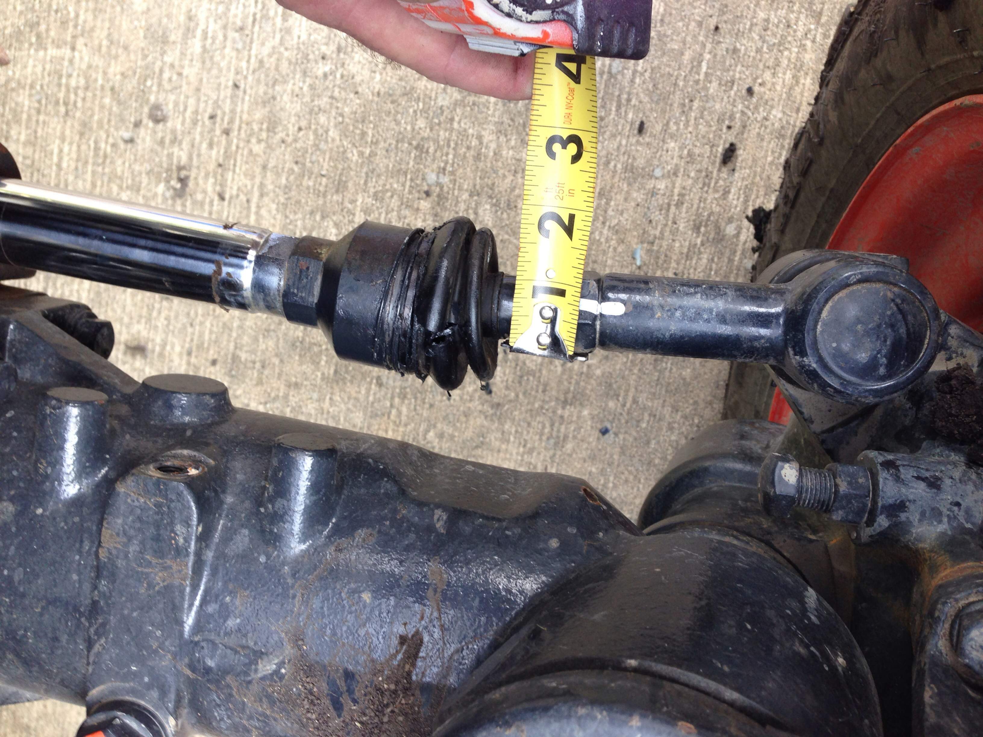

I made a redneck repair. I filled boot back up with grease, wrapped a thin rubber blanket around it, superglued the seam and wrapped electrical tape to keep it sealed. The drivers side (left front) wasn't ripped but was missing the wire tie on he inside side. I replaced the wire that was missing and wrapped up the bellows like he other side for added protection.

You could take it apart and slip bicycle tube over it.
Duct tape is the fastest, easiest and works well.
Slitting a radiator hose or similar and fastening it over the boot may help protect it.
