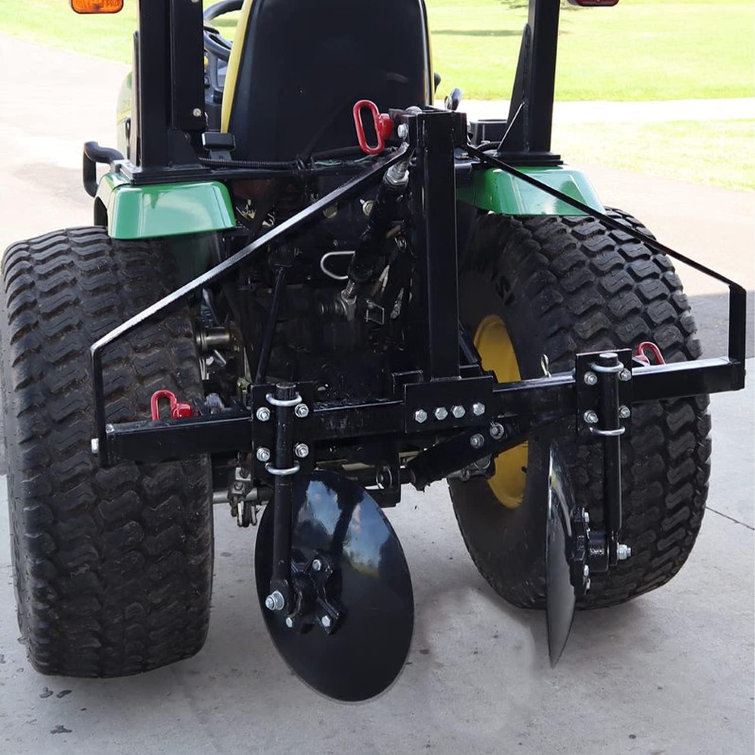

Here you have to do a lot of math :)
think about distance between wheels and wheels width.
here a picture that I stole from an online store
You have to understand, how big rows you can do and how big gap will be between rows
If that fits to your concept - SA will be great machine
Thanks for bringing up that point. It looks like the tire width is just over 12 inches. The width of the tractor is 54.7 so that gap between the tires is roughly 34 inches. Great info to know ahead of time. Mapping out my plot means that I can have a total of up to 24 rows that are 80 ft long each. Each row would be about 30 inches wide with about 16 inches between rows. I don't know what I would do with such a large garden. I need to start studying and figuring out how much that I should really plant.

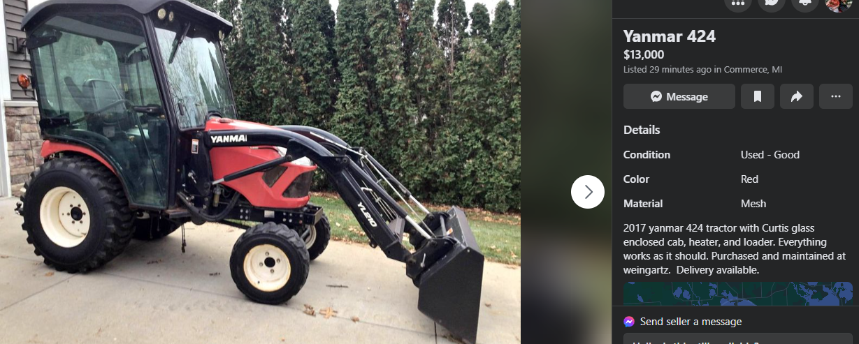

I run a 5-ft tiller on my sa-425, same engine, with no issues.
I would look at Facebook marketplace for a used one. Yanmar doesn't hold their value quite as well as a Kubota or a John Deere and you can pick them up for bargains.
This is also a great time of year to buy a used tiller.
You should be able to get a nice SA 324 or 325 for under 14 Grand.
I would want the 325 because they have the rear remotes as I understand.
I think there's only about 100 lb difference in the lift capacity between 324 and the yt235.
Make sure they load the rear tires and you use ballast when you're doing your dirt work. This is important with Yanmar tractors because they are lightweight but they lift a lot for their weight.
