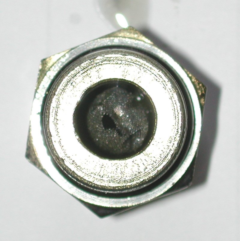

just checked my JD 4300 rockshaft filter and there was a hole blown thru it (55 hrs). Looks like someone drove a scrrewdriver through the screen. I called my local JD dealer and they had never heard of this rockshaft filter and they could not find it on the computer. The Service Manager had no idea what I was talking about. I called John Deere's toll free number and talked to someone who gave me a part number after about 1/2 hour of looking. He said it was LVA12302. Could someone verify this. He also said the new 10 series tractors have been re-designed with a new filter assembly. I ordered this new filter and it is about twice as long and will not work--maybe I need some more pipes and or fittings. I have attached a picture of the torn screen. Does anyone know of retrofits for the 4300 tractor?

The screen you are looking at is normal; most have a small hole as shown in your picture. Problems arise when debris accumulates on the screen and impedes oil flowl, when this happens pressure will blow the screen into the position control valve. At this point, the control valve must be replaced, you can attempt to clean it, but in most cases replacement is called for.
You might talk to your dealer and describe the situation outlined in the new service manual (on line version if you do not already have the revision). He may, may not agree to provide you with the updated filter/tube assembly. If not, you can order the parts if so desired, you will need the following part #:
LVA11765 Oil Line (Left Side line) $15.93
LVA11289 Filter (This is the complete filter assembly, you will not need any additional parts) $27.34
Note: May also be under part # LVA12302 (Check with you dealer)
LVA11210 Oil Line (Right Side line) $21.00
T77932 O Rings (Pkg) $4.80
To install, follow instruction in owner’s manual. Be sure to replace O-rings. Remove fitting from position control valve, you may elect to replace the fitting with part #LVA11299, same fitting as installed without filter screen, however this is not necessary, just take a small drift punch and drive the screen out. This is not difficult. Re-assemble and check for leaks.

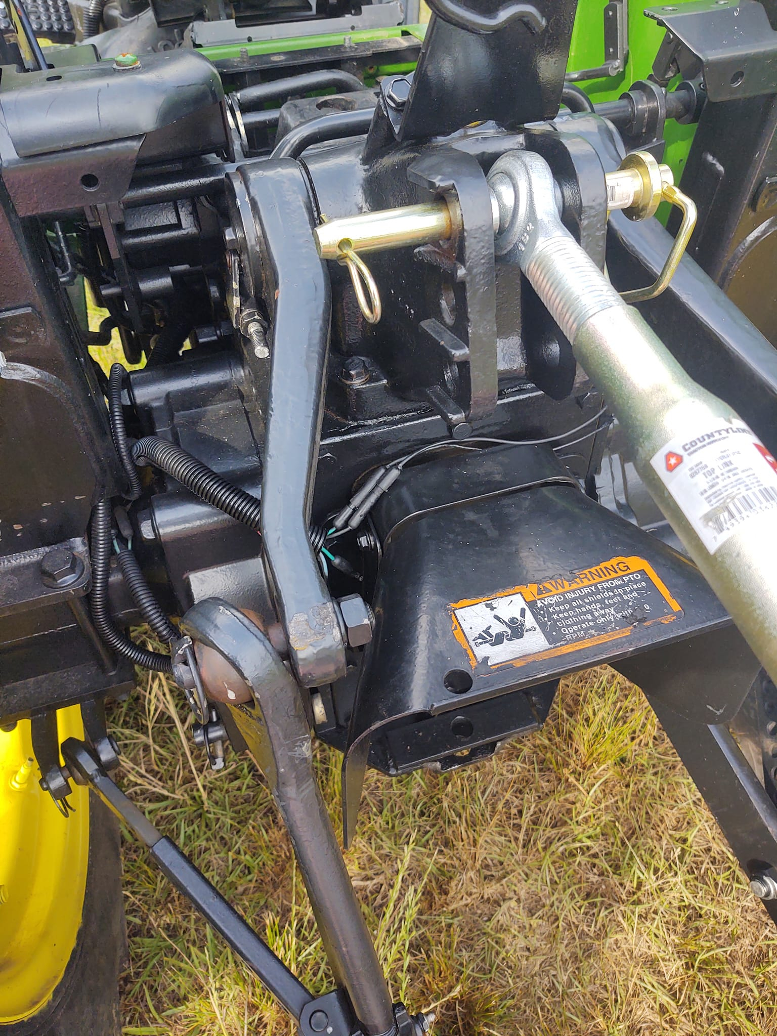

First and foremost, thank you all for this thread. I bought a used 4300 and had a full service done and the dealership wanted to argue that it couldn't be a filter. I was able to give them the part number because of this thread and I have a scheduled pick up, but it's 150.00 trip charge each way.
I do not have access to a manual. I got the seat and seat assembly out to look for the in line filter and I'm not seeing it anywhere. Anyone able to help point out where I need to be looking? I climbed under and looked by the fender and saw nothing. I looked all around the lever and don't see anything. I feel like this should just jump out at me as being very obvious and able to see. What am I missing?

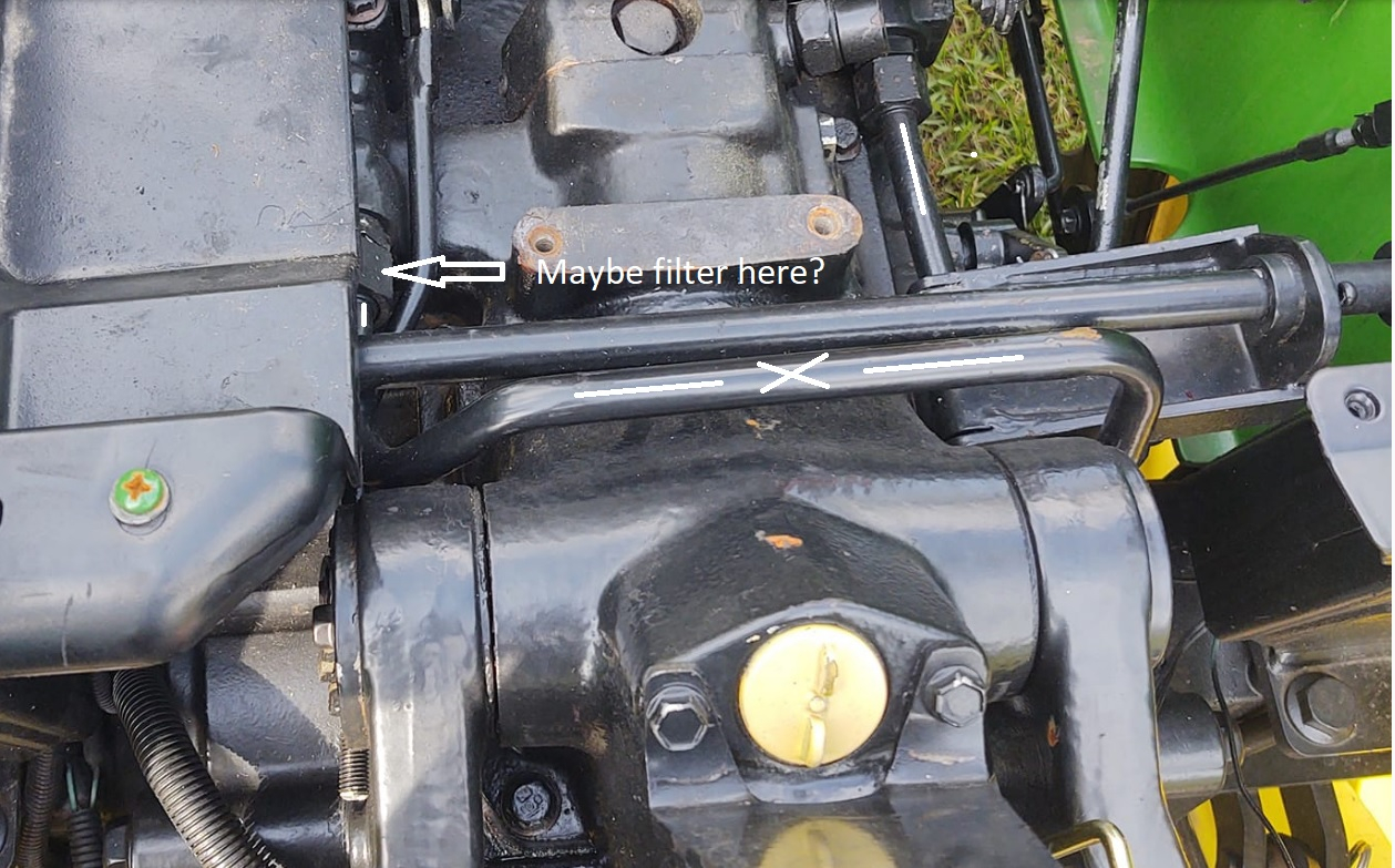

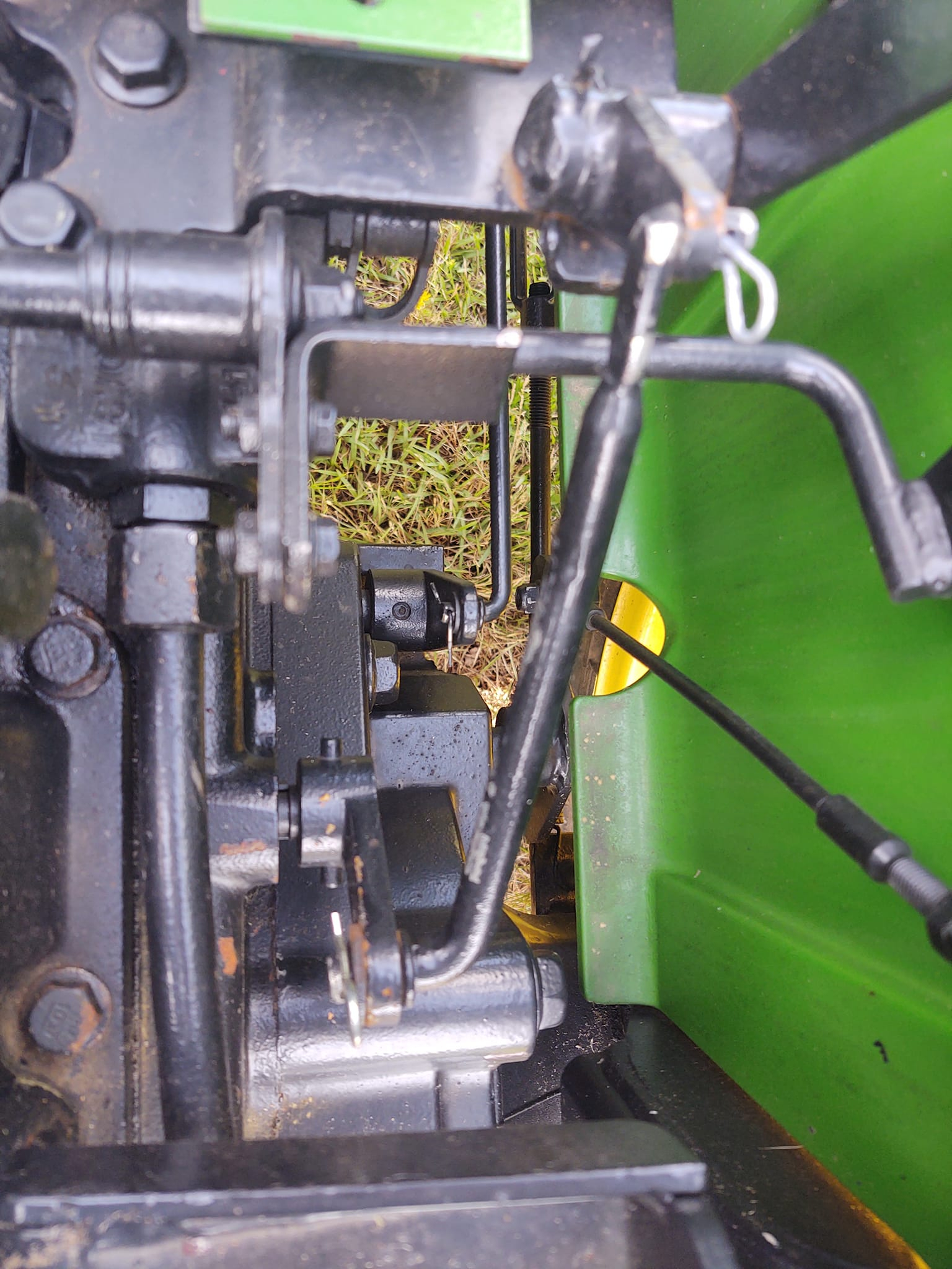

Thank you for responding. I have uploaded from 3 angles.

   / Torn Rockshaft Filter 4300 #17
Mike
Good pics.
And I see your cross-over pipe but do not see a filter in that pipe (tubing) where mine was located. So maybe fixed with this trouble-some filter removed. ??
Here is a link to a previous post that shows a filter in a different version of that cross-over pipe that drops down
I will look for pics of the replacement (and longer) filter that was installed on my 4300. But mine does not cross over that low (just looked).
From your pic, I've put white lines on the cross-over pipe and a white X where my original filter (screen) was located. Now I believe it is in the end of that pipe on the left side (but not certain of that). Been 22 years since changing that pipe.

On a side note, noticed the lynch pins on your 3 ph arms. I lost one of those while working in brush and nearly had a broken casting as a result when brush hogging.
Because so seldom ever needing the arms removed, I replaced those lynch pins with bolts and lock nuts. Something to consider.

and please get rid of that way too long top link pin before it vibrates over and one of the lift arms catches it and breaks something that you really don't want to buy!
