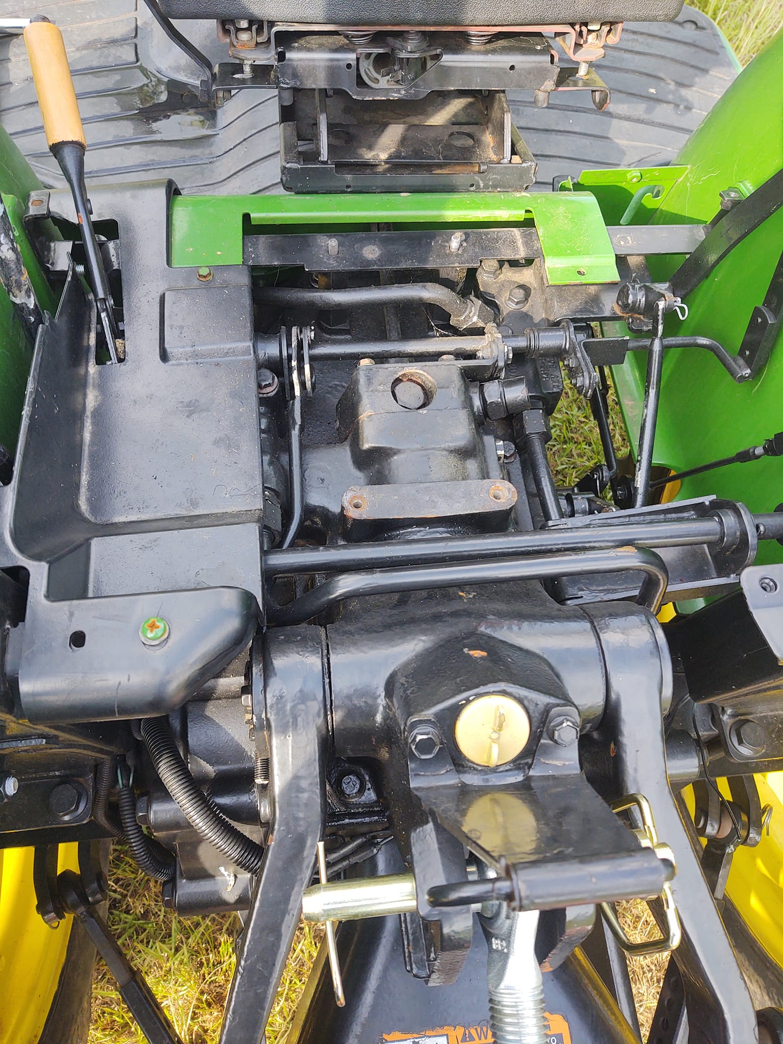

First and foremost, thank you all for this thread. I bought a used 4300 and had a full service done and the dealership wanted to argue that it couldn't be a filter. I was able to give them the part number because of this thread and I have a scheduled pick up, but it's 150.00 trip charge each way.
I do not have access to a manual. I got the seat and seat assembly out to look for the in line filter and I'm not seeing it anywhere. Anyone able to help point out where I need to be looking? I climbed under and looked by the fender and saw nothing. I looked all around the lever and don't see anything. I feel like this should just jump out at me as being very obvious and able to see. What am I missing?

Post pics of the area under the seat with the seat assembly out. Maybe then we can point out the filter.. either the problem one or if it has had the updated one added.

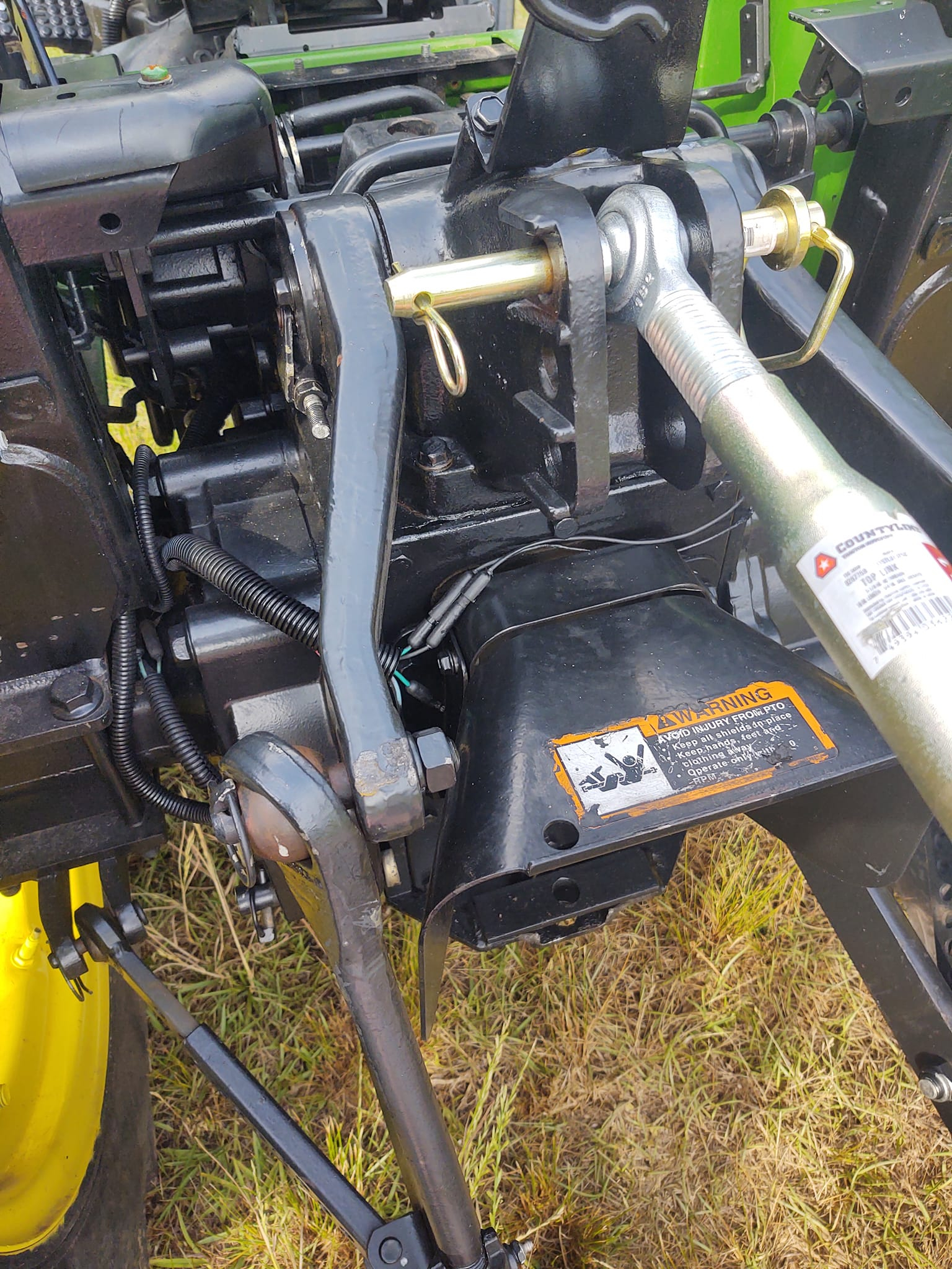

Thank you for responding. I have uploaded from 3 angles.

Good pics.
And I see your cross-over pipe but do not see a filter in that pipe (tubing) where mine was located. So maybe fixed with this trouble-some filter removed. ??
Here is a link to a previous post that shows a filter in a different version of that cross-over pipe that drops down
I will look for pics of the replacement (and longer) filter that was installed on my 4300. But mine does not cross over that low (just looked).
From your pic, I've put white lines on the cross-over pipe and a white X where my original filter (screen) was located. Now I believe it is in the end of that pipe on the left side (but not certain of that). Been 22 years since changing that pipe.

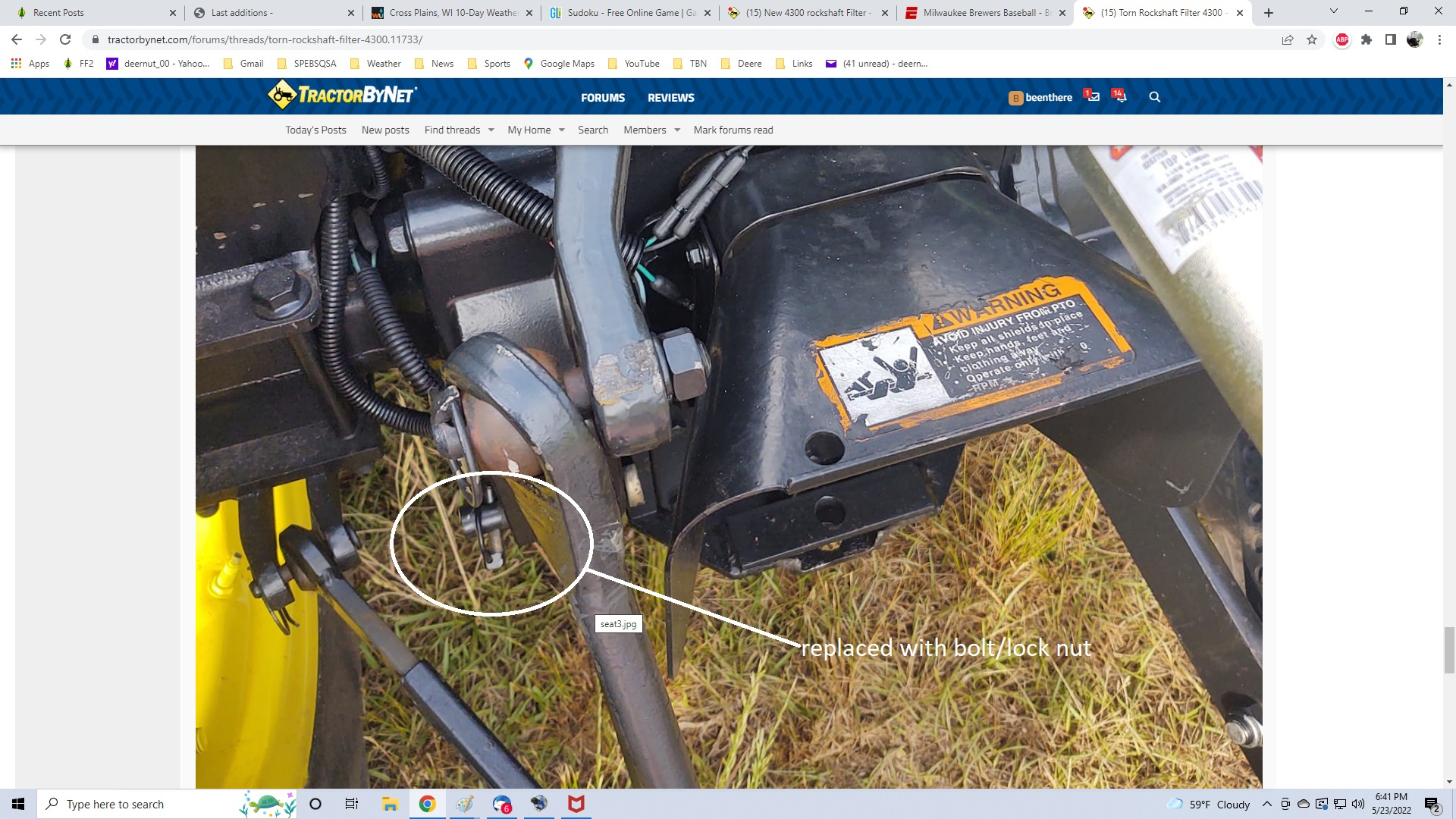

On a side note, noticed the lynch pins on your 3 ph arms. I lost one of those while working in brush and nearly had a broken casting as a result when brush hogging.
Because so seldom ever needing the arms removed, I replaced those lynch pins with bolts and lock nuts. Something to consider.
Rendition of your pic.

and please get rid of that way too long top link pin before it vibrates over and one of the lift arms catches it and breaks something that you really don't want to buy!
   / Torn Rockshaft Filter 4300 #20
Thank you both for the advice on the pins. It's blatantly obvious I have no idea what I'm doing and I sincerely appreciate the feedback fellas.
