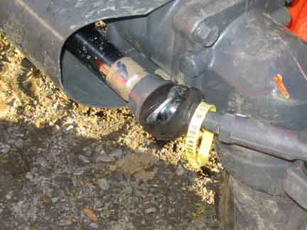

Here's a pic of the steering joint with the torn rubber boot. When I was still deciding on tractors the salesman made a special point of telling me about the nice rugged steel shield around this joint.(except when you turn left. after all that's only half the time). I have really good directions about taking this apart without damaging anything, probably a one beer job

</font><font color="blue" class="small">( Here's a pic of the steering joint with the torn rubber boot.)</font>
And all this time I thought you guys were talking about the boots on the tie rod ends.
To me, that looks like a job for a 6" section of old bicycle inner tube and a couple of zip ties.

</font><font color="blue" class="small">( To me, that looks like a job for a 6" section of old bicycle inner tube and a couple of zip ties.
Jay )</font>
That's what I'm thinking of doing, after cleaning the U-joint and re-greasing it.
Thanks for the info, guys.
