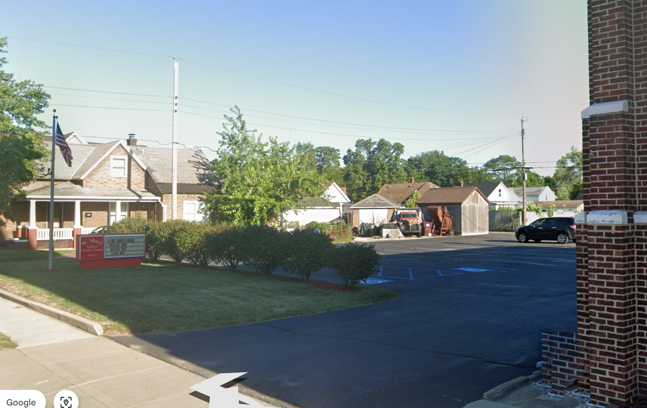

A long time ago I was friends with an elderly woman whose husband hand-dug basements under house for a living. He'd dig a cubby hole under the side of a house, install cribbing, keep digging to a point where he could slid a conveyor into the cubby hole. That would haul the dirt out to his dump truck. Eventually, he'd get the entire house on cribbing, jack it up a few inches, and dig out a perimeter into which he'd pour a footing and do block walls. Then he'd lower the house down on the new walls and finish digging out the dirt to make a full basement.
He was old, gnarly, and bent over. His wife said she had to pull him up into a sitting position on the edge of the bed and oil up his knees every morning. She'd go make breakfast and eventually he'd hobble downstairs, eat, and off to work. He put three kids through college. His boys would help him when they had time, but mostly he did it on his own.
The two of them are long deceased. They were a very cute couple. We'd see them in the grocery store holding hands. One day in church, he took her hand, leaned over on her shoulder and died. :confused: But if you have to go, I suppose that's the place. She moved in with her daughter and passed years later.
This is the house they lived in. If you look in the back, his drum truck and mixer are still there.
