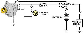

That alternator might not be a permanent magnet alternator for this reason. If it is a regular alternator, it need an exciting voltage to start charging. Once it is up to speed, the regulator begins to regulate the current through the field windings. Usually when you turn the ignition on, it send 12 volts to the alternator as an excitation voltage to get things going. Since you put 12 v to the B terminal, you gave the alternator an excitation to charge at 14.2v DC. There might be a broken or disconnected wire running from the ignition switch back to the regulator. If your alternator is putting out 13v to 14.2v, that means that the alternator and maybe the regulator is good.
I believe tere is a way to get max charge from the alternator, and that is to jump 12v DC to one side of the field .
Alternator Terminal ID's
'S' terminal
Senses battery voltage
'IG' terminal
Ignition switch signal turns regulator ON
'L' terminal
Grounds warning lamp
'B' terminal
Alternator output terminal
'F' terminal
Regulator Full-Field bypass

I've identified the problems. The symptoms were actually caused by two issues.
There was a short to ground in the fuel shut-off solenoid. I'd already pulled the guts out of the solenoid valve earlier due to another problem, so I just disconnected it. Now there's no more voltage between the positive terminal and the regulator B terminal.
The other problem is that there was some kind of short in the fuse block. The fuses were all good, but when I moved the wires going to the fuse block, the battery warning light on the dash would come on and off.
I couldn't see any obvious wear points or breaks in the wire, so I sprayed a bunch of electrical cleaner in the whole fuse block and blew it out with compressed air. I put the fuses back in and it seems to work now. I ran the mower for a few minutes with the lights on, and the battery warning light never came on. Knowing the nature of electrical shorts, though, I won't be surprised if the problem re-appears. This time I'll know what to look at first.

I guess "short" is actually the wrong term for it. What I had was a loose connection. The fuse box connections for the wires going between the battery and the regulator were not making the connection all the time; and, therefore, I wasn't getting voltage to the regulator so I wasn't getting charge to the battery.
I did have a short going to that fuel solenoid in that I was getting continuity to ground with it. It wasn't a very strong connection; or, like you said, it would have blown something. I did notice previously that if I let the mower sit for a while without starting it, I'd have a low battery. A slow drain due to a weak short would explain that.
