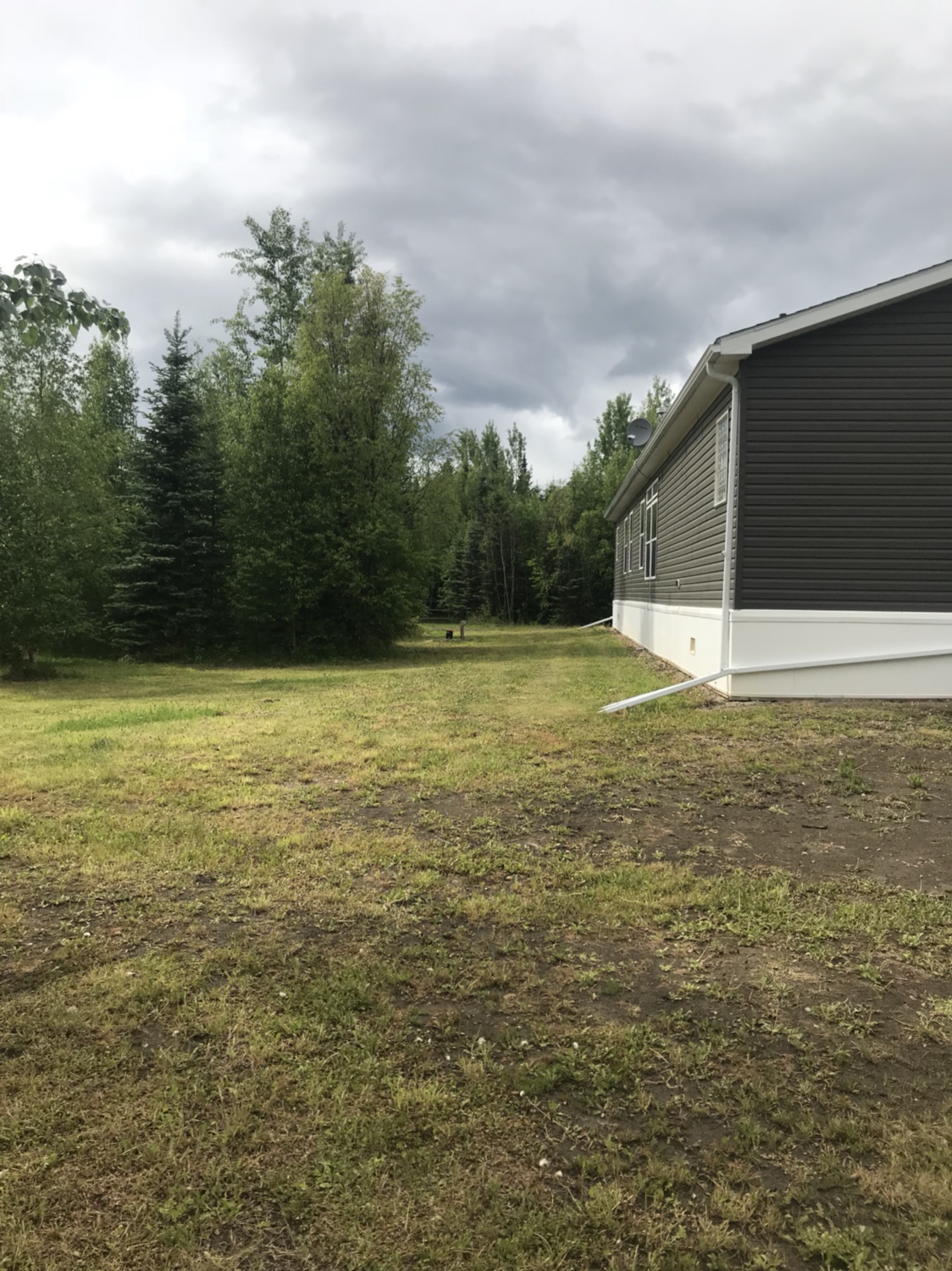

Here is some pics of the area I’m doing. It just rained also

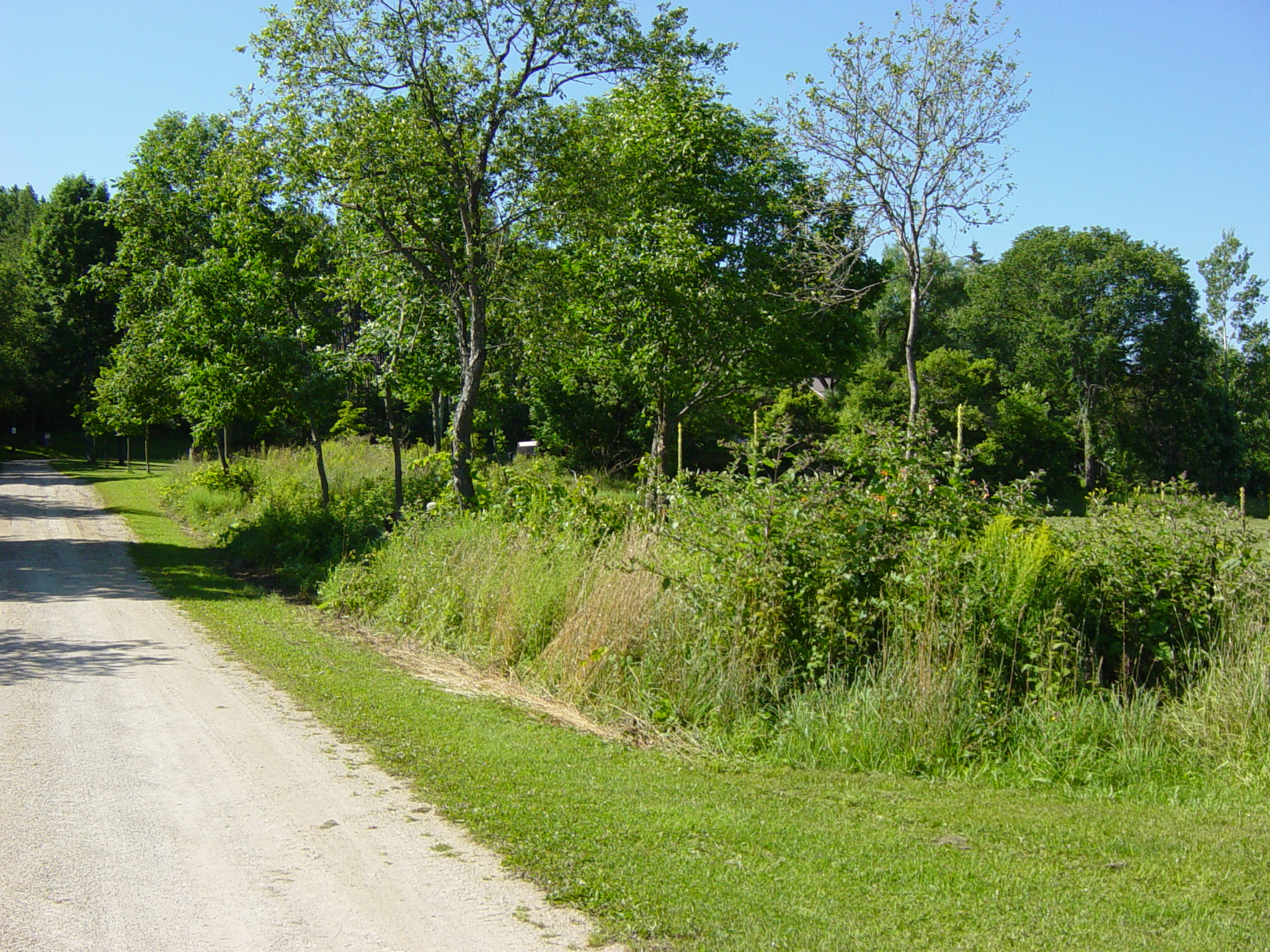

I have this Harley Pro 8. It is an amazing machine. It figured heavily in the preparation of this area at my place last week.
I removed maybe thirty truckloads of stone from this location, starting with an excavator.
I do wish I had the small Harley Rake for my Steiner, to better maneuver and get around trees. This may work better with a skid steer.
Before Picture. Can't see the stumps ans stones.

The dingos I have used have plenty of power to run the attachments.
   / Toro Dingo Harley rake vs full size skid steer Harley rake ?
The skid steer is a pressurized cab. I am worried the dingo will take twice as long and not do has good of job has the skid steer?
   / Toro Dingo Harley rake vs full size skid steer Harley rake ? #9
Dingo bound to take longer. Not see how it do any worse job than the skid steer. Perhaps better.
