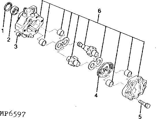

I would take a WAG the problem would be a pressure control(relief) valve if tractor has one not the pump shaft. I'm not familiar with a 790 where is the hyd pump located(engine or trans)?

Toward front of left side of engine. Two pumps driven by one shaft and gears Any idea where the relief valve would be located? Also the screen had a plastic sleev over it is that normal?

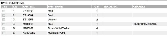

Jim may I ask what the url is forthe 2 diagrams you sent me - I wanted to see if I could get the part numers for the various parts in each one. Thanks Dave S
   / totalloss of hydraulics 790 #14
Sorry but I'm a computer dummy. I have no idea how to locate the url's. You can view the 790 parts catalog at JDparts.com. If you can't locate the PN's on JDparts.com I'll post them for you.

Check for PN's above with photo's.
