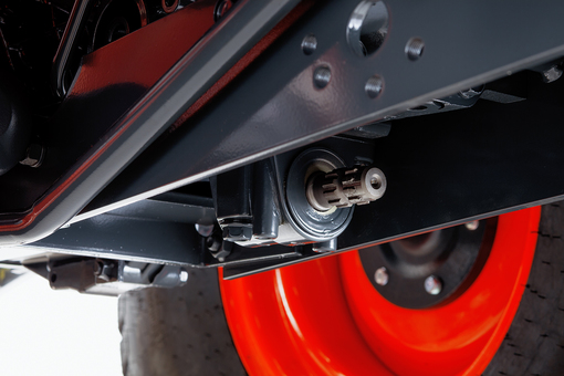

Went out on my Kubota L4330 this afternoon, got halfway up to my pole barn and it started to die out and then stopped. The Mid-PTO symbol came on on the dash lights, never had seen that before. As far as I know, I have no mid-PTO.
Tractor in neutral, key turned on to 'start", zero response, won't start, won't crank, won't do nothing.
I've never had this happen before, have no clue what the heck is going on.
HELP!

Crawl under the tractor and see if you have a mid PTO. If you do, find out what lever or switch engages it then put lever or switch in the other state. If you don't have one... (pray that you do). Then it sounds like a computer logic error.. Disconnect battery, reconnect, and try again. Keep in mind I don't know anything about L4330's. But of course tractor would not start if any PTO is engaged, so that would be normal not to start.

I don't *think* I have a mid-PTO. Wouldn't it be obvious under the tractor???? :confused:

Well the Mid PTO is not quite as big as the rear one, and usually have a cap over them to protect the splines. They are not all that obvious.

It looks to me I need to get the mid-PTO to turn "off" even though it doesn't appear that I have one. There is no switch or control anywhere on the tractor to turn one on (unlike the PTO control that is located to the right and the rear of the seat area. There is no control where the owner's manual shows one for the mid-PTO lever.

This is bad. OK, I am convinced you don't have a Mid PTO, but your computer is convinced it has one and it is turned on, so the tractor won't start. So battery disconnection did not cause the computer to reboot. OK, we have to figure out out to reboot the computer. Try the link below.. the problem is a different problem, but it is a service interval reset, and who knows it might reset this problem.
