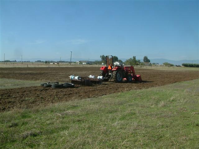

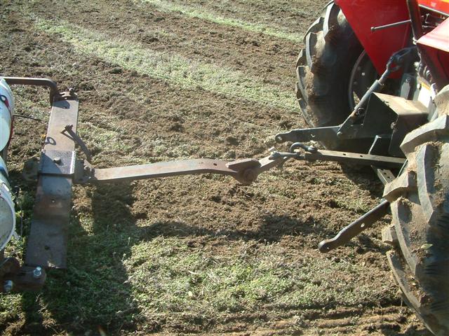

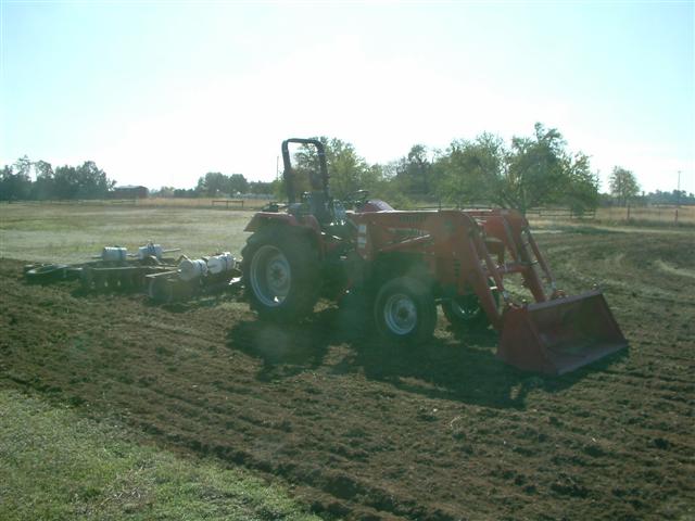

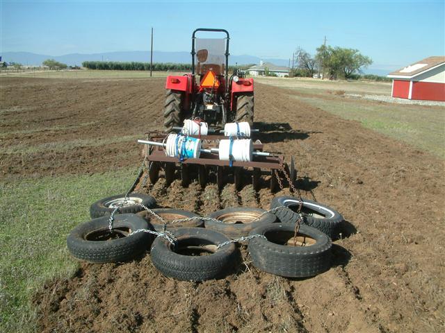

I'd look for a 30-40 hp (engine) 4WD tractor with hydrostatic transmission, power steering and an FEL with a 5-ft wide bucket.
For initial cultivating in sandy loam, I'd try a 6-ft ft wide offset disc. Load it with extra weight and pull it 5-6 mph. Make several passes in different directions.
Here's my 6-1/2 ft offset disc with about 450 lb of concrete weights tilling my 6-acre hayfield. I tow a few tires behind the disc to help break up the clods.
The tractor is a 2008 Mahindra 5525 (54 hp engine, 45 hp pto, 2WD, gear tranny, power steering) and the old disc is a gift from a neighbor.
