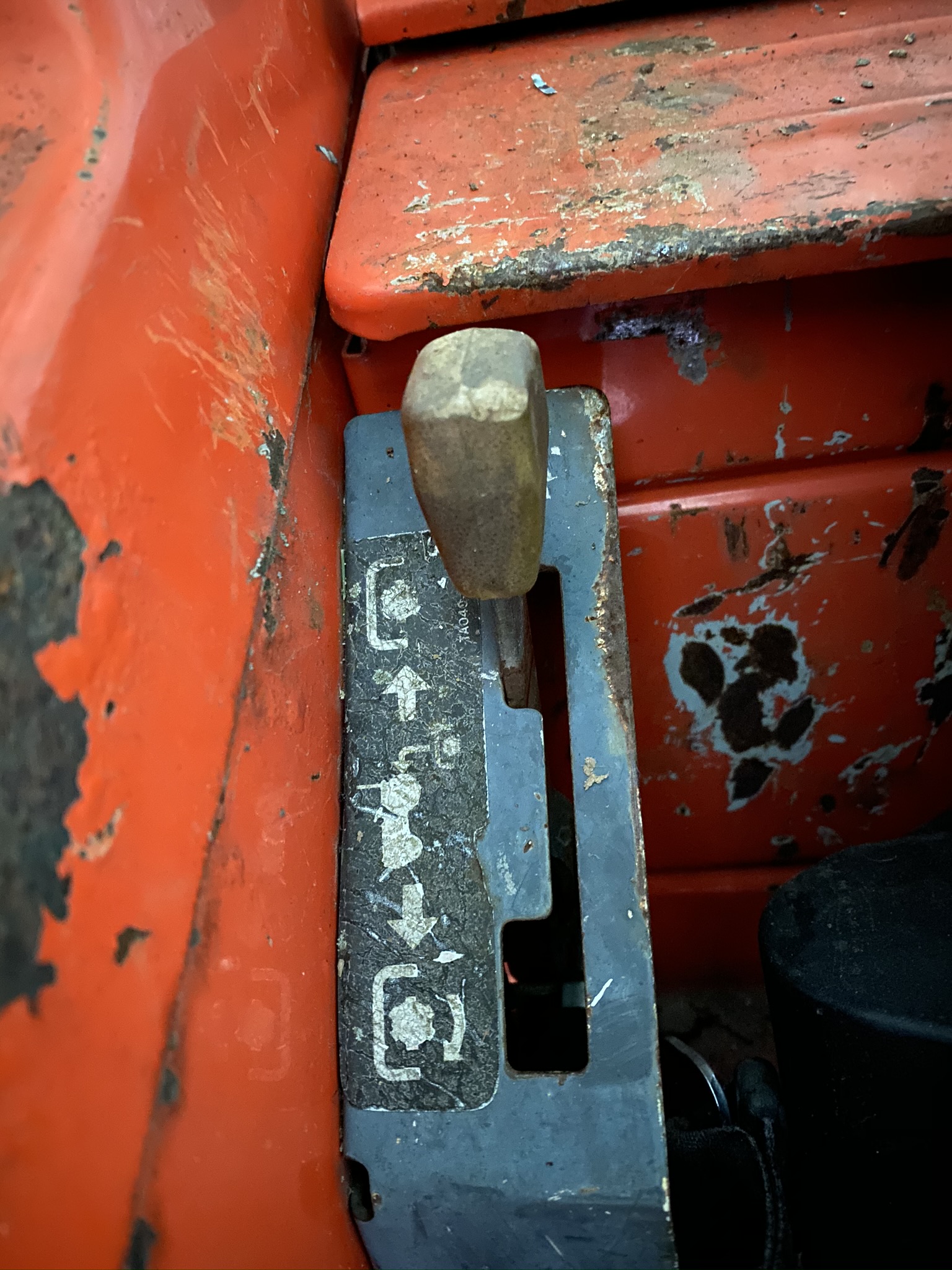

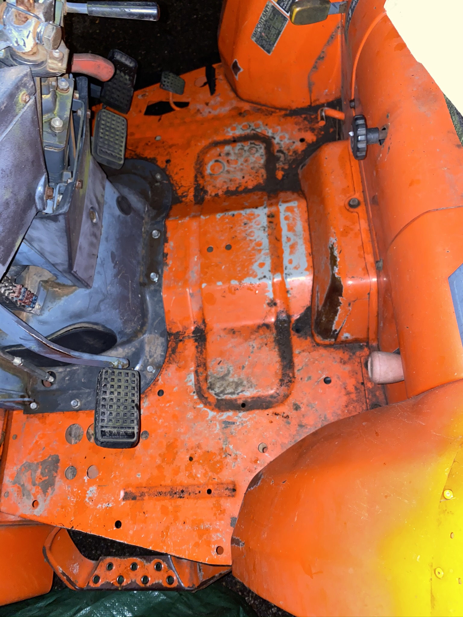

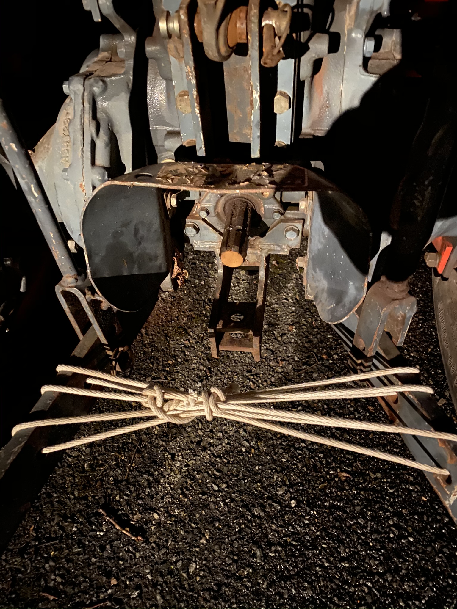

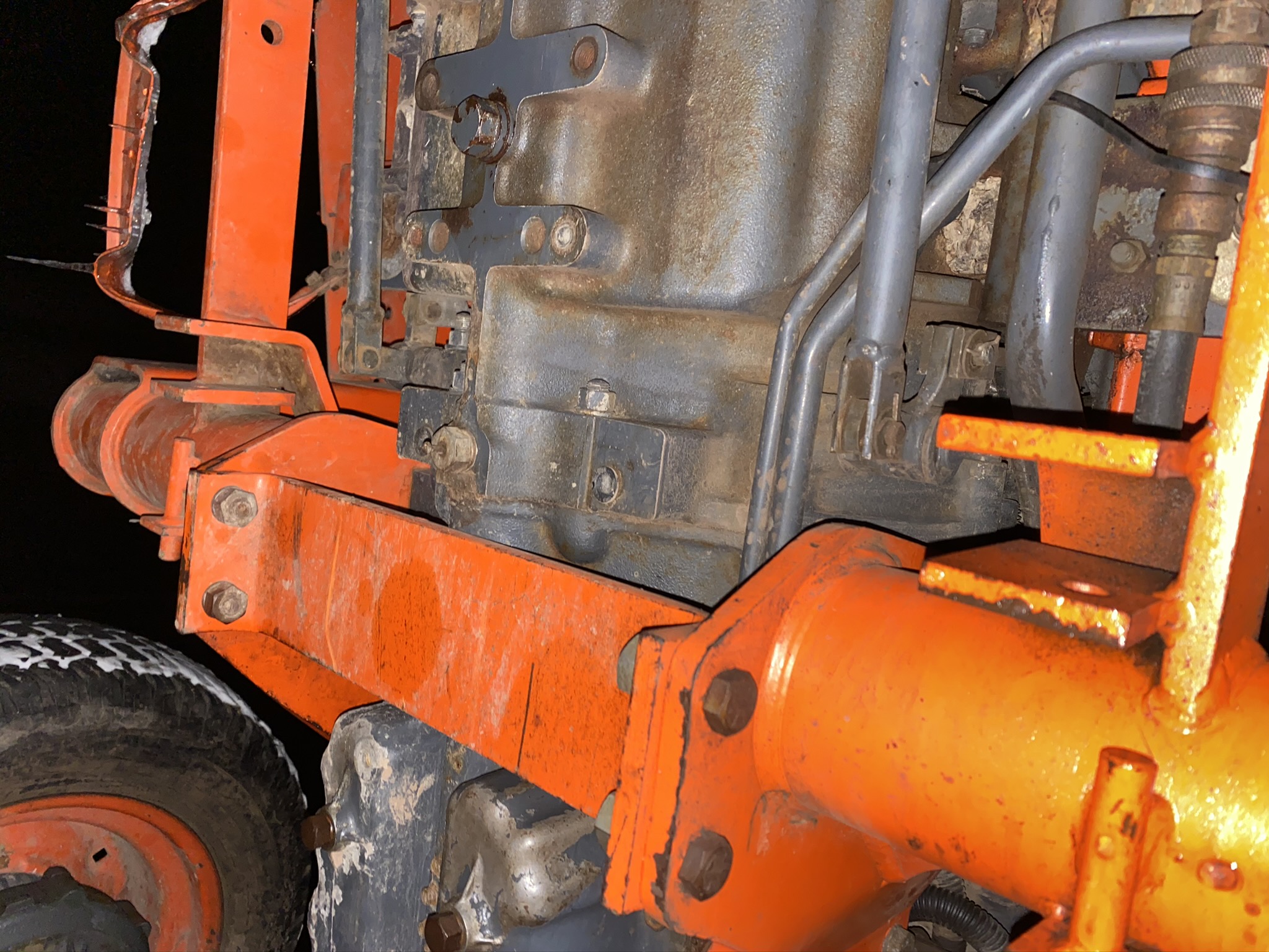

My 94' Kubota is missing some paint and I'm wondering if I can do a touch up / spray it or do I need to commit to full paint job. If the answer is "paint job" I don't think I can commit to such project anytime soon.
Here are few pictures of the tractor conditions (I'll be replacing both fenders and grill): IMG_1333.jpegIMG_1338.jpegIMG_1626.jpegIMG_1746.jpegIMG_1846.jpeg

I would just focus on a section at a time. For instance, do the front axle and front wheels as one project. Then the fenders, then the hood, etc. Worst first.

From the OP pictures I would suggest doing just one section at a time also.
I bought a 2006 L48 back in June.
It has some paint areas that look like the OP bad areas, but like his machine, some good areas also.
I am in Florida now for the winter, and my Kubota is not here.
This season (Summer), I painted both fenders (removed and blasted first), the right hand fender mounted selector panel, the seat frame assembly, the console cover parts, all 4 wheels, and the loader bucket, plus some sub-frame touch-up.
Lots of prep work first,...... and I DO NOT use rattle cans!
Next Summer will be the entire hoe.
Later the loader frame, and maybe the cowl.
My projects are slow....I am an old guy.
I used paint sold by Amazon: TTB27-GL TTB..... @ $26.52 per gal.
It is a machinery enamel, that worked very well, and is an EXACT Kubota match (possibly made by Valspar?).
I did also add a little Valspar 4625 enamel hardener. .
The paint is also available in quarts as TTB-29-QT TTB for $17.05

I bought a can of rustoleum NH blue I use with a paint brush and a hot dog roller for long flat surfaces and the finish came out excellent no Boyd Coddington paint job but good enough for a daily driven tractor . Grab a 12 pack and get to it .:drink:
/ Touch up or paint? #6
If you store the tractor inside then I would take the time to do a proper paint job one section at a time. If you store it outside then just rattle can it as the paint will be faded in a few years anyways.
/ Touch up or paint? #7
When I had my Kubota - I went to Tractor Supply, bought a can of their Kubota Orange - and a can of Primer (Rustoleum?) - sanded - primed - tape and sprayed quick buff and blend - could not tell where I sprayed.....

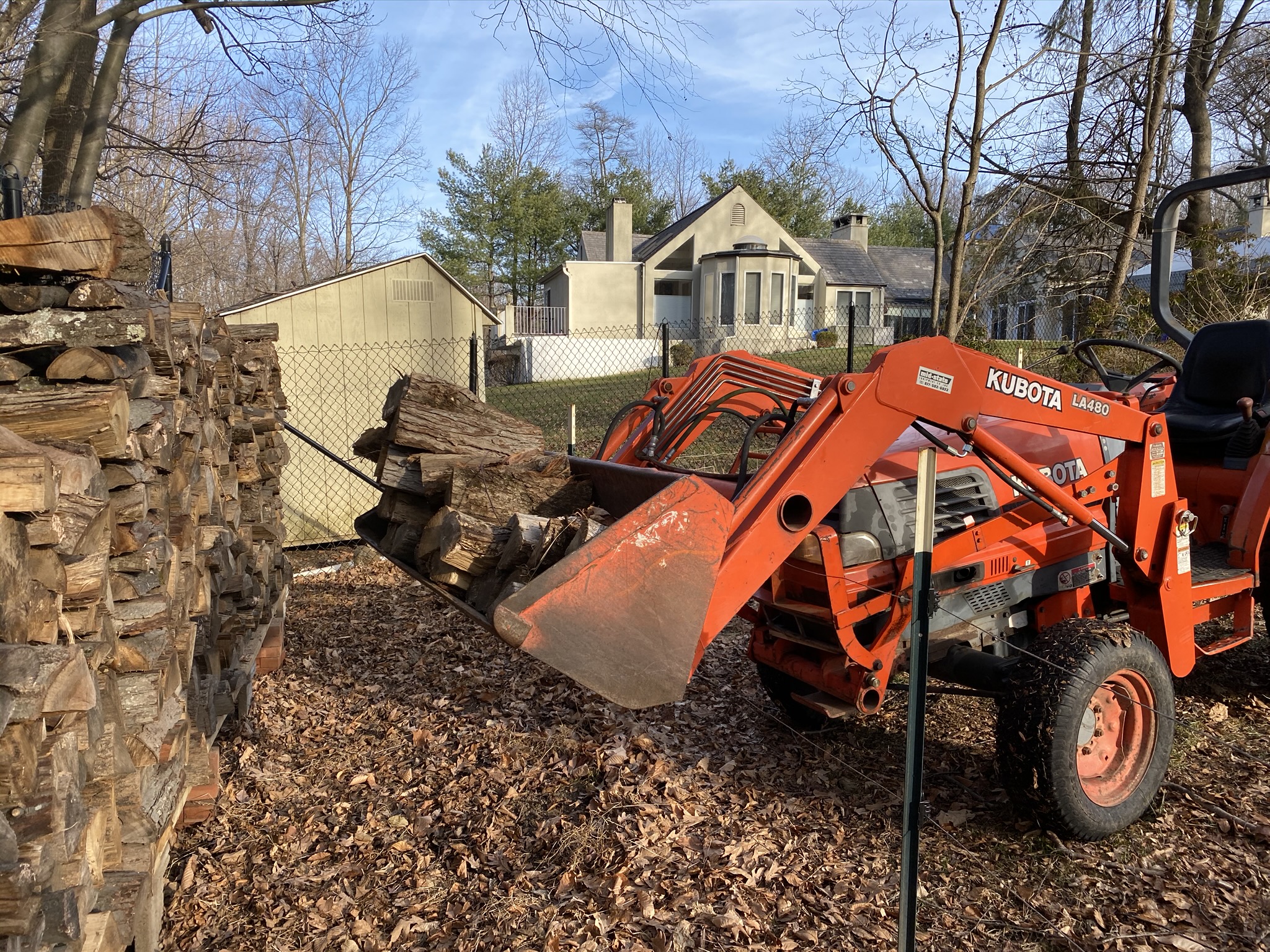

Old post but I owe an update to everyone who contributed. New fenders and all other small parts around them including ROPS were painted. Floor and backhoe also painted.
baby steps but the 30 years old baby is starting to look young again.

Good job (y) If you could give a quick sinopous of what type of paint and process you used it might be helpful to the next guy.🍻
