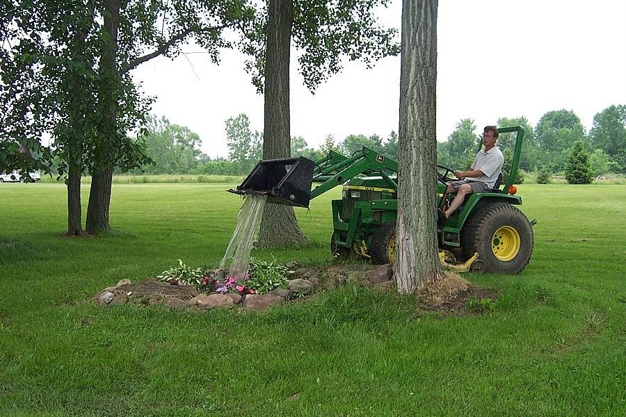

Good memory. That's exactly what happened. Got about 1/4 of a bucket on the first one then left it up to Ma nature.
Sorta like this?
That picture came off TBN years ago...I don't recall who the owner is. That's a 70 loader, so the machine is pre-2003.
