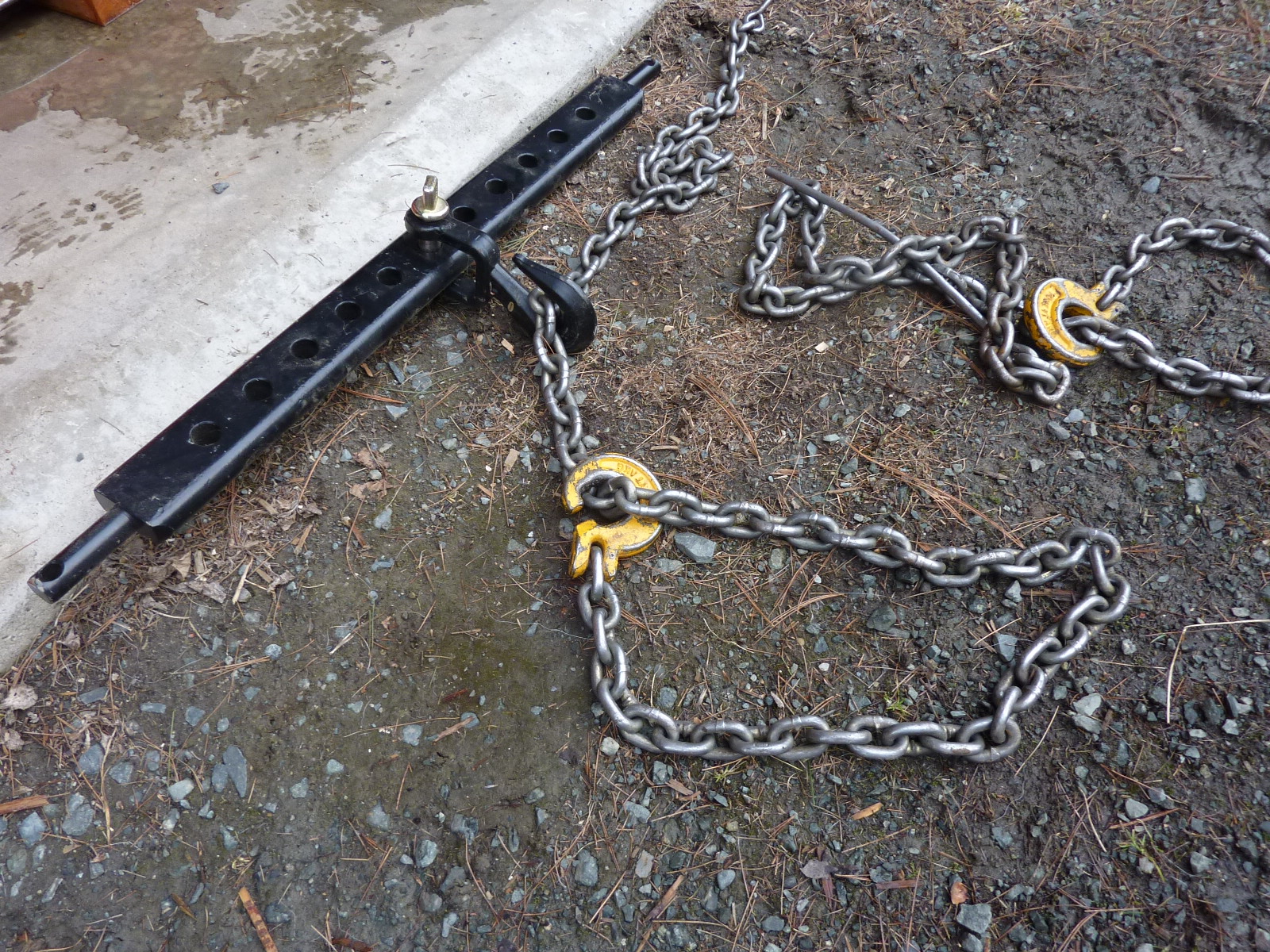

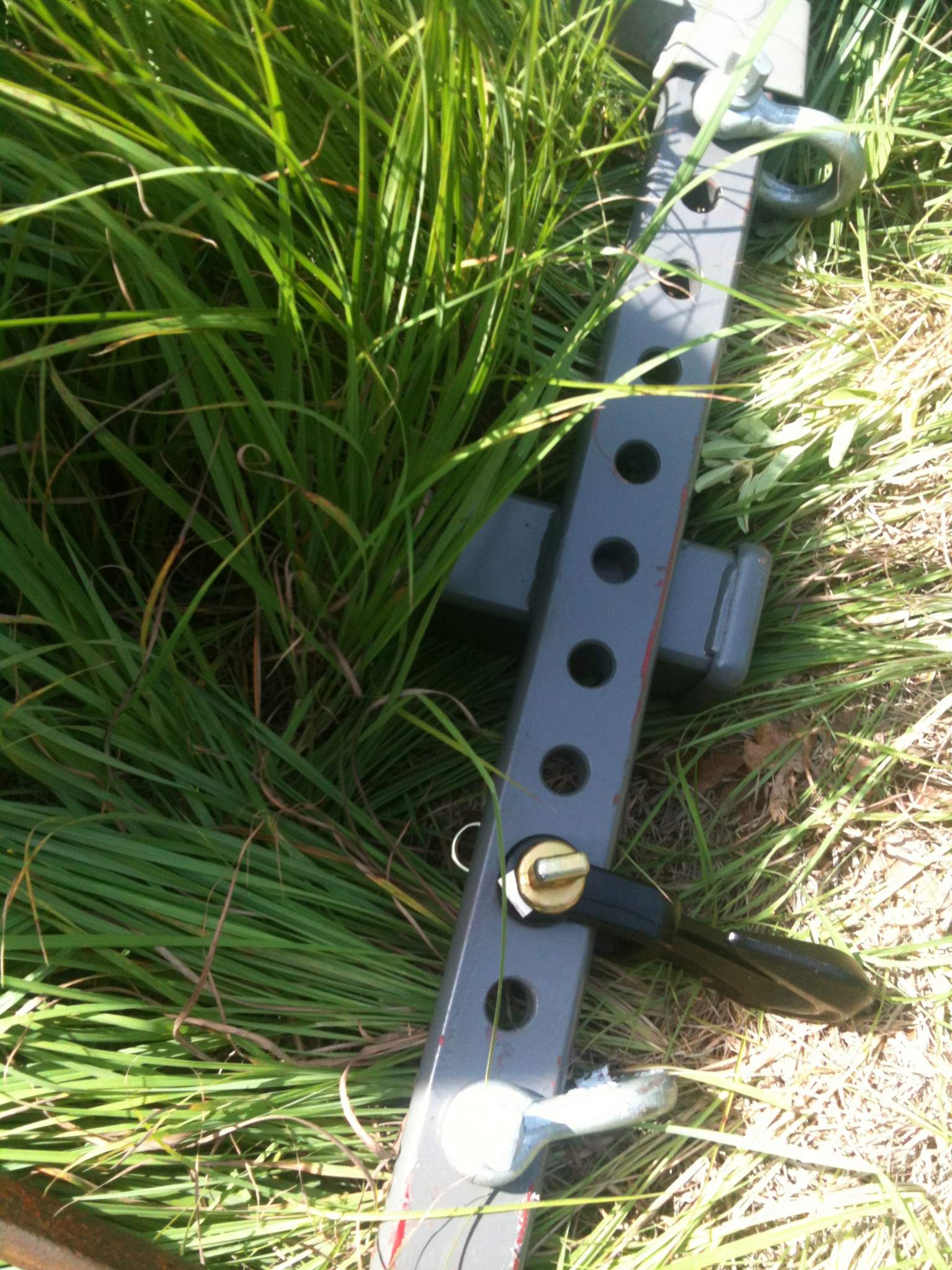

I run a Kubota M7040 on my place. Looking for ideas for tow bar attachments to pull stumps and logs with. Something to hook a chain too. Can I just attach a d-ring or are there other attachments to consider? Is there a good on line store to shop for these things
   / Tow Bar #2
There are lots of ways. A shackle or tractor hook on the draw bar. I also use a cross draw bar and a tractor hook so I can lift for easier dragging. It is about the simplest thing. There are also lots of stuff you can buy or make as I am sure you will see.
Follow the main rules: Be careful. Go slow. Pay attention. Don't let your front end come off the ground.

I would just pull a log of the tractor drawbar a 3PH draw bar like Gordon pictured. You have to watch with pulling of the 3PH the higher it is the easier the front will come of the ground. For pulling a stump I would pull of the tractor draw bar but you probably won't be able to pull a very big one unless the tree has shallow roots.
If you want to get fancy for pulling logs you can get a grapple or a , skidding plate.

I have to ask where you found the choker hooks ?:thumbsup:
   / Tow Bar #8
As for me, I got mine at a local hardware store. I think the feed store also has them.
   / Tow Bar #9
Baileys sells choker hooks, as well as Northern Tool (online, not sure about stores). Usually $10-15. You can also use a large open chain hook, which will cost a lot less and be more commonly found.
