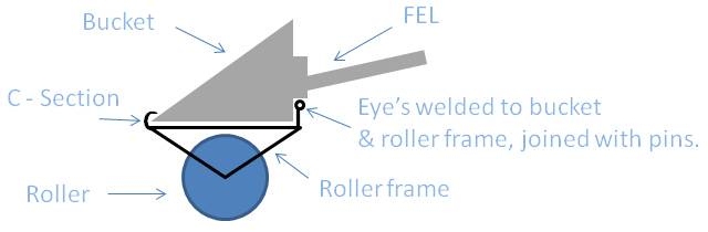

I have a tow behind roller that is 5 feet wide. I want your guys opinion on modifying it so instead of filling it for weight I can attach it to my FEL and push down on it.
The biggest reason I want to do this is lack of turn around room when I am rolling roads
What do you think let me have it both barrels:p

An interesting idea, which I have seen done before on a Case 5140 Maxxum which was used to compact trial silage clamps which were only the width of the tractor...
As I remember thy had added lugs to the back of the bucket, just below where the bucket joined to the FEL, and also to the back of the roller frame. At the other end of the roller frame (which was the same length as the bucket) there was a c-section piece of steel.
To attach the roller, the bucket was driven into the c-section, and then pins plaved through the lugs on the back of the roller frame & bucket.
The benefit of this design is that you can fill the loader bucket to add weight, before attaching the roller. However I do share some of the other concerns previously posted - you will not have much steering, and if you do the roller will scrub. Also as said by Beenthere you would be better to buy or build a proper packer using old aircraft wheels or similar if using it to compact roads...
Here is a very basic diagram of what I mean :laughing:

Moored4 - My intention was to slide it onto my forks I can actually pick up the front of my tractor with the tips. As my tractor weighs in at 16000 pounds with the loader I could apply a reasonable amout of weight up front.

Boggen - I like the idea of picking it up with thr forks when full that might be the best of both worlds, use its own weight to roll may still get a bit of scuffing but could be a great idea.
