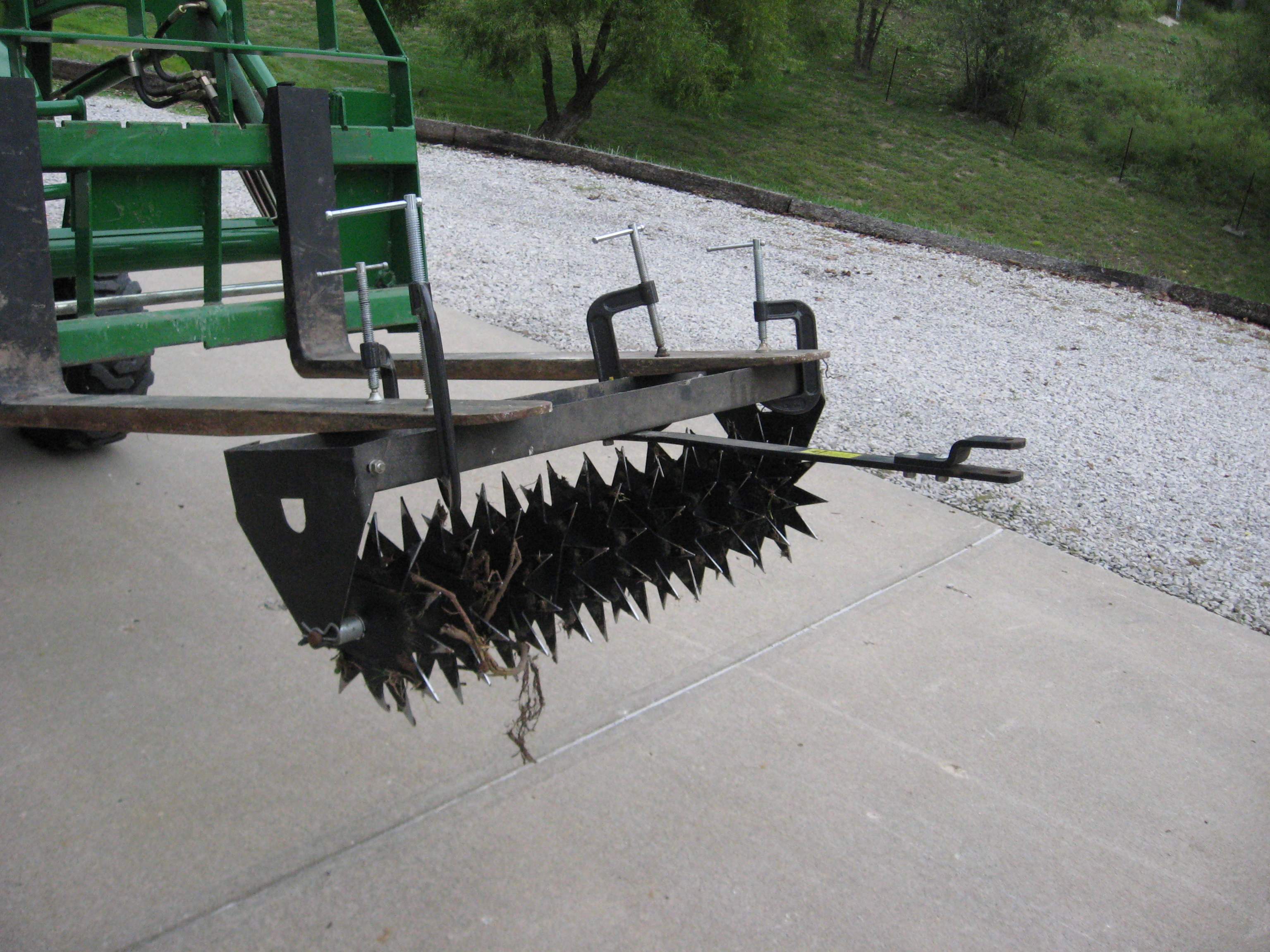

I did something like that with my tow-behind aerator. It worked, but the aerator didn't like it very much. It was a little hard to steer, but it did the job.
