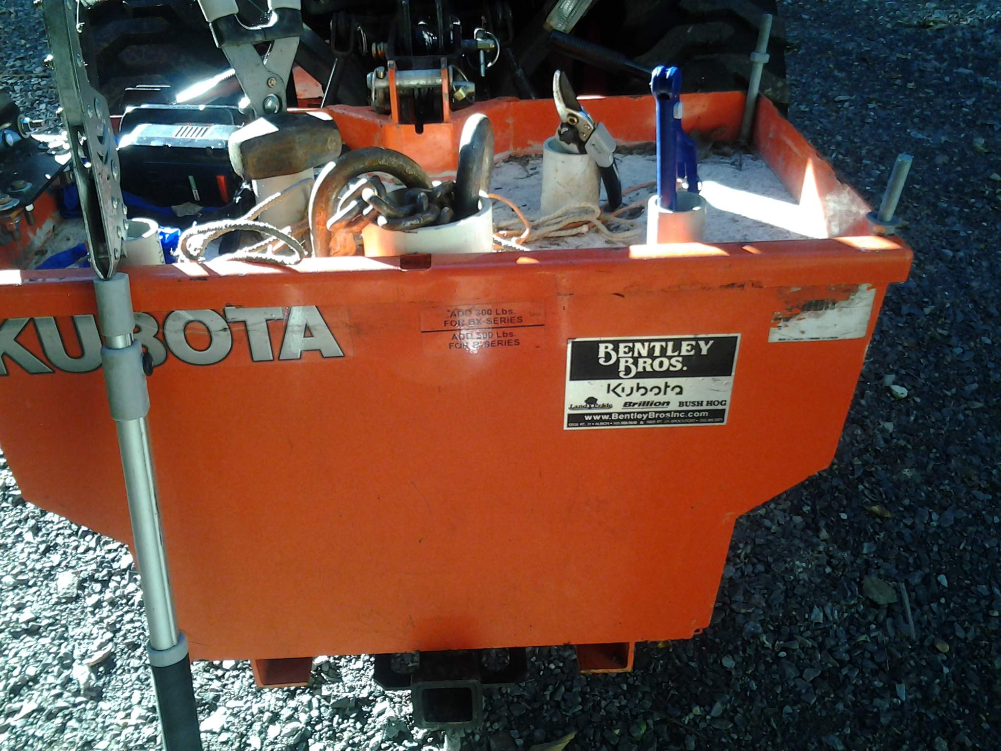

Can you further reference or show what hitches you refer to? Thanks.
Here is what I'm using: 5000 lb. Step Bumper Receiver
I tried to attach a picture of my ballast box with the hitch on it, but my tablet browser is not being cooperative.
Thomas
PS: This is what I mean...
You have to look really close at the bottom center of the BB.
