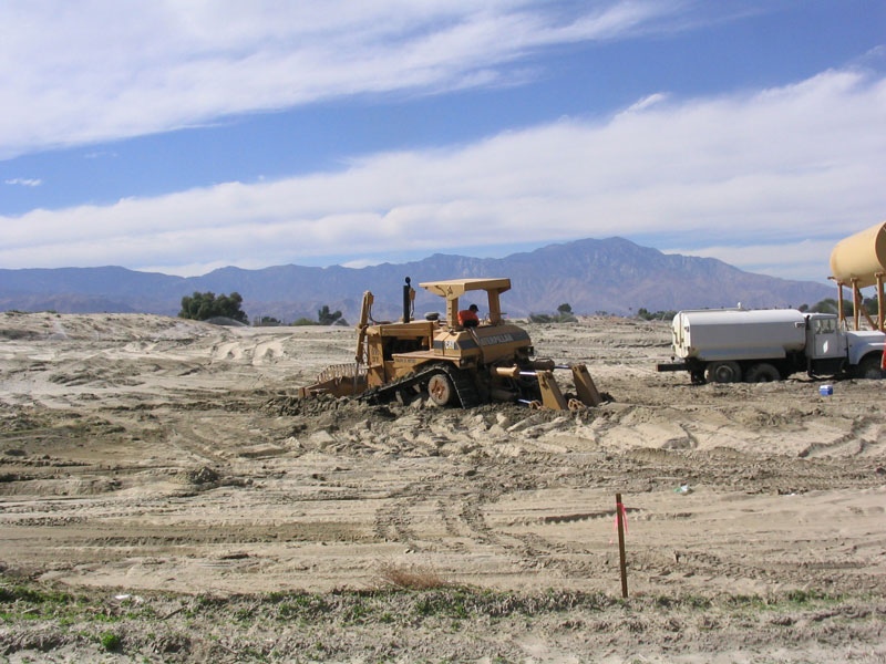

Here's a picture from one of my current projects. That's a 49 ton D9 that's stuck about 6' deep. It was going to push out the water truck which you will notice is also stuck. They brought in a second one to pull it out and it got stuck, a third and it got stuck. This was an area of saturated silty sand that acted like quick sand. They finally got them out with the help of a large excavator in effect "trenching them out".
The bottom line is that the ONLY thing that graders use to pull equipment out is wire rope.

Nice picture.:D
Lugging 1 1/2 in. slings around ain't no fun!:D:D
I saw this EXACT thing happen on a plantation in Charleston, SC where I used to hunt when I was a kid. The first one had only the cab above the mud. The third one had some hood and cab showing. The third one was buried up to the treads. This was in November. They did not get them out until the next summer when it dried out. All three had massive winches on the back. Why they didn't use them I have no idea.
