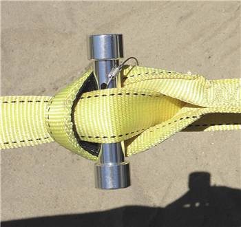

Has anyone had any experience with one of these? I have been looking at them for a few years and cant figure out how to rig it with out it slipping.

Here is a copy of the instructions I found on the net. I could see simply lacing it through the tow hook and then laying the flat part of the strap through the loop. Place the bone in and as the strap tightens up it will be held in place but **** you could do that with a large wrench, tire iron, piece of round bar, ect. It seems the slit in the bone comes into play but I can not find pictures to support that.
Anyway here are the instructions I found.
Once a tow strap is laced through the tow hook, simply thread the strap through the middle slot of the cinch bone then situate the cinch bone between the end loop and flat portion of the strap to create a firm connection and tie a knot. This keeps the strap from slipping. After use, untie and slip off. No more impossible knots or cutting pieces off of your straps! It is recommended to use two cinch bones, one for each end of strap for reinforcement.

Here is the picture.

I had seen that pic but like I said I don't think that would work. Seems like it would just slip. In that pic it does not look like its been laced through the slit in the bone.

It would make it so that you can un do them if you slip the loop over one then the tail through the you male a square not and once pulled tight it is hard to undo don' ask how I know.
to use it push loop through the other loop and put the bone in 1st loop an pull back tight against the 2nd loop.
At fire school many years ago they told us t use a pick ax andle to do the same thing you can loop a strap too in this way.

We use a rolled up towell between the two straps after the eyes have been linked together . Those metal things are lethal when the strap breaks . The towell stops the knot becoming tight , a rolled up newspaper or magazine will also do . When you are finished simply remove the towell and seperate the straps .
