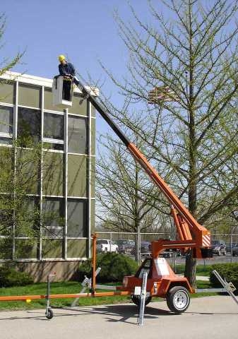

I own a Nifty Lift TM34T. Honda power and telescoping boom. Very nice unit and fairly stable at max. height and/or reach. Does not have auto level but lets you know if not setup properly. Use it to trim trees, paint, change yard light bulbs and other misc stuff.
Tow it around my property with my compact tractor.

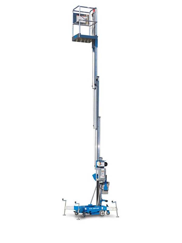

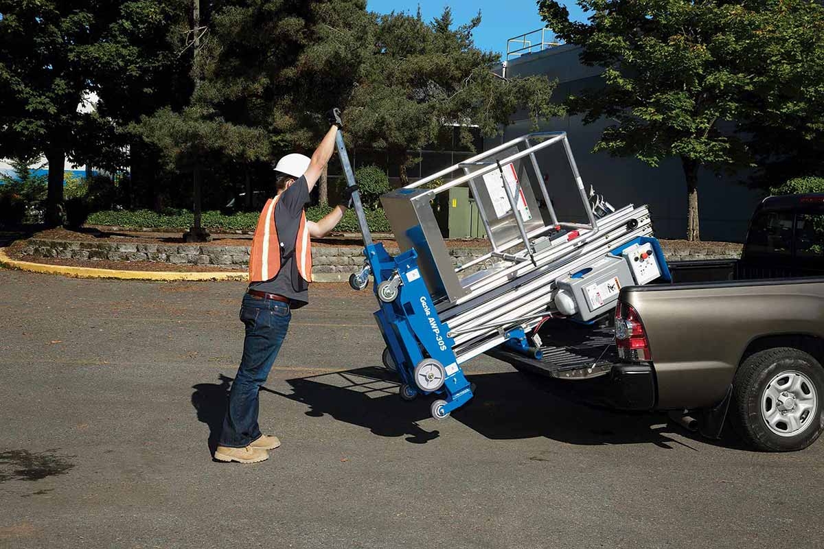

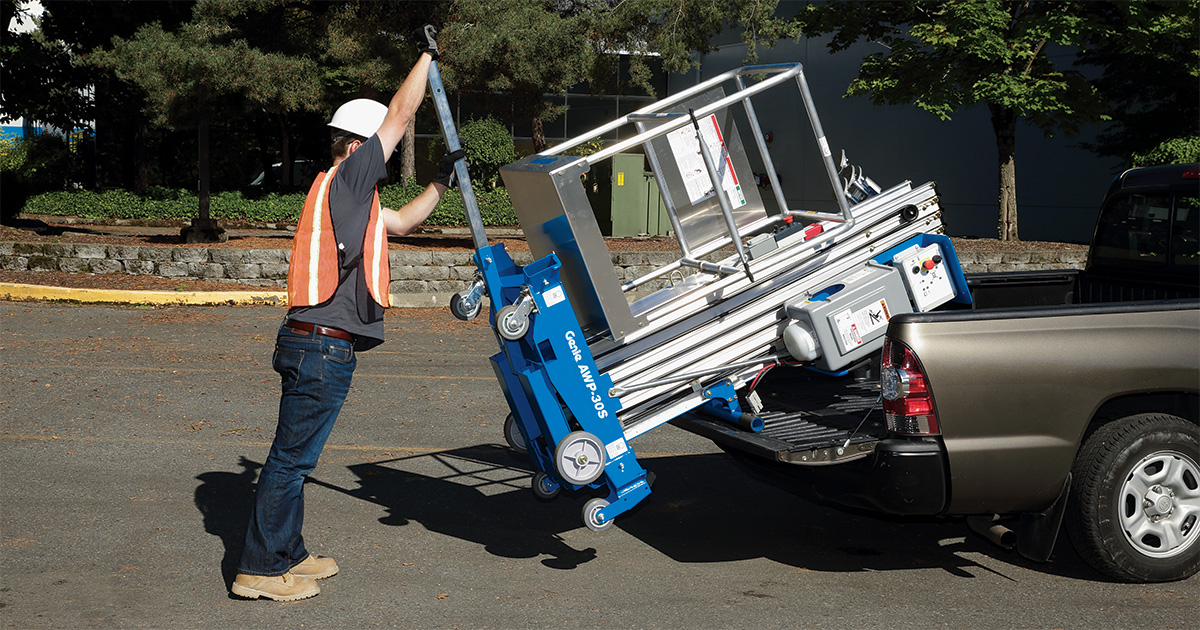

This isn't what you're looking for, but it's a compromise for my needs:
It's strictly up & down with no articulation. It loads in the bed of a pickup and I use it both indoors & out, around the property. When not in use, I store it under my deck and use it as an elevator.
Two or three times per year, I rent a Unilift 538 from a local rental yard.
I considered buying the Unilift, but storing it is an issue. It's too big to keep in the barn and the weather takes it's toll on the machine when stored outside.
I use the straight up & down Genie far more than an articulating model, and find it's cheaper & more convenient to rent one when needed.
Of course, this all depends on what you need to do and how often you need to do it.
