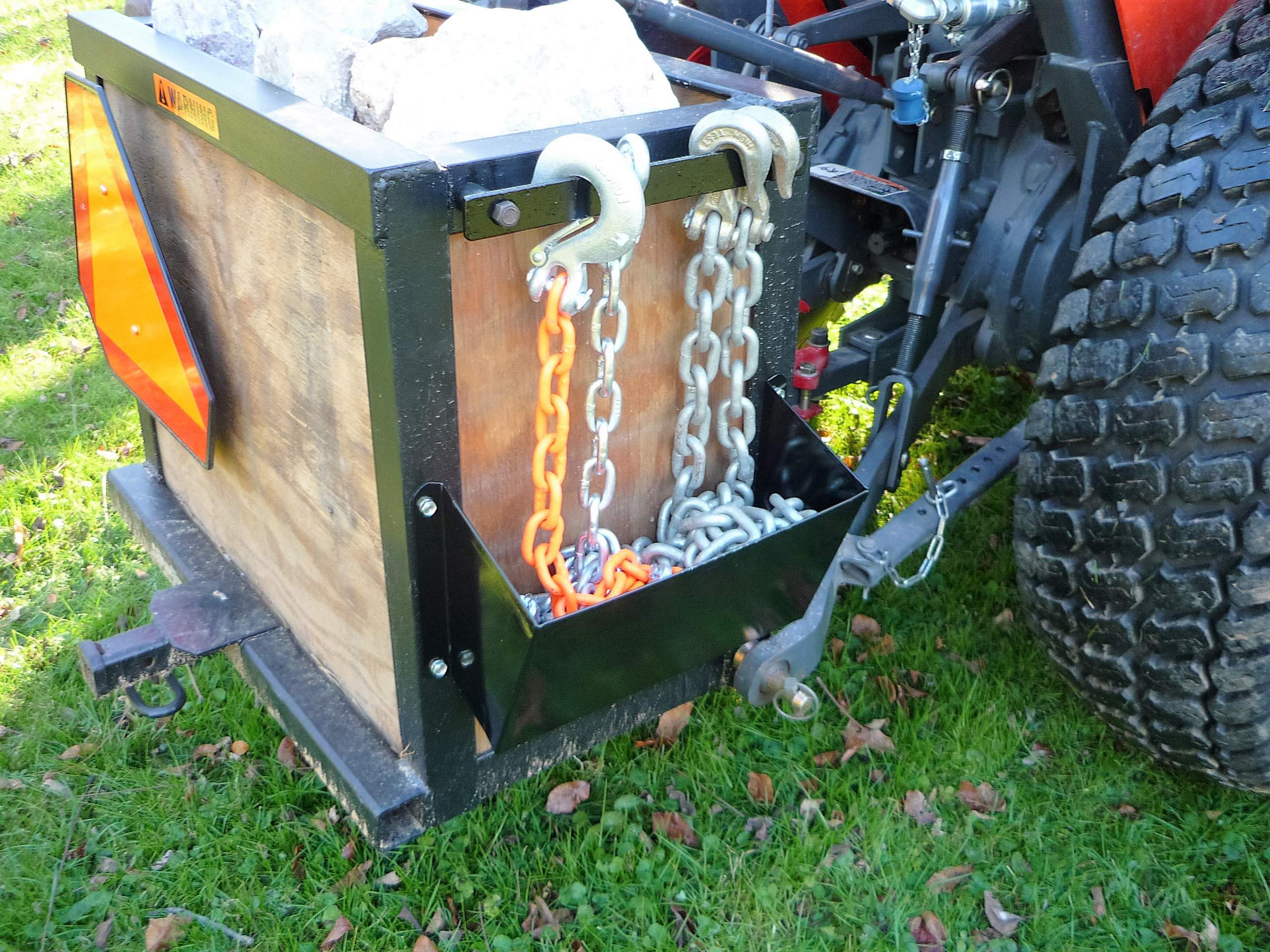

   / Towbar on counterweight on BX #6
varmint - got any specs, plans, link to a build thread for that box??? Looks kinda line what I was sorta imagining I was gonna build... so I’d love to steal / borrow your hard work and jumpstart mine! ;)
   / Towbar on counterweight on BX #7
Fishpick, I just bought a 20' length of 2 x 2 x 1/4 steel angle, had them cut it into lenths for 50 cents a cut (perfect, carefully measured and using an industrial metal saw- much better than my messing with a hacksaw or whatever!) and some scrap 2 x 2 tubes (for the top, where the top link pins) AND, most importantly in your case, part of an old trailer hitch tube with the ends cut off a buddy gave me. The box walls are just some treated 1/2" plywood scraps I had. Since the tractor lives in a barn, I figure they will last longer than me. Rip rap rock gives me the weight, and it's easy to add or remove. I did buy the pins. I can measure it, if you want. I made it as wide as my 3 point arms would go, and in hindsight, I think I would have made it a bit narrower, just to make removal easier when it has all the rock in it. I may even have the steel supplier's cut list filed away?
   / Towbar on counterweight on BX #8
I like that box!
Edit: You posted before me!
I got some fresh angle iron to make something like that too!
   / Towbar on counterweight on BX #9
Fishpick, I just bought a 20' length of 2 x 2 x 1/4 steel angle, had them cut it into lenths for 50 cents a cut (perfect, carefully measured and using an industrial metal saw- much better than my messing with a hacksaw or whatever!) and some scrap 2 x 2 tubes (for the top, where the top link pins) AND, most importantly in your case, part of an old trailer hitch tube with the ends cut off a buddy gave me. The box walls are just some treated 1/2" plywood scraps I had. Since the tractor lives in a barn, I figure they will last longer than me. Rip rap rock gives me the weight, and it's easy to add or remove. I did buy the pins. I can measure it, if you want. I made it as wide as my 3 point arms would go, and in hindsight, I think I would have made it a bit narrower, just to make removal easier when it has all the rock in it. I may even have the steel supplier's cut list filed away? Used my little Lincoln wire welder, which took a while, since I wanted penetrating welds, and it was mostly maxed out. I had two more photos in my cache. The chain rails came later, (very handy when I am hauling firewood logs out of the woods) and the idea of implement tubes is a good one, too.
