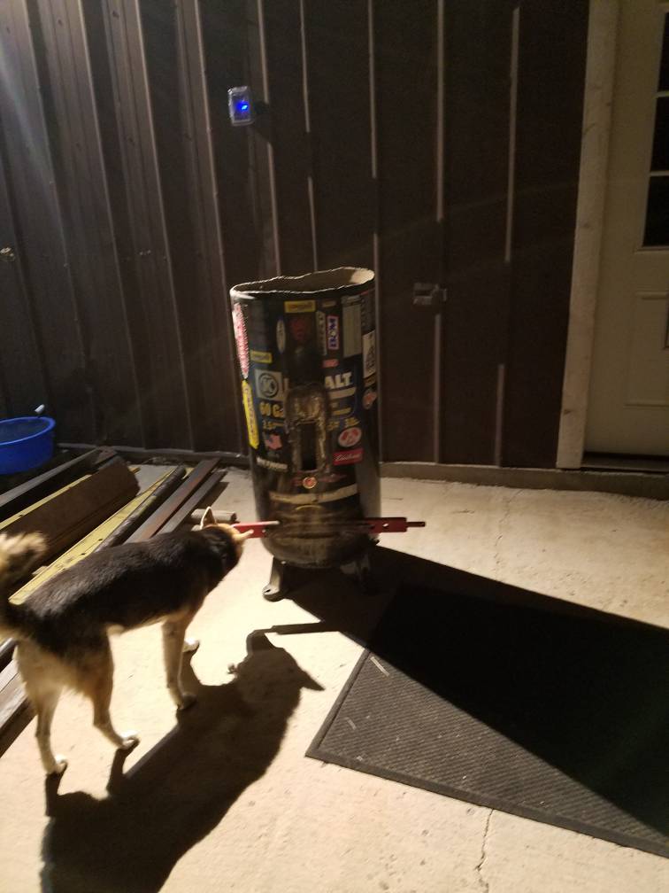

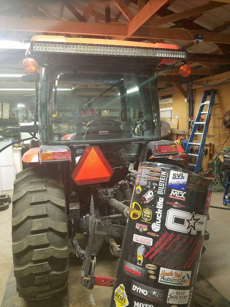

My air compressor pissed me off by leaking... I took revenge with a plasma cutter. Welded in a 3pt drawbar into a notch I cut for the drawbar & also cut another one for the top hook. Filled it with scrap break disks & what not then a few bags of cement. Top half just has dirt in it. Could weld a hitch on, but I usually just use a ball in the end of one if my pallet forks.
Blizzard out so not likely to get any better photos. 20170317_191441.jpg20160828_220733.jpg
