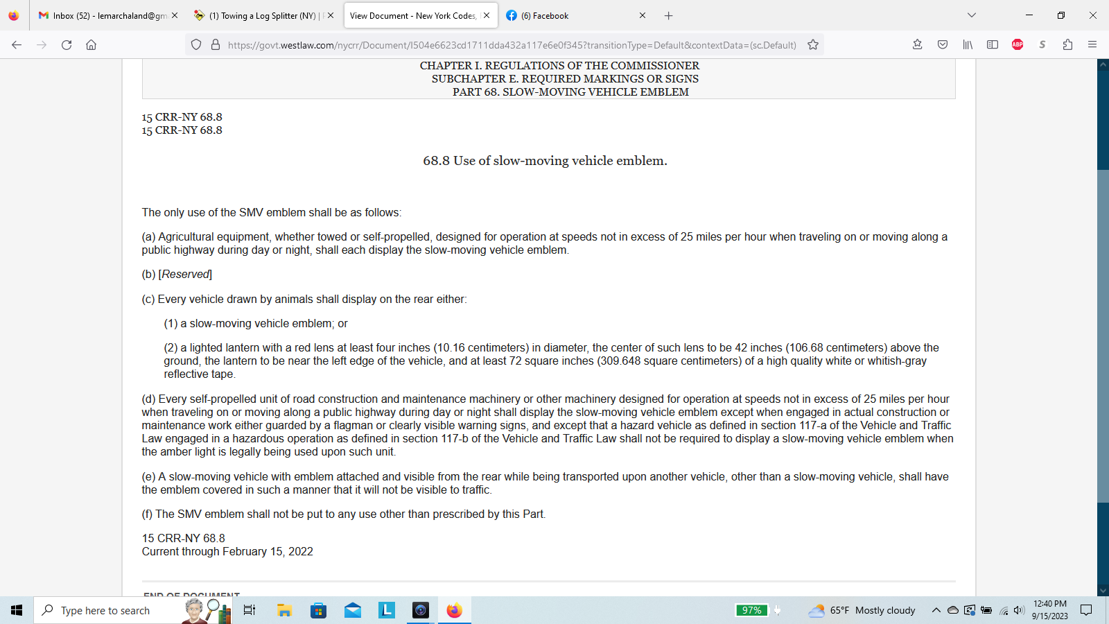

You shouldn't get a ticket for towing a log splitter in your state. It does not require a license plate or lights . It does require a slow moving vehicle orange triangle.( if you don't have the triangle, someone hits you your liable, if you have one and they hit you, they are liable) Towing on a highway or freeway can be an issue if you cannot maintain the minimum speed limit. Depending on the width of the axle, type of tires and wheel bearings usually limits towing speed to 45 mph or less. Here in the California valley there are towed implements and tractors on the highways between farms pretty often. I just towed a log splitter 20 miles. 48" wide axle with 12" highway rated tires and wheels/bearings. it has no suspension, 50 mph was as fast as I felt comfortable towing it.
NO, do NOT use a SMV triangle.
Uses other then on vehicles desighned to be slow moving vehicles is illegal.
Depending on the state the design limit is usually 25 or 36 mph.

I can imagine a couple "downers". It's a small unit - without lights, reflectors, etc - pretty dangerous item to be towing down any highway. And then there are the legal requirements.
Most firewood splitters are narrow enough that the vehicle lights should be visible around them.
One can purchase magnetic lights if one wishes.
Oregon allows any trailer with a "loaded weight" less than 1,800 lbs to be unlicensed, but it varies by state.
If you're talking about any modern box store log splitter with little Mickey Mouse wheels and tires labled "45 mph maximum speed",
I'm not sure what tires you're referring to. If it has wheelbarrow tires on it, then it is just for pulling around the yard.
I have a little "Haulin" utility trailer that came with 5.70 x 8 tires. That thing is a BEAST. Although, I have had to do a couple of upgrades over the years. I've towed it coast to coast.
