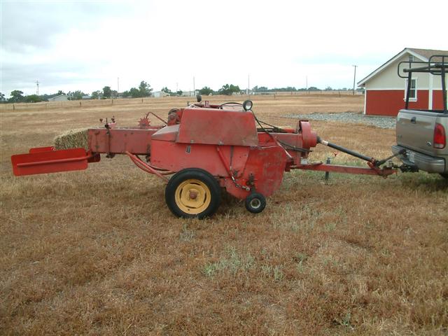

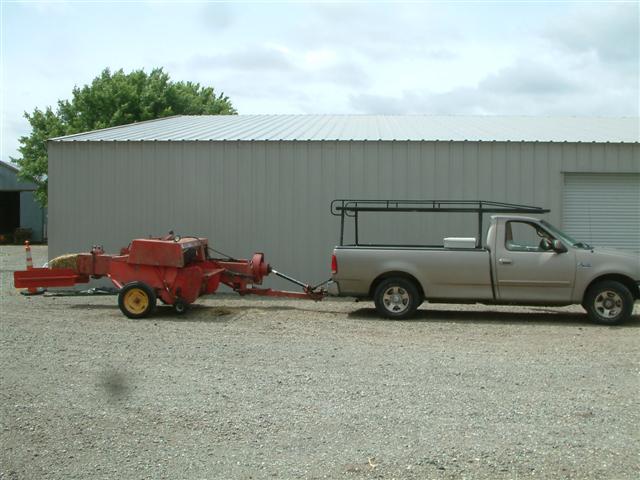

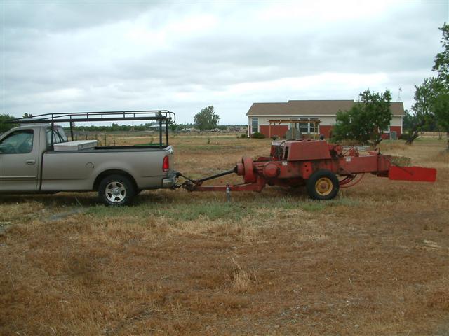

My MF124 is a small square baler--100" wide (8ft 4in), weighs 3060 lb, overall length is 16'2".
You probably could back it onto a 104" wide over-the-wheels flatbed trailer with a few inches to spare side-to-side (I couldn't do it--I'd have that baler slipping off the deck for sure--but someone with more experience and a steadier hand could load it on a flatbed without doubt) .
I towed that 124 home from the Seller's place behind my F150 (about 30 miles on the back roads, speed 25 mph tops).
The baler was in excellent shape (the Seller baled on his 30 acres the day before I bought it), the rubber looked good and he said he thought the wheel bearings were OK. But I took it easy anyway.
I've seen balers like mine behind pickups going down Hwy 99 (2 lanes) at 50 mph or so several times.
Be sure to swing the tongue/hitch in the transport position. Good luck with your purchase.
