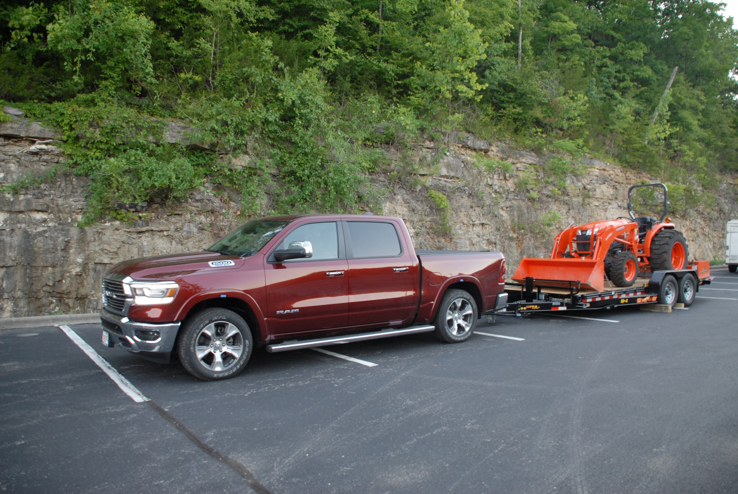

Yes, I agree except it is more than 2" on most pickup trucks and most loads. Depends on load of course ! In my experience with a typical 4WD pickup (springs-wise) and a GVWR load [trailer and what's on it combined] of around 8 to 10K lbs you want about 5 or 6" of drop in the back of the truck. The more total towed weight the more tongue weight you need. There are guidelines for % of the load that tongue weight should be (undoubtedly mentioned somewhere in the 109 posts above) but I never look at it that way. Like you I eyeball it and adjust to suit.
Ive always had Ford twin I beam. Can't put so much on rear that it lifts the front. I like a straight axle 4x4 best.

When towing a bumper hitch trailer the rear of the truck should remain at the same level as when unloaded. This is what the wheel alignment is set up for. Adjustments come with the load leveller ( an item required for the heavier loads over 5000 pounds ?? ) or air bags.
Disagree, My F350 and MANY trucks are set up so they are butt high unloaded.

How to set up a load leveller hitch! Procedure indicates as close to level as possible.
Yes, ideally get it level, but many vehicles run butt high unloaded.
