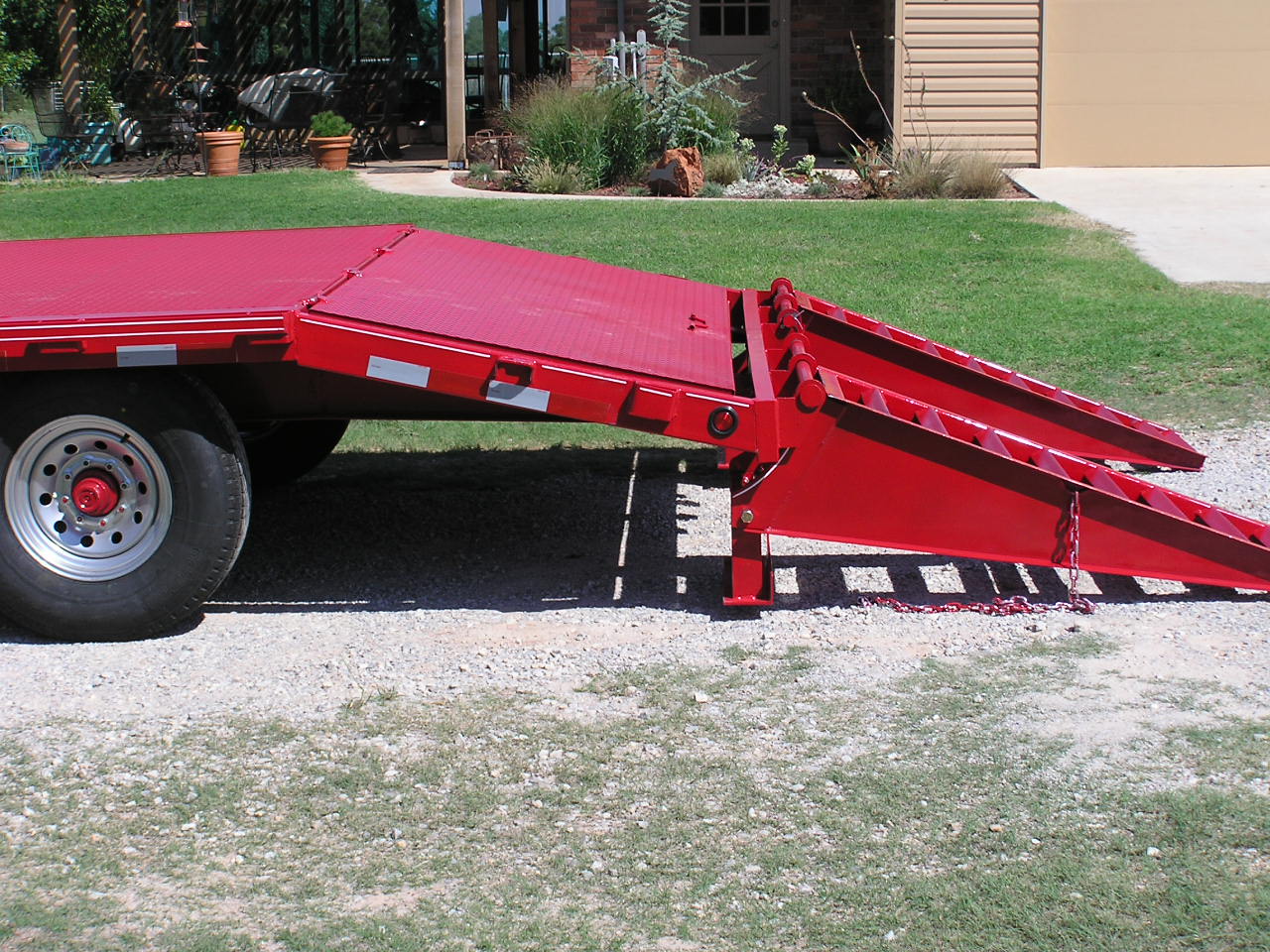

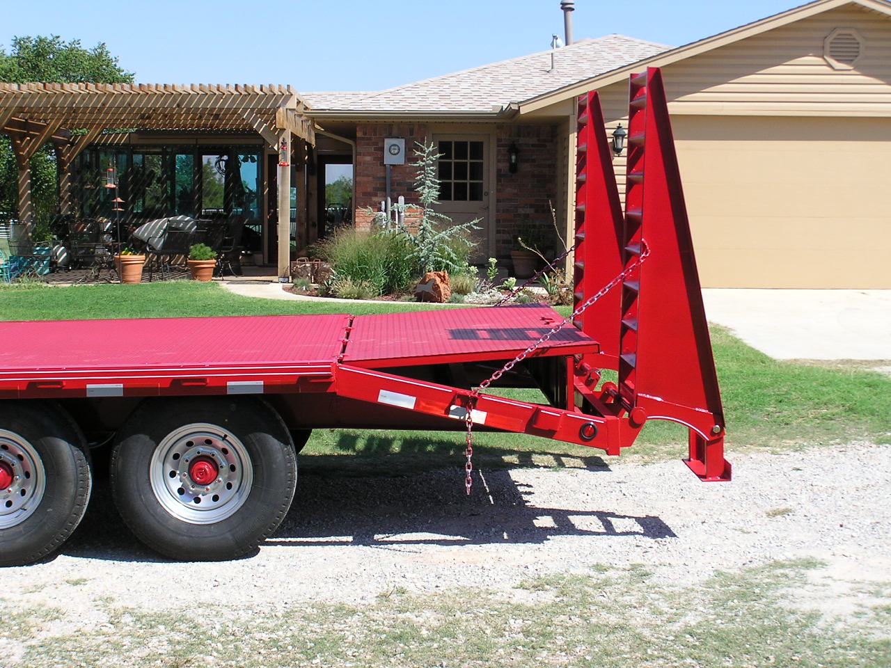

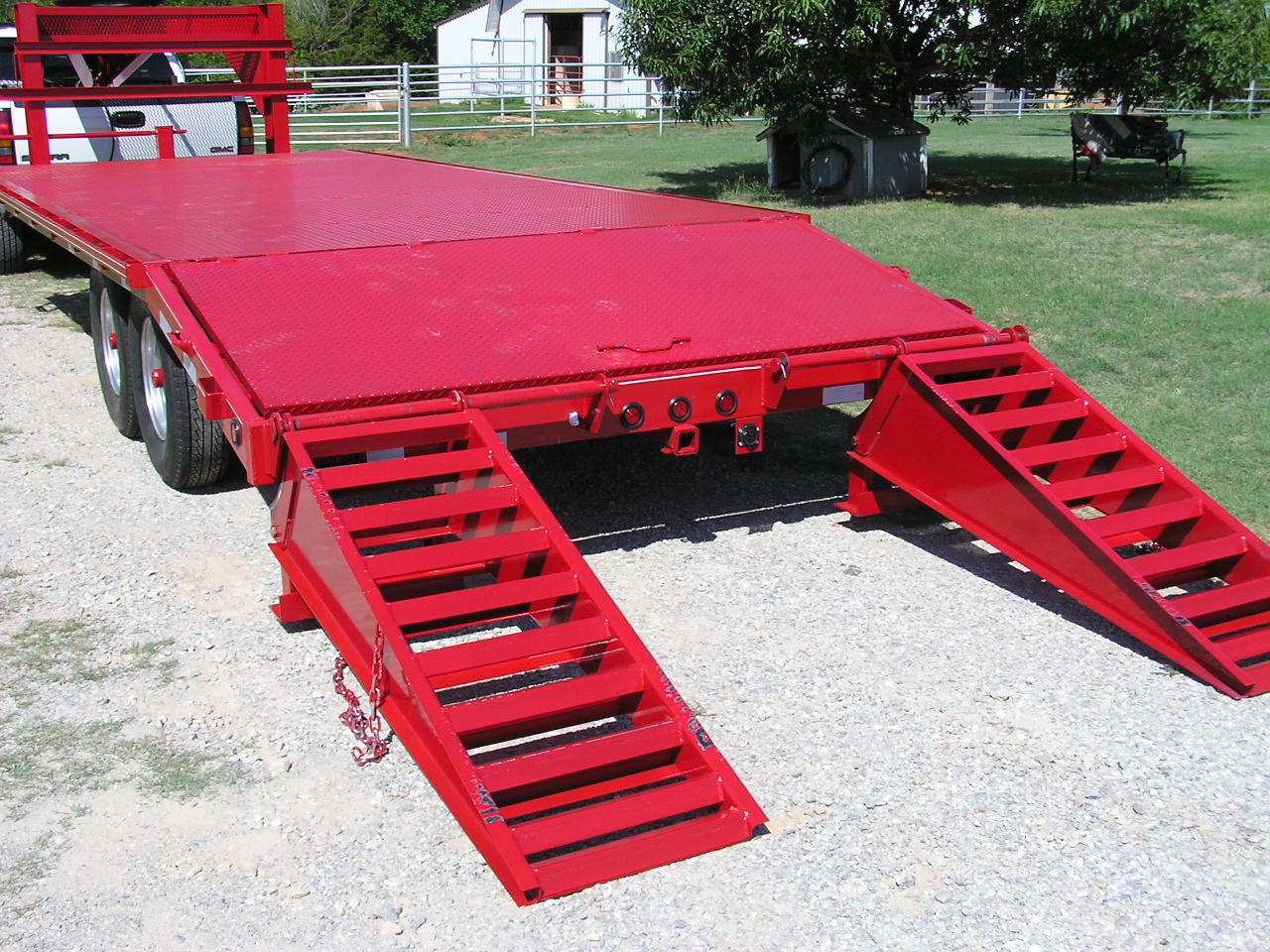

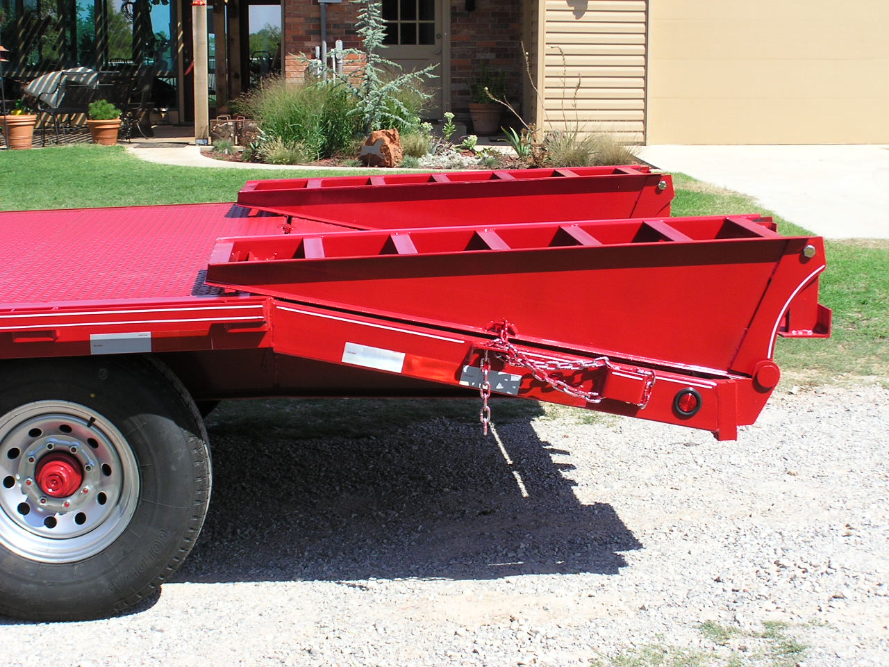

Click this for a thread on ramps: http://www.tractorbynet.com/forums/trailers-transportation/273476-stand-up-slide-ramps.html
This has worked well for me:

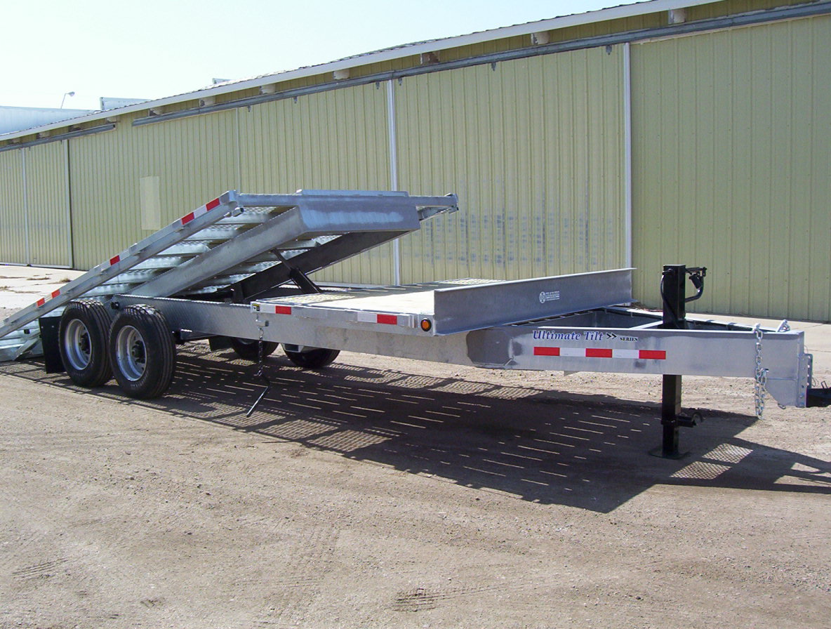

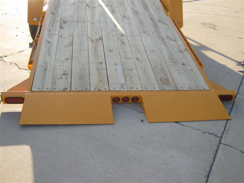

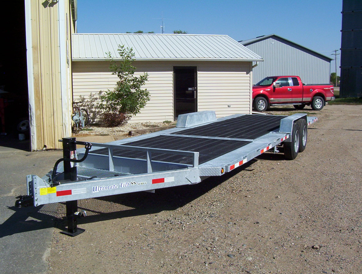

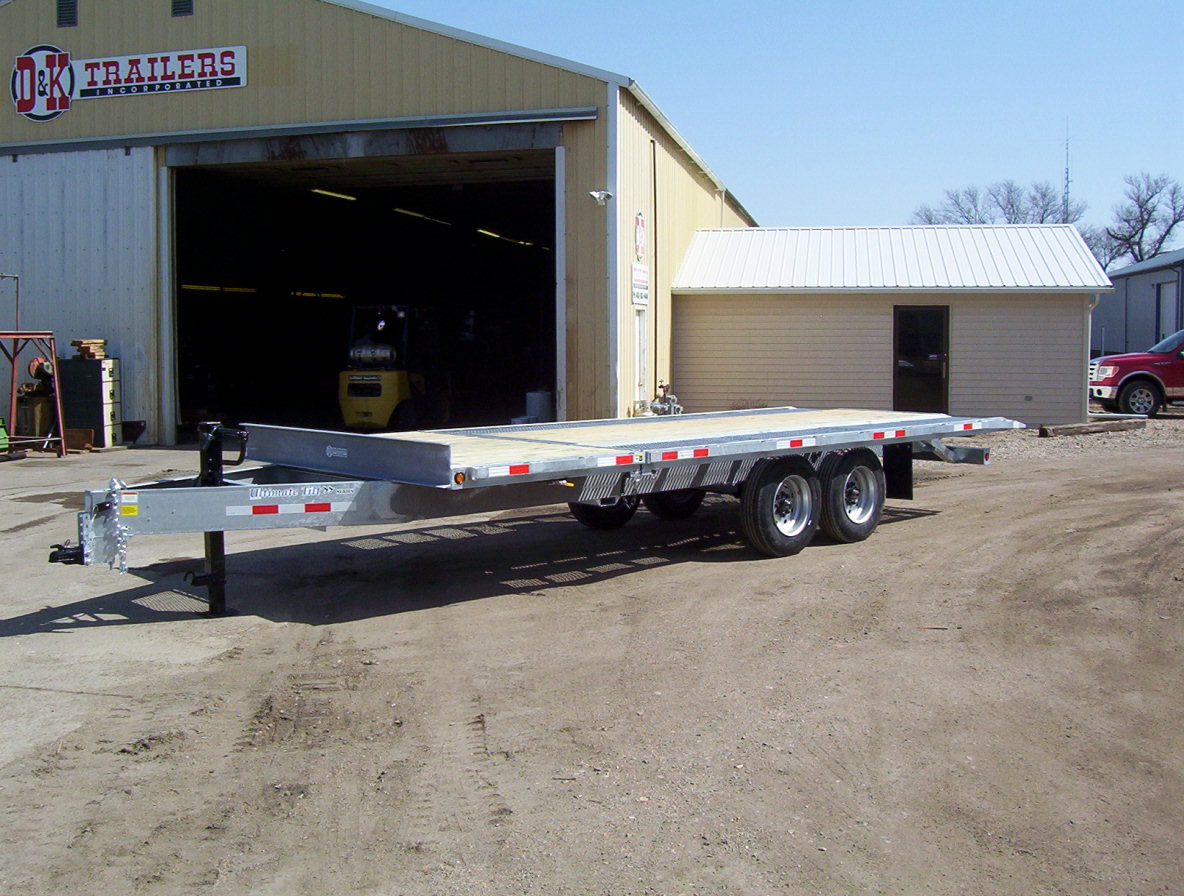

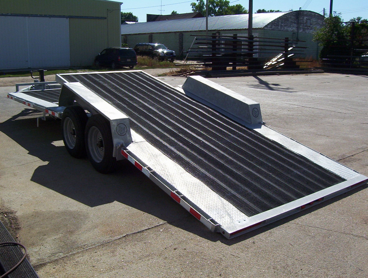

But now I am looking at tilt trailers:

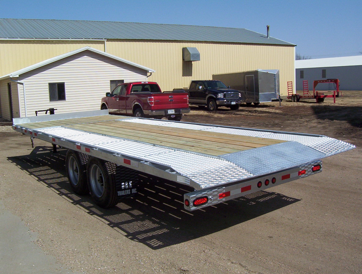

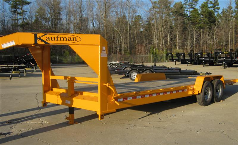

These are HOT DIP Galvanized and can be made with a gooseneck front, this one has the Rumbar deck:
Metal Grating and wood deck:
