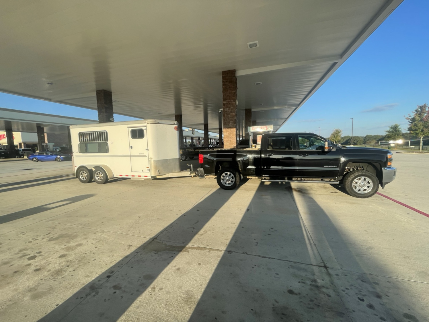

As mentioned in a previous post, we recently purchased a 2015 Chevy 2500 with the 6.0 gas. We currently pull a 3 horse bumper pull trailer when fully loaded comes it just under 7k lbs. ( pic attached). View attachment 763164We have an opportunity to upgrade to a 3 horse gooseneck with small living quarters. We averaged almost 9 mpg on our tow this week with some hilly driving at 70-72 mph. How do these trucks handle gooseneck towing? The only experience we have with gooseneck towing was with our Ram with a Cummins.
I have an older (1999) Ford F250 SD with the 7.3. The max payload of this year is a low 1800 pounds. I understand that with a GN, 25% of the weight of the trailer is on the pickup as opposed to about 16% of a bumper pull trailer. A lot of the LQ I've seen where the dry weight is actually given are at least 5000 pounds for an all aluminum trailer. That doesn't leave me much wiggle room for horses, gas, water, hay, passengers, etc. I love my truck and it's paid for so I continue to look for an all aluminum LQ, 2 horses, with a 4' shortwall. In the meantime I go everywhere in a simple 2 horse stock side bumper pull. I've camped in the back of my current trailer and it's doable. My truck is right on the verge of being a little squatty/nose up with 2 horses in the trailer, so I'm going to go back to using the weight distribution hitch I had for my 1/2 ton truck. Like your rig, my truck loves to visit the gas station.
