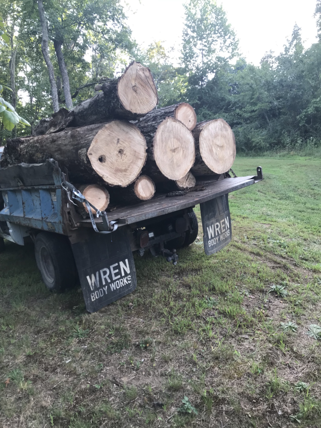

I'm curious about this as well. I've got a '97 F350 SRW (Powerstroke 7.3), and yes it's a 1-ton, but my guess is that a modern F150 can probably out-tow this in every way - tow capacity, braking ability - except raw weight (my truck is about 6,000lbs empty). I was considering the 14k trailer bit as well, until I realized that there's a reason why the 14k is heavier rated than the 10k - it's both longer and heavier built, meaning it's substantially heavier, and the truck's only got so much tow rating that that's eating into.
I’d bet money against this and I’ve got multiple 90s 1 tons if anyone wants to take me up on it. The new 150 might have more HP, but way less springs, less brakes, and less tires. Assuming you didn’t bend the axel or break something else you’ll bust tires before I stop loading my 1 ton. How would the F-150 handle this? If it’s still drivable after that we can hook my GN weighing 21 k to it.
