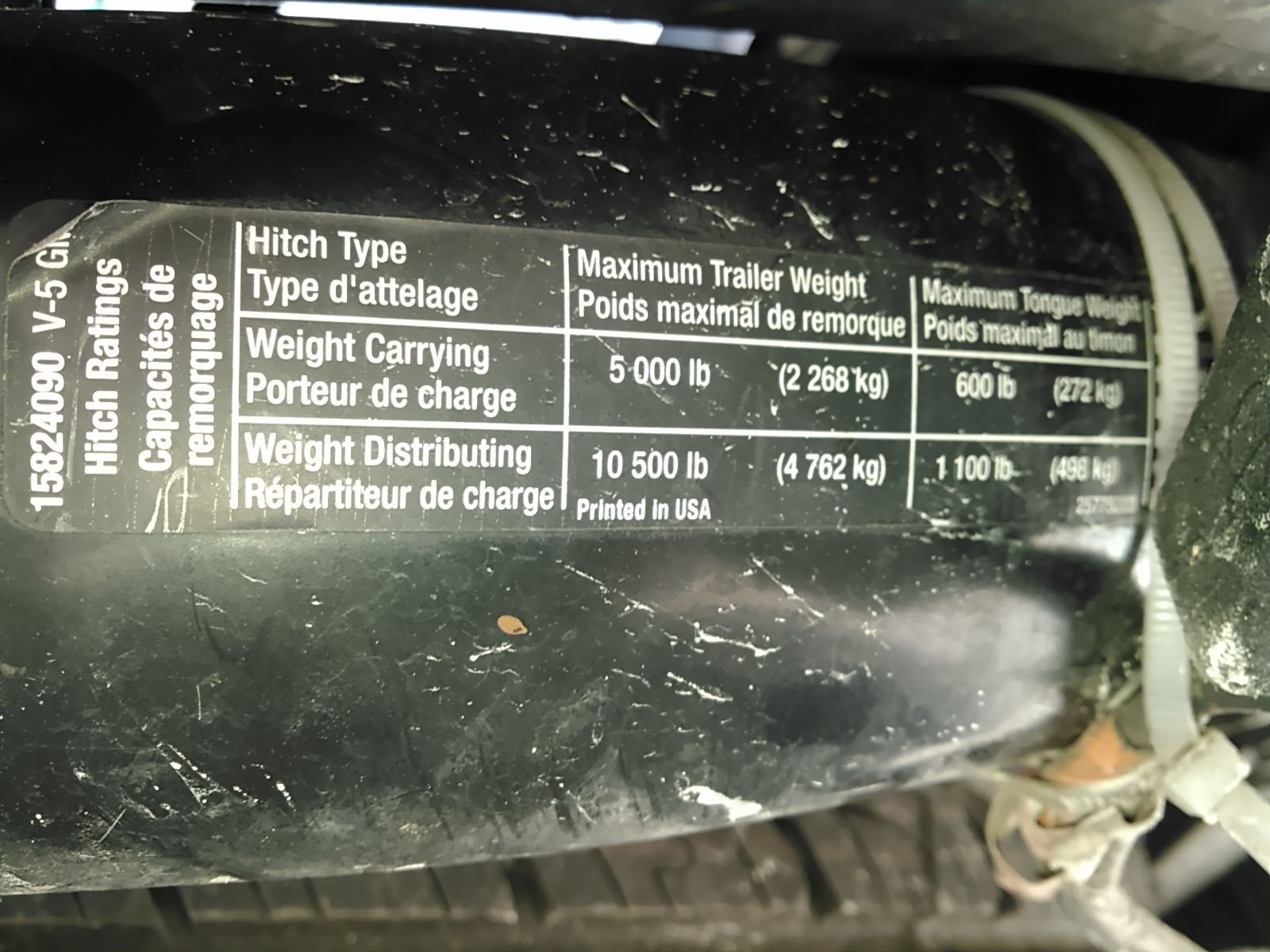

My 2013 Silverado 1500 w/ HD cooling package 5.3 lt. vortec 3.42 rear,ext cab standard box 2wd Z71/Z85 Allstar package, weight is 5100 lbs. w/o wdh 5000 lb towing w/ wdh 9700 lbs.. GCWR 15000.

ClassV hitches come with various size receivers and has no bearing on if WDH is required or not. How the hitch mounts to the truck's frame has more to do with it than anything. Any hitch not using weight distribution puts all of the weight on the rearmost fasteners. Weight distribution changes the leverage on the hitch, which transfers more of the trailer weight forward and off the rearmost fasteners. A lot of the ClassIII and ClassIV hitches simply mount to the bottom of the framerails. Most ClassV hitches also have structure that wraps around the outer sides of the framerail with additional attachment points.
