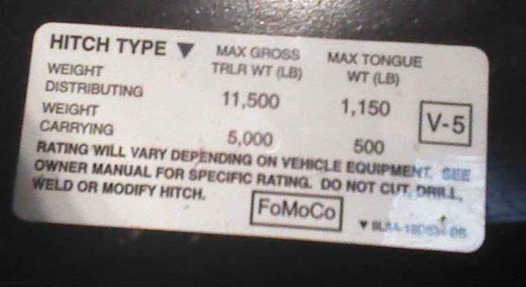

Just fyi, you will be over your hitch limit without a weight distribution hitch. They make a system that works with surge brakes. I have the same truck and the weight won't be a problem.
Which is confirmed by the sticker on the underside of the hitch.
This makes no sense to me as the hitch and bolts connecting the hitch to the vehicle still have to support the trailer and the load on the trailer. If it can't, the hitch is going to fail no matter if you have a WD system or not. I'm sure my thought process is wrong though. I've been looking at WD systems that are compatible with surge brakes. I just don't know if one will get here before I leave. So I might have to have it shipped to ND.
<img src="http://www.tractorbynet.com/forums/attachment.php?attachmentid=347076"/>
Greg
You are correct, the hitch bolts do still support the tongue of the trailer. Without a WD setup, only the rearmost bolts support the entire weight as well as only the rear of the truck frame. With a WD setup, the spring bars torque the reciever and put load on the forward bolts as well. Not saying this is definitely the reason but all I can think of. Obviously the sticker is on the hitch so that makes me think that is what it is rating and not the truck. Having a WD hitch will make it safer since the front wheels of the truck will get some extra weight for braking and handling.

Put a Reese pro series WDH with 10K bars, a stabilizer if you have time to screw it to the trailer (they cost like $35) give it 10% tongue and you'll forget it's there after about a half hour. It'll remind you on stops and starts but otherwise the truck tows really well. ECO SCREW tows really nicely, low rpm, the tow-haul mode and integrated controller are really good.
