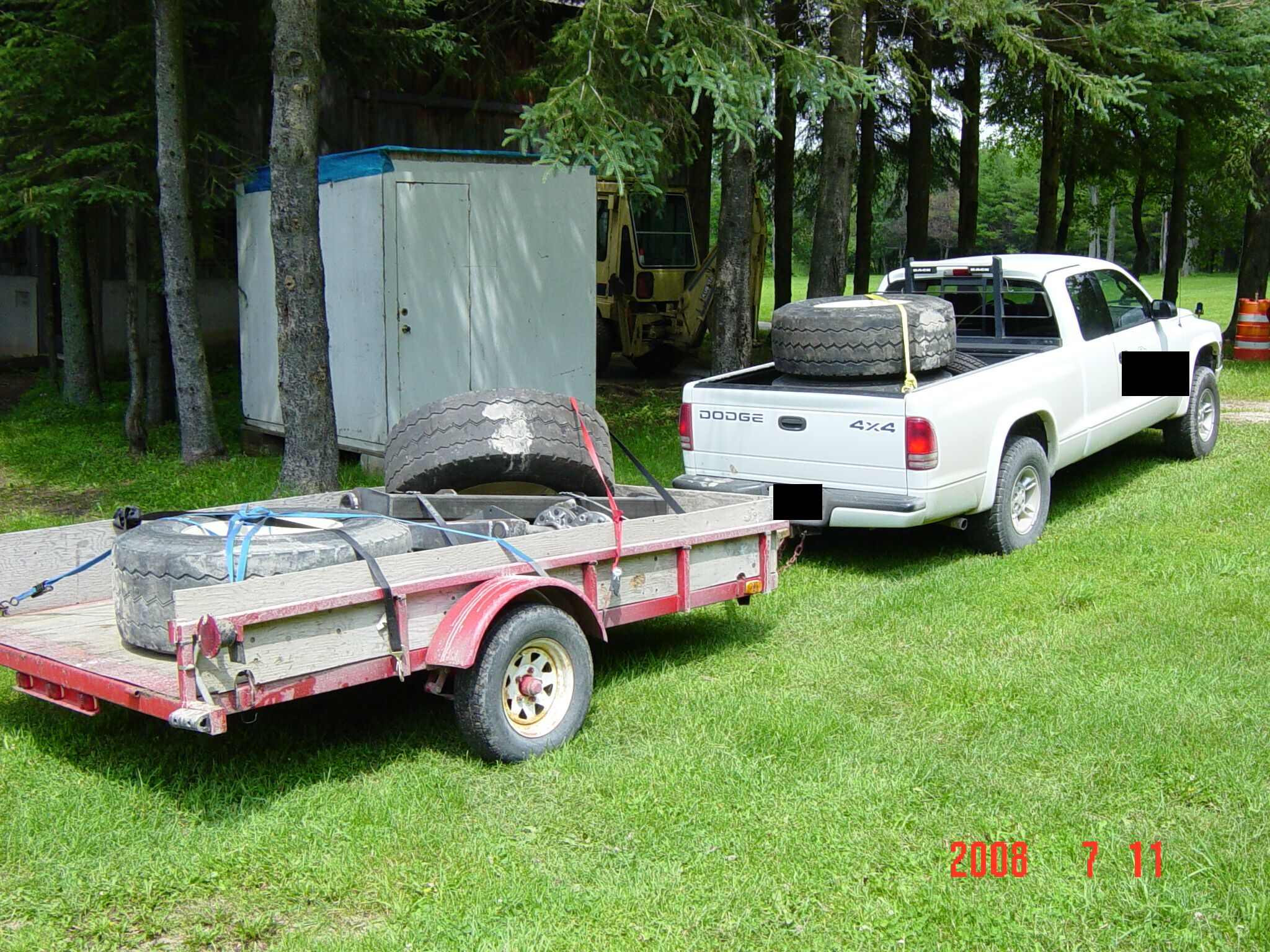

DSC01457B.jpg This is how I got my Horst Running Gear Home. As Johny Cash Would say "I went right to the factory, it's cheaper that way"
