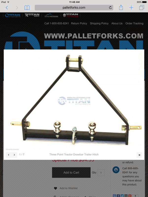

When pulling a heavy object with a rope or chain, such as a downed tree or whatever, what is the recommended attachment point on the tractor? Is it the hitch bar where I can install a ball or the 3.pt system? And if the 3.pt, how exactly would I rig it? Do I need one of those contraptions that attaches to the 3.pt? I know how to rig a rope or chain. I just want to do it the safest and easiest on the tractor. Thanks! And yes, I'm a rookie tractor owner. ;-). For reference sake, 2016 2555 HST.
/ Towing #2
Do I need one of those contraptions that attaches to the 3.pt?<<<<Yes, for one a 3 point draw bar will lift a tree butt off the ground so it can be pull in a safer/easier way, you make something or buy one.

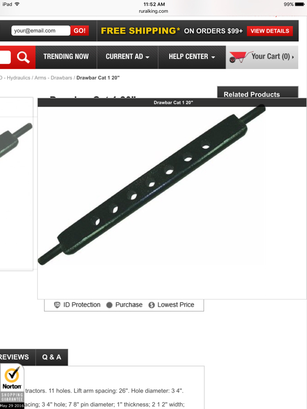

Use a fixed bar and a clevis. From experience I found you can bend things you don't want to bend pulling logs. Picture shows what I am talking about.

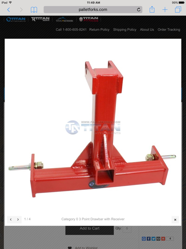

I also had a 3-point 2" hitch receiver fabricated and found I do not use it much. My thought was I would use it to move my RV trailers around the property but the FEL is faster for the small boat trailers and the heavier camper wants to push the tractor around too much.

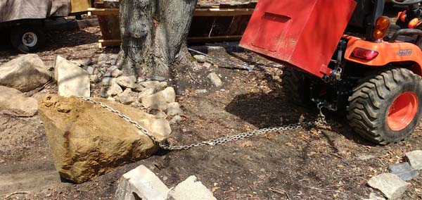

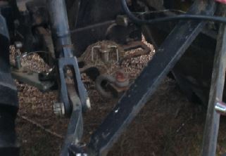

Your tractor does have hitch point on the rear axle below the PTO, between the 3-point arms. This in the point I connect a chain to when dragging big rocks, etc. It is lowest connect point on tractor and don't have to take ballast box off to drag.
Also have 3-point piece like your second picture for trailer moving.
/ Towing #9
I've happily used one like the second for years with ZERO issues.

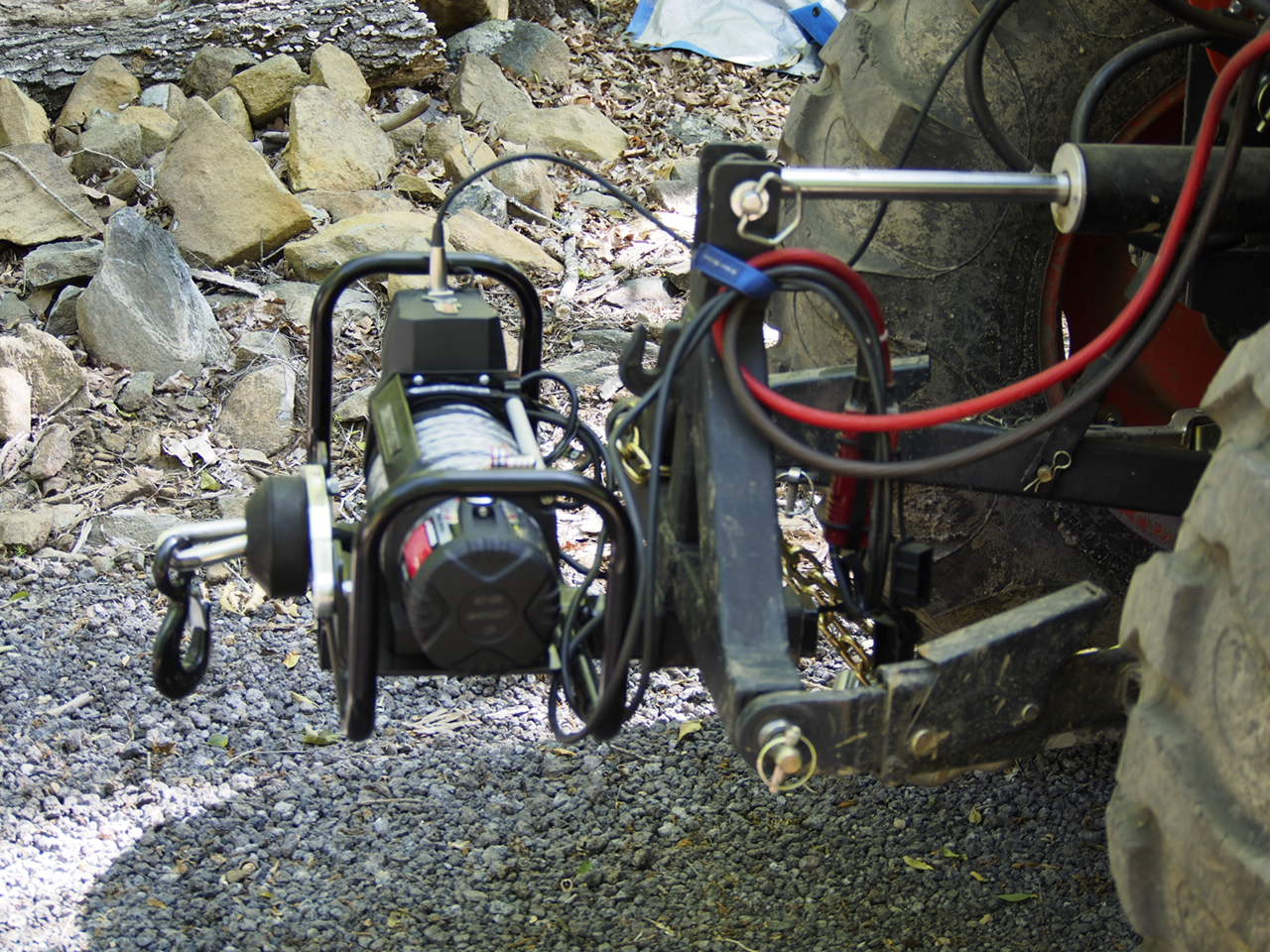

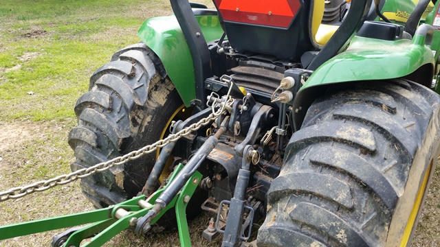

+ 1 as the generally preferred method and the method I use if possible. But if dragging something like a tree that may be prone to dig into the ground as it is being pulled, it is probably best to chain the log end to the 3PH in some manner and lift the end off the ground a small amount to keep it from digging in. The easiest way to do this for myself is to have a 3PH attachment with a chain grab hook. Simply wrap the chain around the end of the log, drop the chain into the grab hook on the 3PH attachment and lift the log end a small amount to keep it from digging in. One could also use the FEL but it is the rear of the tractor designed to pull things, not the front of the tractor.
This is what I use. Note the grab hook mounted ~ 1/3 down from the top of the top cylinder. A grab hook can easily be welded to many different types of 3PH attachments with the lower the mount the safer.

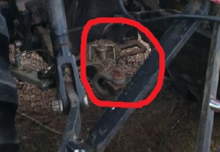

I encourage you to start with a fixed bar and clevis, it pulls better, it is safer, you can leave it attached and use when needed, it saves wear and tear on your 3-point hardware and it will set you back only $50.
I circled what we are talking about in the picture. The second picture shows the bend caused by using hooking the chain to the safety chain loops. I was pulling a 22"+ diameter 8' log out of a deep ditch when that happened, the damage looks minor but that plate is part of the structural connection of the drivetrain and not something you want to break. After that I started using the bar and clevis and found it easier to hookup and doesn't bind the chain.

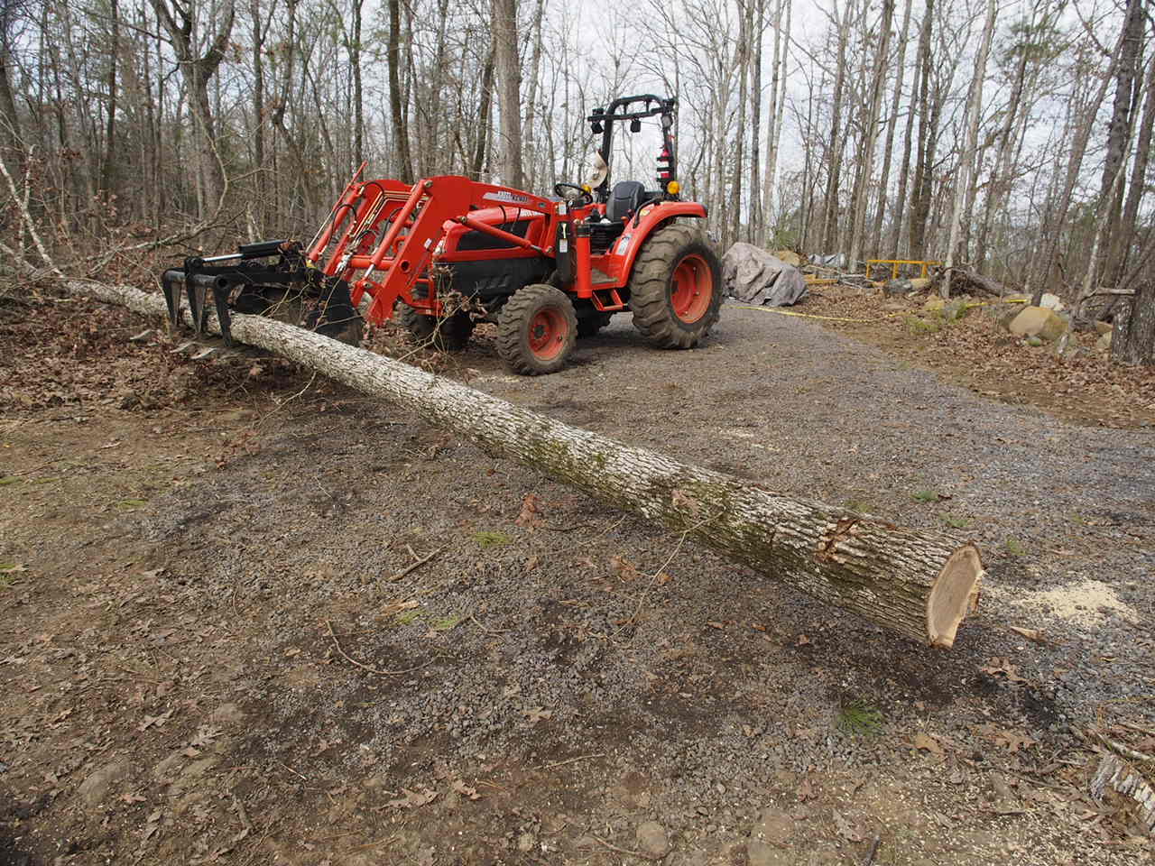

I should have posted all of my thoughts into a single post but it is kind of disjointed today. My actual preferred method of moving logs is to cut them into manageable lengths, depending upon terrain and weight and carry them with the grapple. BTW: the grapple is the second best logging tool I have, after the Husqvarna 562XP chainsaw and a winch the third best.
