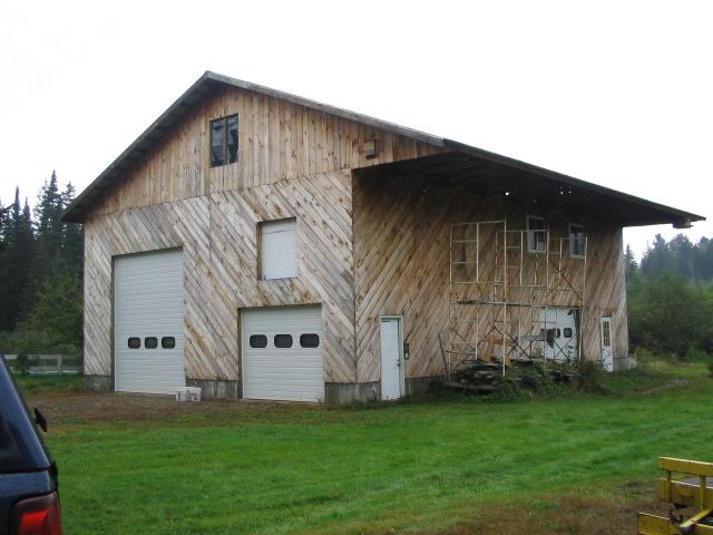

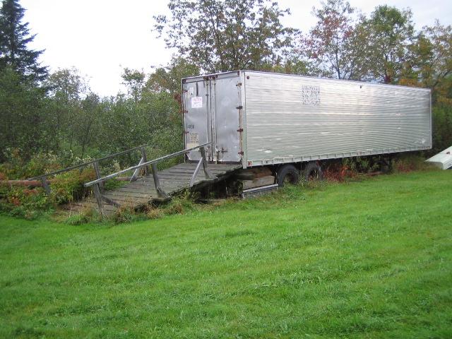

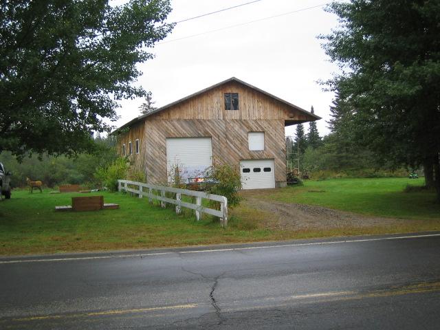

Borrowed a digital camera last weekend so am posting away!! Hope I'm not boring anyone. Took some of my "toyboxes".
Old toybox is self explanatory. New is 38X50 with plans to add another 30 in length. The offset roof is a result of the trusses being salvaged from a farm that had a feed bunk overhang and proximity to my leach field. Having a 10' overhang is handy for leaving things outside but under cover. Walls are 18' high from floor. Has a loft down one side. I have the extension trusses stacked close togeather on the walls at the rear of the barn, just have to spread onto new walls when built. Is on concrete foundation with dirt floors to date. Except for crane operator lifting the trusses I've done all this myself with occasional help from a couple of friends.

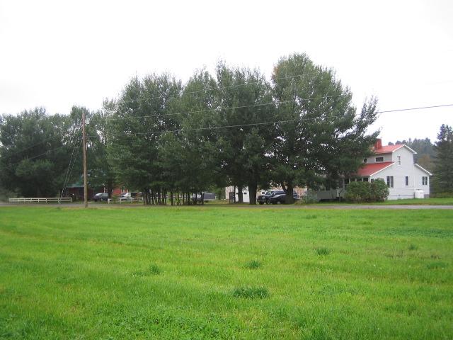

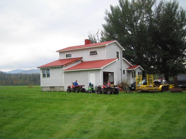

There's also a couple of pics of "camp", my retirement home

Nice job! How do you like the metal roof on your "camp". We have been looking at them. Our current roof collects all the soot from our woodburner and makes the shingles look horrible. Congrats on the new toy box too!

Will put metal roofs on everything I build going forward. The house part is heavily insulated. The porch & garage are not and are noisy in the rain. I like the noise but it can get quite loud. The neatest thing about a metal roof, besides it's long life & snow shedding ability, is that you can quickly & easily remove any panel for access or repair. Since my "attic" has no access point I've done this a couple of times, once to build the chimney & the second to run a wire.
