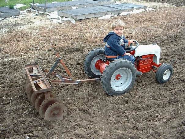

And it disc up the ground also!!!!!!!!!?
Did he really disc the ground? I am simply amazed! /forums/images/graemlins/shocked.gif

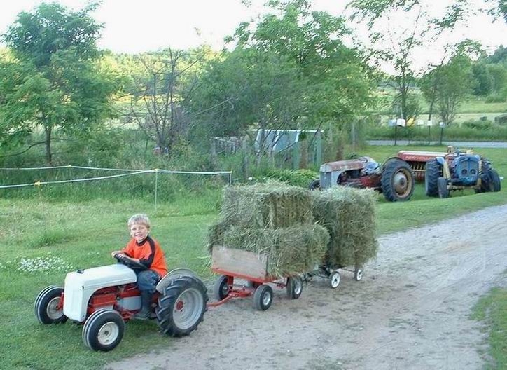

The machine will actually disc and pull things- 4 concrete blocks up a major hill.... The handicapscooter mech gets all the credit there!
I've toyed with the idea of making some more- commercially- by the time components are sourced, line set up, warranty, liability etc is it worth it?
I could make one or two a year in my spare time I guess- sell them as a one-off toy... or just make bodykits available- let people make their own mechanism.

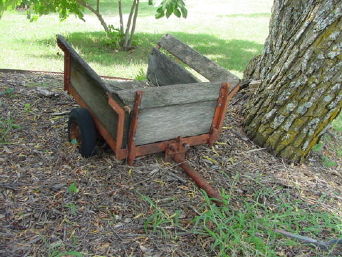

Here's the perfect trailer for the perfect toy tractor.
