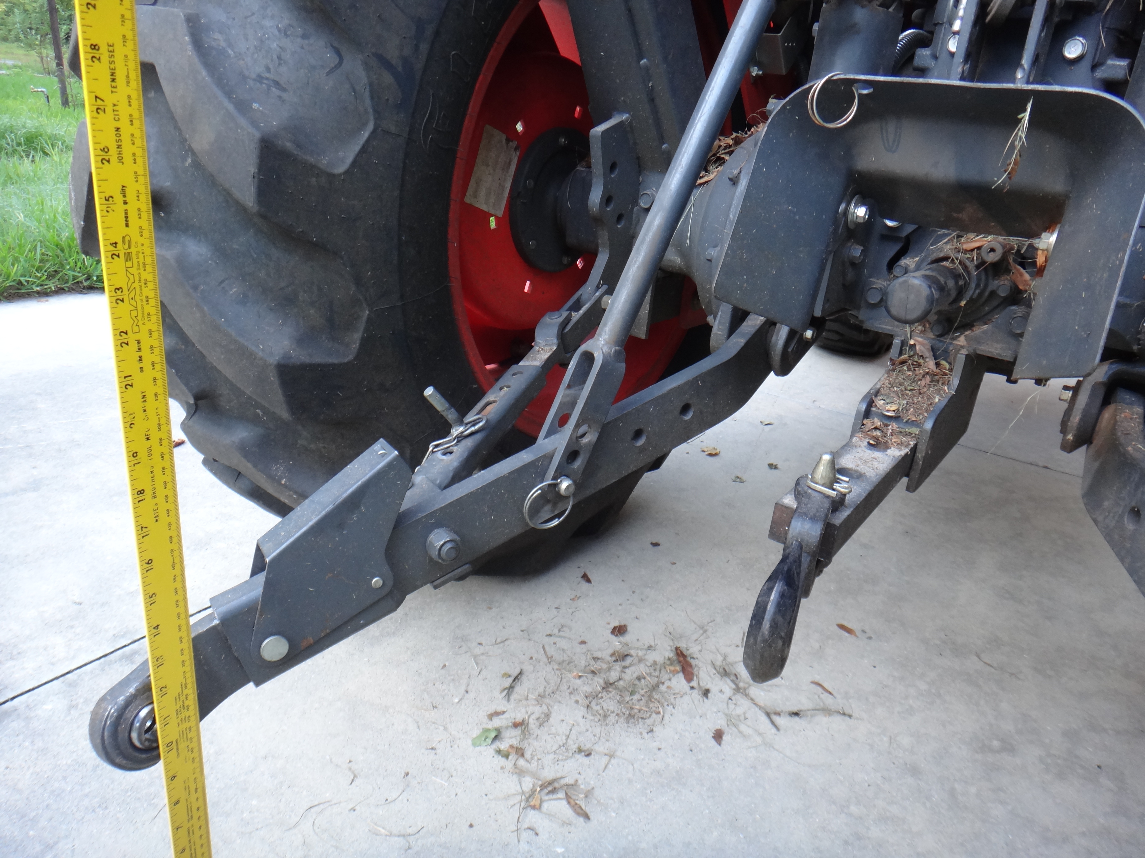

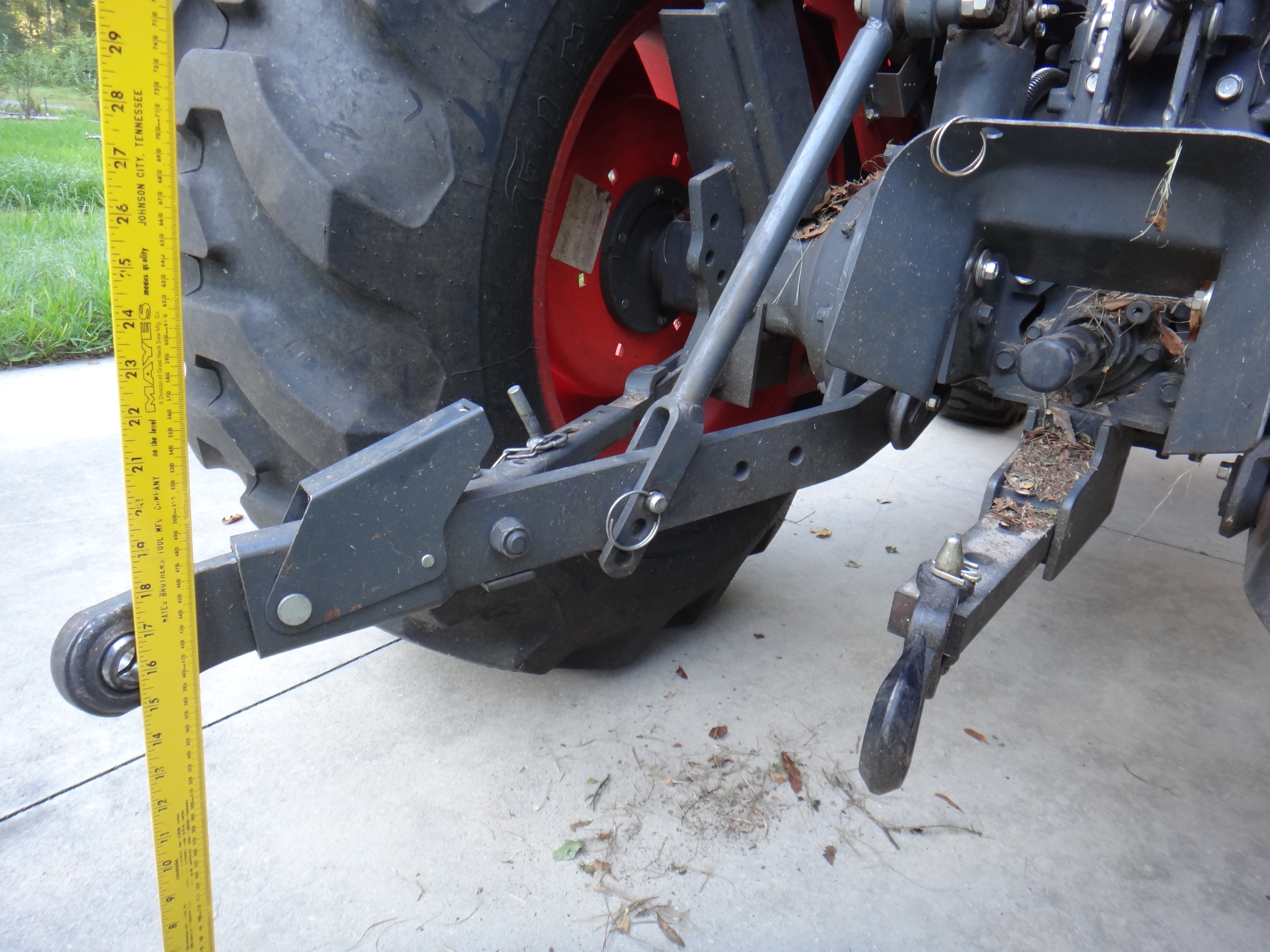

Other thoughts occur to me:
1) Into what pair of tractor holes is the INBOARD end of your Top Link pinned? Some compact tractors have three pairs of holes on the tractor, some compact tractors have four pairs of holes.
If Top Link is pinned into the LOWEST pair of holes, rake adjustments will change rapidly.
If Top Link is pinned into the HIGHEST pair of holes, TR3 Rake will remain almost parallel with the ground and Top Link will hardly affect forward and rear rake positions.
Your right and left Lifting Rods should have pin adjustments holes. Moving the pins to the higher holes will raise the point at which Lower Links begin to lift. HIGHER HOLES, HIGHER LIFT.
The highest Lifting Rod holes are the default pin holes. Sometimes Lifting Rods are pinned in lower holes, which would make TR3 Rake sit too low. As the TR3 front and rear rakes are positioned far to the rear of the tractor, this hitch adjustment will make a big difference.
See two PHOTOS.
