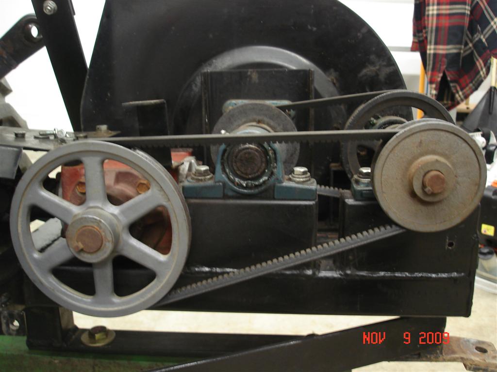

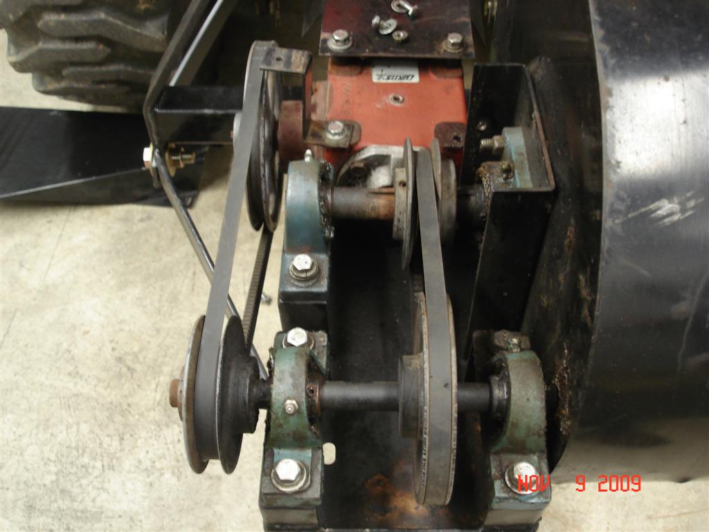

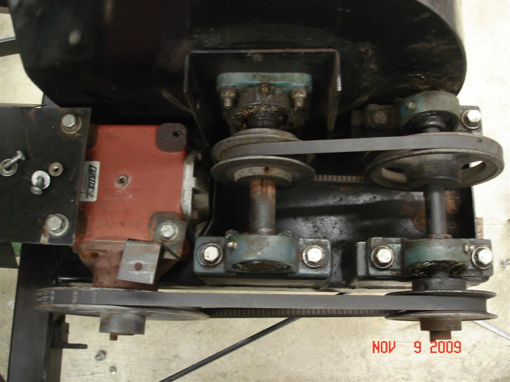

Here are some pictures Joe:
-The gearbox ratio is 1:2 (1 rev on the input side = 2 revs on the output)
-The Input vs Output ratio is about 1:7 (1 rev of the PTO shaft = about 7 revs of the shaft that drives the impeller.
You owe me dinner and a beer;)

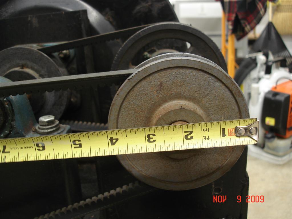

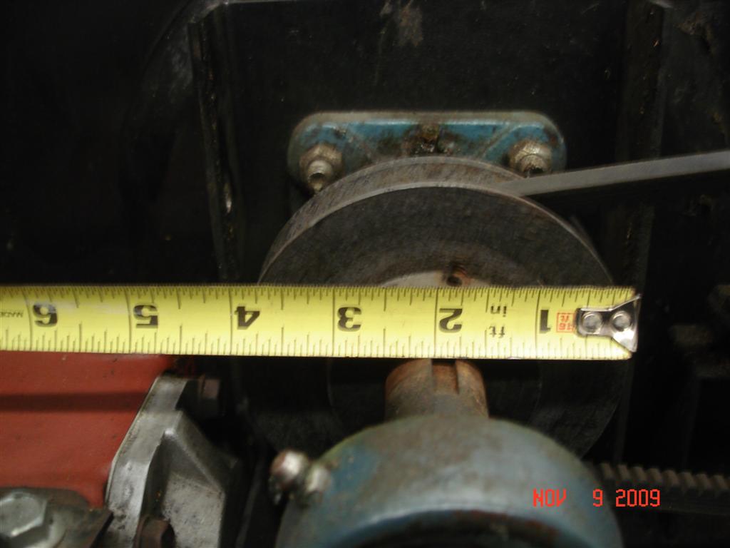

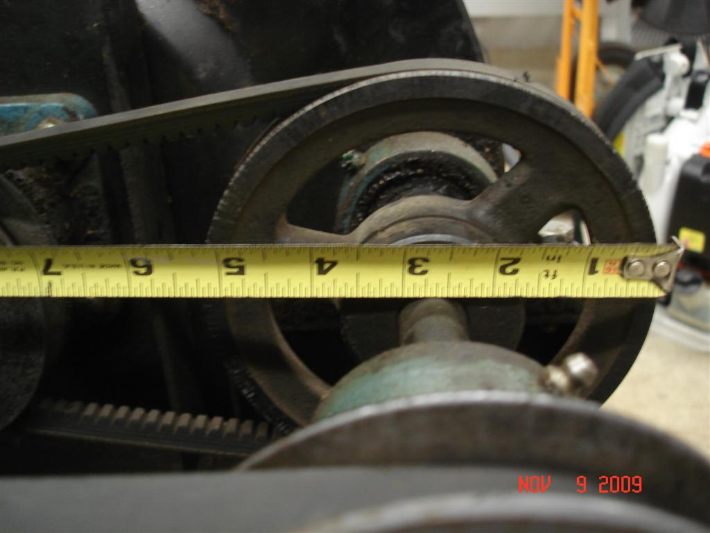

   / Trac-Vac 854 PTO Powered Leaf Vacuum #37
Thanks for the inside view. At 3800 rpm that impeller must make quite a howling sound. I never dreamed they would turn it that fast. Looks like I will need a 2 to 1 gearbox to keep things in perportion, otherwise my pulleys will be too large.
I got the approximate sizes for the pulleys off the pictures. Now to get a formula that will tell me if I'm in range.
I really like this arrangement. I think it will make a super vacuum and I only have to listen to one motor.
One more detail Kenny. How does the tractor handle it hosrsepower wise ? Is it quite a strain when you flip the pto button ?
Also, I just found the parts break down. It only lists two pulleys and one belt. It lists the jack shafts and pillow bearings..... wonder why they left this information out ? ( Or is it there and I can't find it ? ) They are careful not to give any sizes. The custom mower attachment might be interesting if it isn't too pricey.

The tractor handles it well, only bogged down once so far in thick wet leaves-but I was really trying to push it to see what it did.
I just knew you where going to mention pulley sizes...and that will be a steak dinner;)
