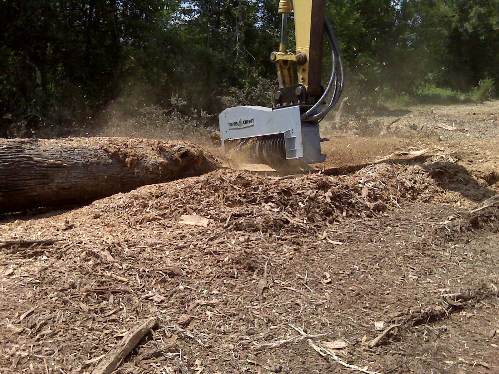

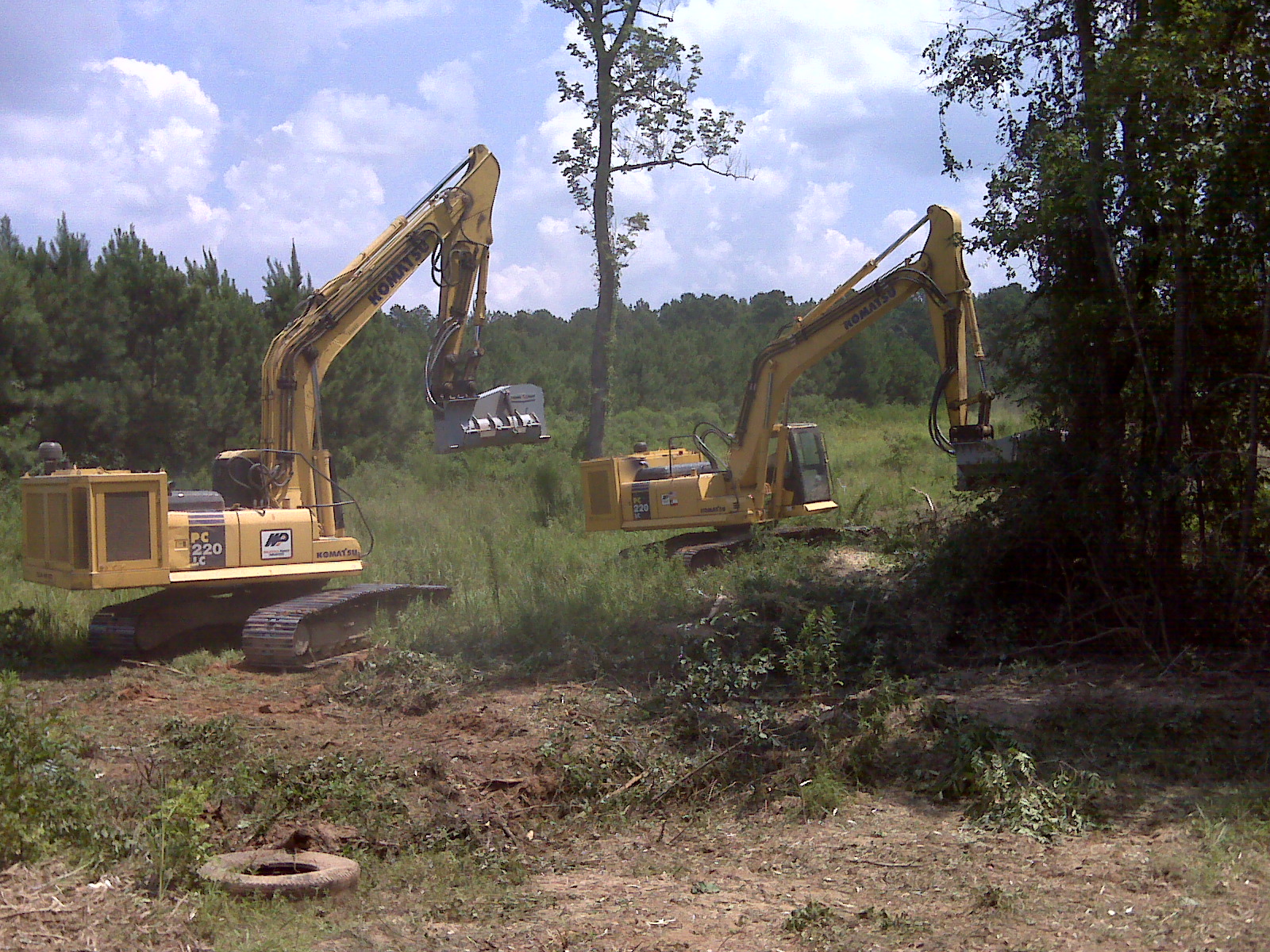

We are on the same page I was just giving you a hard time. Every job has it's requirements and I'm sure you've seen no one piece of equipement will to it all. With the work I have done with excavators they sure are a hard package to beat. We have to formally agree to disagree on with head to use thought.:D
And I have installs with powerpacks as well. They can be fun!! Welcome to the club..
