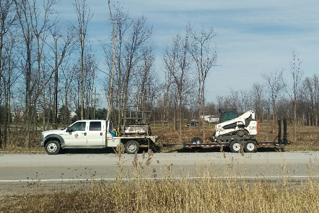

Last week I ran a Bobcat T770 for about 30 hrs, clearing some land. Found the machine to be pretty loud, visibility sucked. Had foot controls, which I'm not a fan of. I can run them well, and I don't mind the hand portion (like a zero turn)... But HATE using my feet for loader controls. Anyhow, this machine was bigger than I'd prefer anyhow (10,500). Overall felt ok, but was glad to turn it back in.

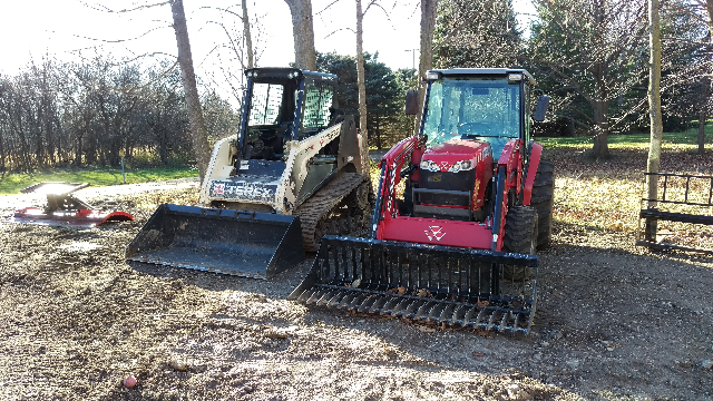

This week, I'm running a 2010 Terex PT70. (ASV SR70). Wow what a drastic difference in ride quality, comfort, visibility, and bucket controls. The pilot control was nice, but there's a little delay between forward and backward movements, which I'm assuming is normal. I wish it was an immediate direction change when I move the lever, but I've ran it so far for about 10 hours and I'm liking it. Hydraulics feel strong and the machine feels very balanced as a whole, only weighs 7800'lbs too.
Now I know that it has the both "heralded and dreaded" ASV undercarriage... However it does have newer tracks and the drive sprocket components (squirrel cage) and a couple random bogies have been changed recently). It looks like I could probably get another 100-300 hrs out of most of the bogies, then start replacing them as needed. Machine has 1900'ish hours, but the 71 HP Perkins runs very smooth and quiet, and it's pretty clean overall. I can buy it for a pretty fair price if I want, so I'm debating... My uses are mostly grading and moving dirt around, and from what folks seem to report, that's the best environment for the ASV undercarriage components.

The T770

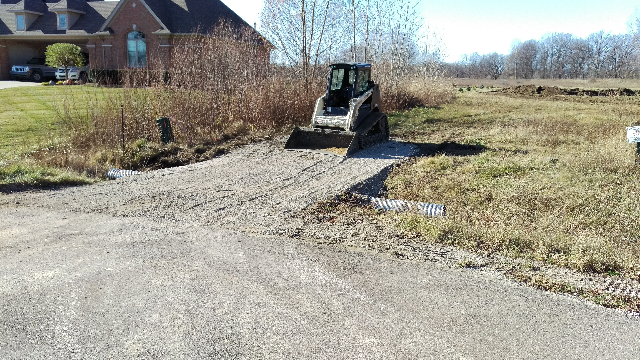

Did a nice job setting the driveway

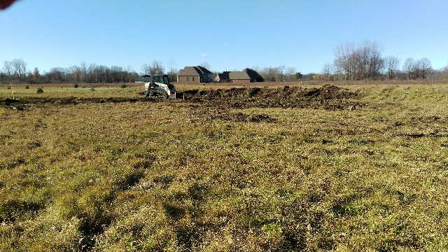

Moving dirt
Next to the Massey
