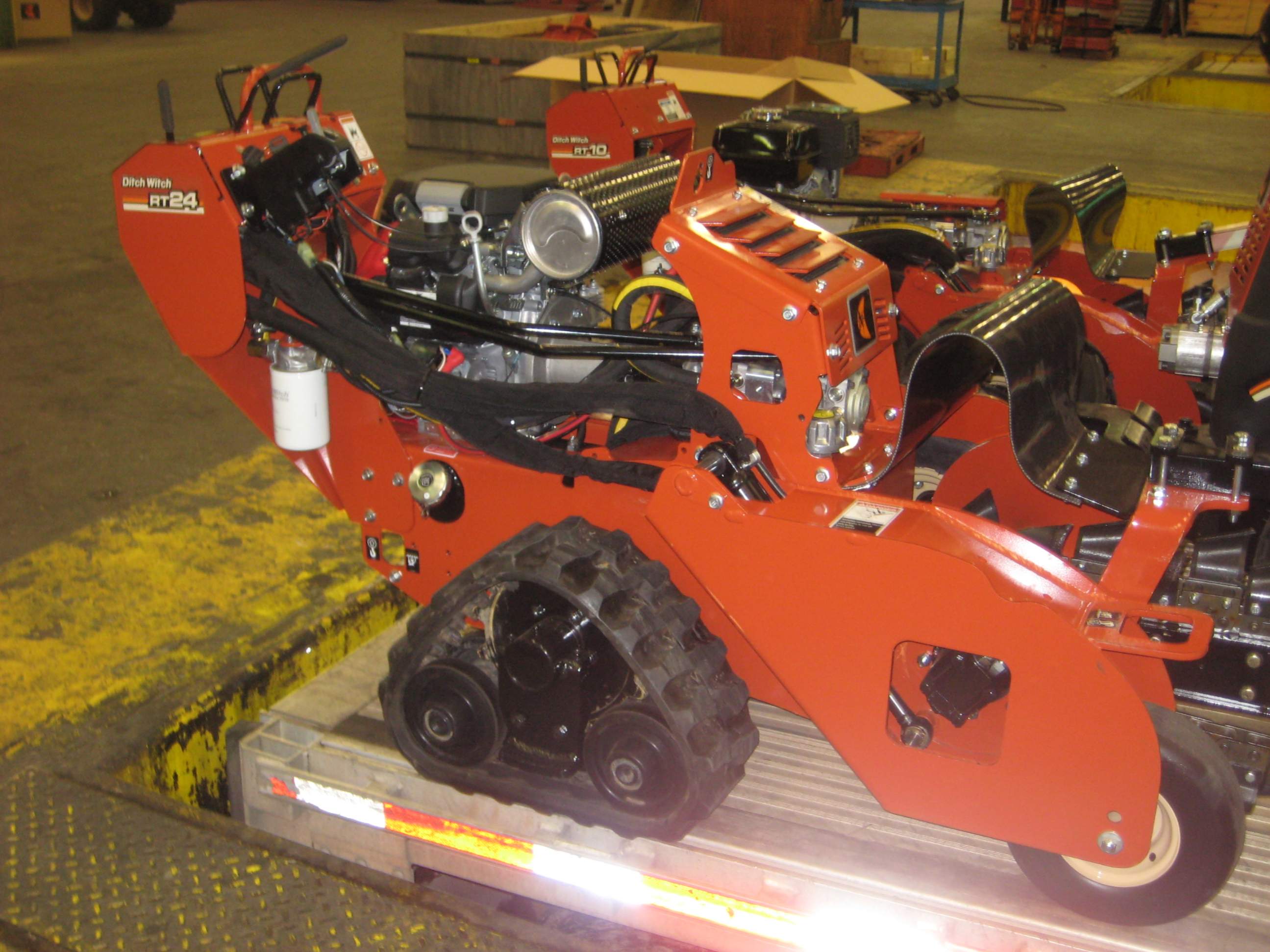

I have a company that does lots of small trenching jobs and we have several trenchers but looking to find one that will work better? I seen a ditch witch rt24 new model that is on tracks, but it then dealer was telling me why it was better than old we have 1820 ditch witch and how its as good as the Toro. Well I didn't even know that Toro built one till he brought it up.
Has anyone used the toro? its a TRX26. Its all track no trailing wheel and all hydraulic just like the ditch witch and parts seem 1/3 price of ditchwitch. I price chains and teeth and hydraulic motors. This will get daily use so I don't want junk but didn't know if anyone has used or owned a Toro or anyother brand of walkbehind?

Toro, no. Ditch witch yes. The track units are nice, but have you looked at or tried one of the ditch witch Zahn units? they're articulated do all power units and you really can trench a tight circle with them. My local rental place had one we used and I was impressed with it. For our older ditch witch, I get wear parts from ballantine.

We demoed a Zahn and the problem I had with it was it would not stay in a straight line as we dig footings and want perfect straight and it was a pain loading on trailer with ramps. I still have not decided, but Toro is bringing one out to play with this week.
