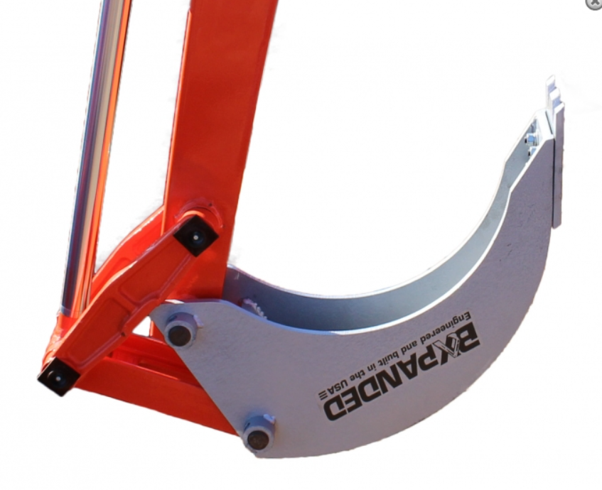

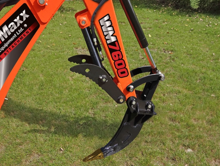

I've had good luck digging in tough ground by using a ripper tooth:
I first make a pass digging what I can with an 8" bucket. I make another with the ripper and a third with the 8" bucket to clean the trench.

I've been looking at making a knife edge ripper at least 2' long to pull through the ground something like 1" pipe without digging similar to those with a vibrator. Just wondering if you have tried something like that and how it worked. Lawn sprinkler companies use the vibrating ones. To cut roots I would need a knife edge to cut them.
