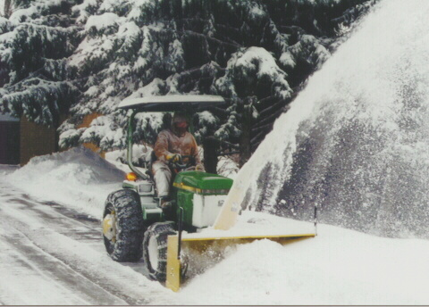

There is an alternative tire chain that you may want to consider. The crossbars are made of rubber and the side links are made of regular chain. The rubber does not damage paved driveways. See attached photo where I have tham on both front and rear of a 955.
These Traction Aids (as they are called) are made by Hemler Manufacturing of Lancaster, PA. I ordered mine through Dave Anderson of Deer Creek Equipment, Oxford, PA. (800-255-6567).
I also had the maximum amount of cast rear wheel weight on the 955 as you can see. No problem with traction at all and no scuffing of the asphalt.

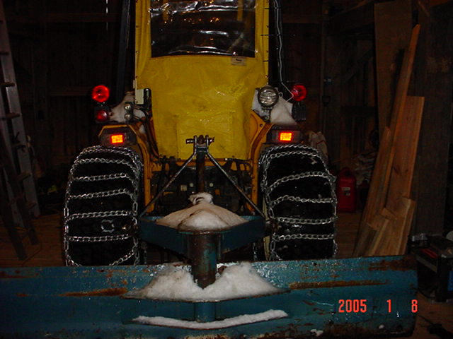

Put a set of these on and you will have tons of traction.
