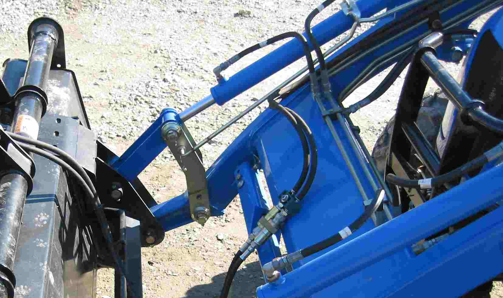

   / Tractor advice needed #13
With respect to your question on remotes, they put one set of remotes on the back of my tractor and threaded a line up to the front so I can attach a graple and if I need to use them for something in the back, I just disconnect line.
