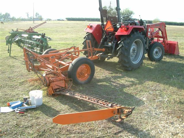

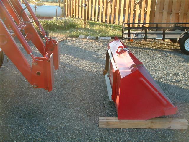

For 120 acres, I'd consider something like my 2008 Mahindra 5525 (54 hp engine, 45 hp pto, 2WD, gear tranny 8F/2R, power steering, triple hydraulic rear remotes) with the ML250 front end loader (FEL, 6-ft wide bucket, 3 chain hooks welded to the top of the bucket, skid steer quick attach option on the FEL arms to quickly change front end implements). Cost new was about $19K. You could probably get one used for half this amount.
5525 MF124.JPGAC 80T--2.JPG5525 SSQA.JPGRemotes 5525-1.JPG[/ATTACH]
The 5525 is a basic, heavy large utility tractor that could handle your jobs.
There are similar tractors from other manufacturers that you might consider.
