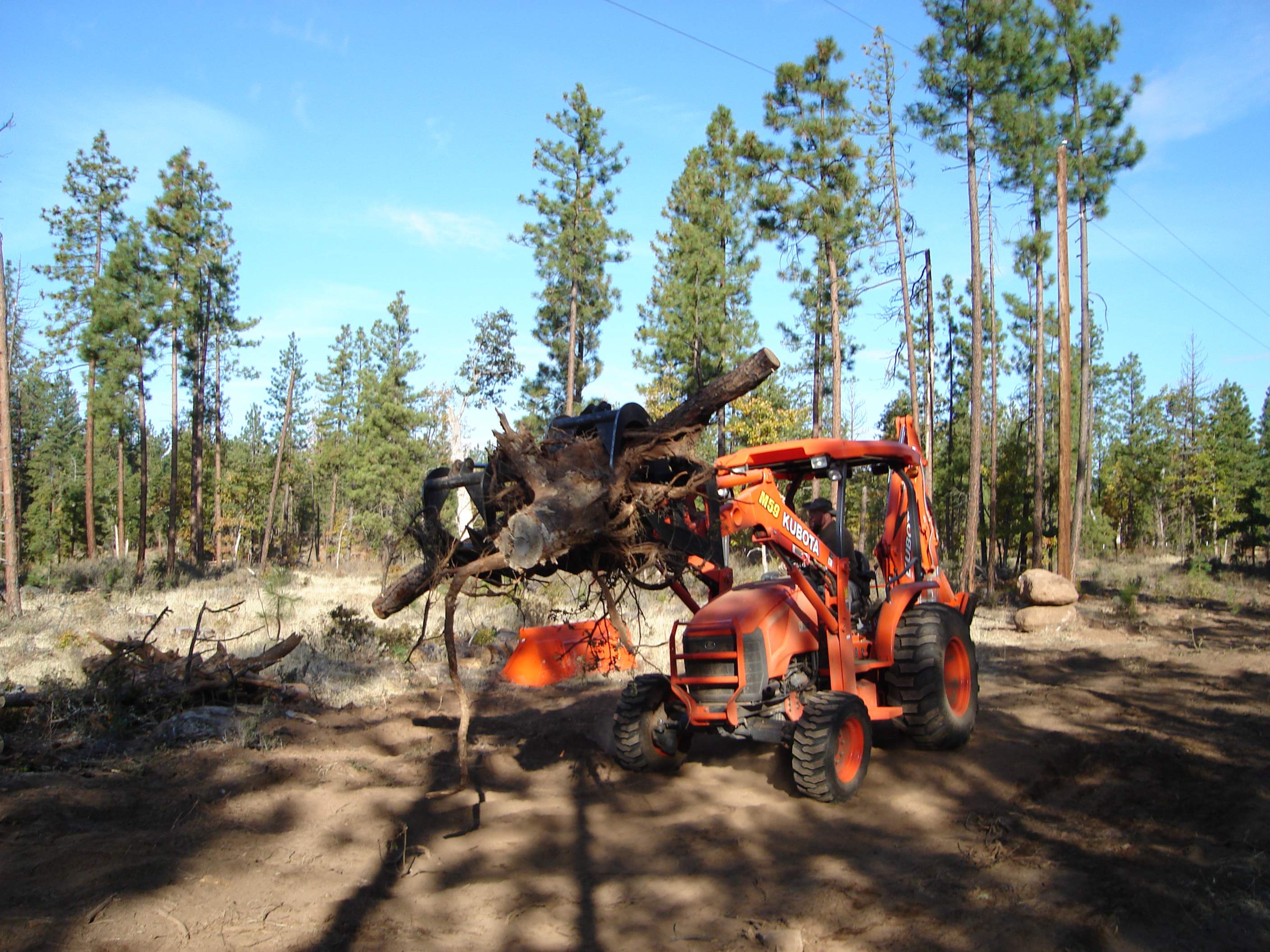

I chose a compact with a tight turning radius so I could sneak between the trees without having to clear a path. Under 7,000 lbs so I wouldnt tear up the ground or need a big truck to pull it.
It was a tight race between a JD 110 or the L48 Kubota, both TLBs. The deciding factor for me was the rough terrain I work. Look underneith the tractors, do you see massive hunks of steel or all kinds of delicates to get smashed or snagged. I ended up with the Kubota M59 for that reason and all the user friendly details, auxillary hydraulics, and backhoe thumb. Also at 6'2" there was more room on the Kubota to get into backhoe position.
