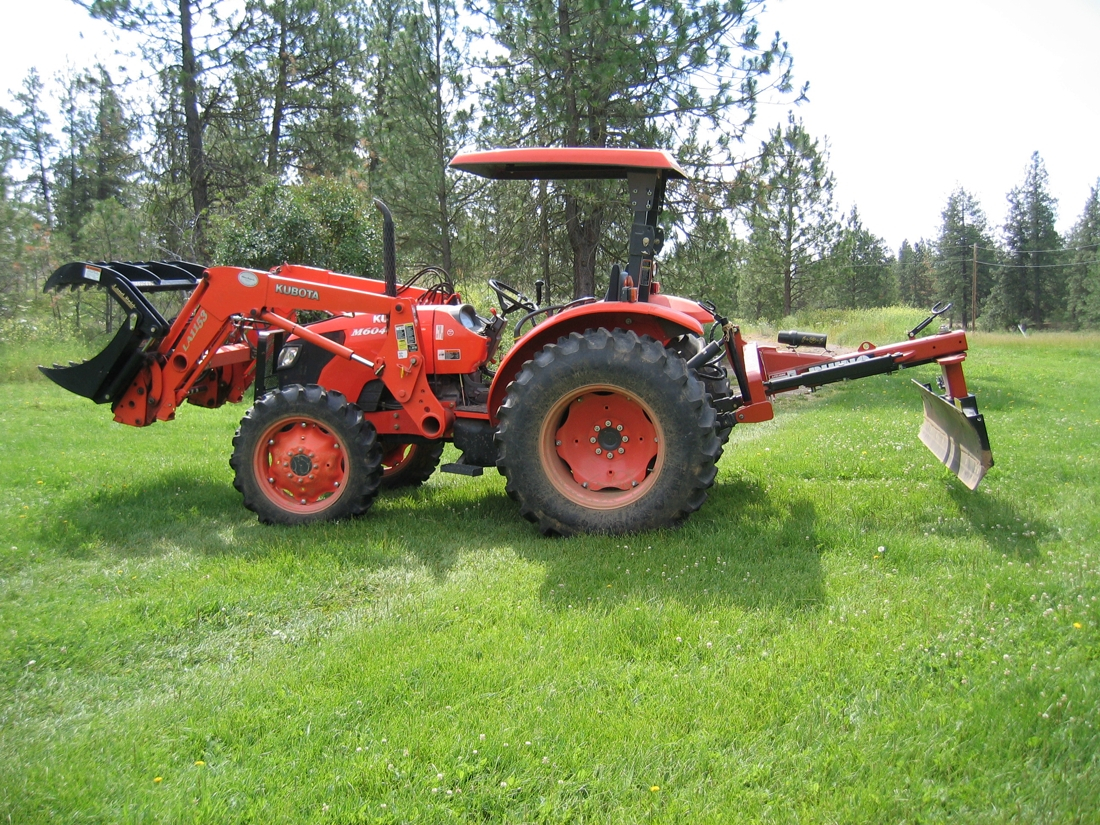

I have 80 acres - mile long gravel driveway - winter snow. I have a Kubota M6040 - 4WD. Several implements plus very HD grapple and rear blade. For 27 years I had a Ford 1700 4WD. Took all that time to get the smaller projects completed. Now I'm into the bigger projects.
I doubt there is ever the perfect tractor. At times I wish for bigger and some times smaller.
I bought the M6040 - brand new in 2009. It's been a real work horse here on my 80. Never a moments problem either.

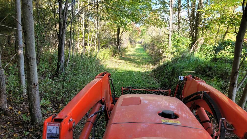

The only time I've wished my MX6000 was bigger is when pushing over the occasional tree. Some species are easier than others, though I can generally push up to 10" with the MX.
But...not to pick the scab off the gear vs HST debate - - - for me personally, I wouldn't trade the frame/weight balance of the MX or the day to day functionality of the HST when mowing, doing grapple and loader work or snow plowing for a bigger frame tractor.
It works great for creating and maintaining woods trails.
And mowing for the "livestock" to graze.View attachment 734607View attachment 734609
