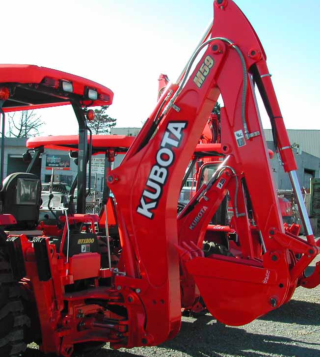

That's true, but I think 3 mm is not strong enough...reach of the backhoe from
swing point to the tip of the bucket teeth will be 5.5 m, that's 18 feet...
It has to be stronger or it could bend. Main boom cylinder develops a force of 20.72 tonnes at 200 bar of
pressure. I can't go under 6 & 10 mm plates...
18 feet?! That's beyond even BT1200 territory (M59 photo). I will bet that the boom section in the photo,
where the big 'KUBOTA' logo is, has plate thickness of no more than 3/16"....
   / Tractor backhoe - homemade #114
Thats 4.7mm. If its Domex 700 or Naxtra 70 or any other high strength steel, you need double the thickness in S355, or triple the thickness in standard construction steel S235...
...However... I doubt they make backhoes like these out of Domex because the filled welding wire required to weld these steels at strength, increase the cost of a tractor backhoe too much. Perhaps full size excavators have Domex booms..
Bfreaky, have you done strength calculations, or just the cylinder force ? Calculating the moment of inertia of the beam, and compare that with the cylinder force, it would make it pretty easy to tell if these booms are made of St.52.3 or Domex 700 or even Xabo 1100 (which is so exotic that its only used for high end telescopic cranes)
